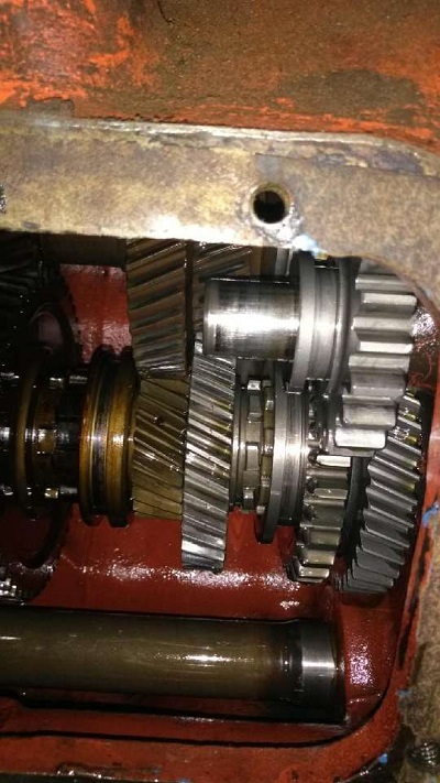

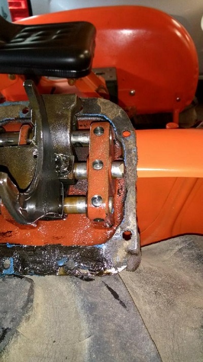

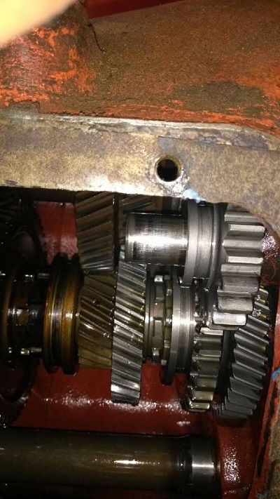

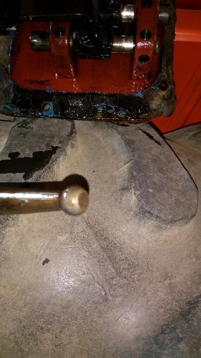

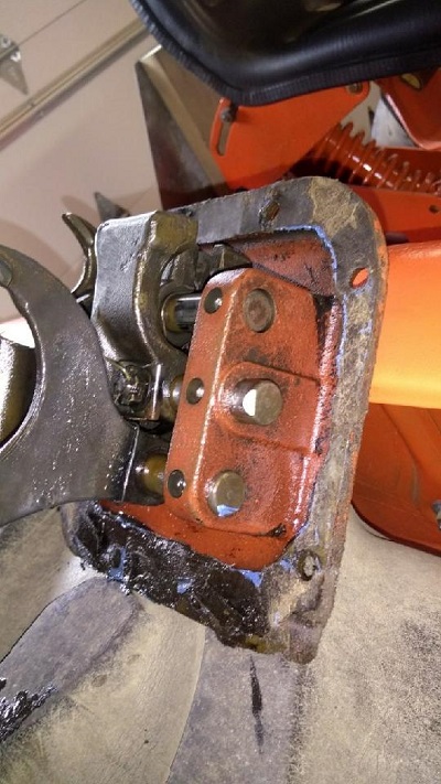

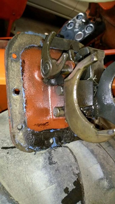

Have the shifter and side plate off . Took some pics that my fav son should post soon . THANKS !!

ACinSC
Great pics
Getting the Tractor in Neutral
Can you line up the Notches on the top of the shifting mechanism you just removed - so they form a perfect rectangle or row perpendicular to the centre line of the tractor. This Notch Row would be where the shifter ball sits, right in the middle.  In Neutral, the Operator can move the shifter, perfectly right or left, and the shifter ball moves sideways in the Notch Row (and none of the Notches should move)
The fork associated with each Notch assembly, should move a gear, or gears, forwards or backwards.  One Notch at a time is displaced by the shifter ball, when the Operator selects a gear, and then deselects.
You can see how critical it is to have the Shifter in the correct position, so it ONLY CONTACTS ONE NOTCH AT A TIME.
Also try and determine if your shifter ball has much play as it moves thru the gears, how much contact it is making with the notches
I played around with mine once I figured out how it functioned, placed the side plate back in the tractor (no oil yet) with the Notches/forks/gears in the Neutral position.
Look down the shifter hole from the Operators position to ensure still in Neutral, and try rolling the tractor to ensure no gears are engaging.  Then drop the shifter into its position and try shifting gears (without the tractor engine running).
You should be able to tell if the shifting and gear engagement is working properly or not.
Once you are happy with how it feels, you can tighten up the side plate, start the tractor, and go thru the gears again with power this time.  Moving the tractor a foot or so is all that is needed. Then you can replace the transmission oil
This is how I stick handled (Canadian hockey term) thru my "Shifter Problem" situation
I do not have any other advice from my experience regarding the gears, wear on the forks etc.
Hope this helps you with your project.

Thanks Robert ! Did you replace the pins ? My shifter ball has a small flat spot . Doesn't look bad to me , but what do I know ? I'll get back out there tomorrow . Thanks again !!
Points: 22818
Post Options Post Options   Thanks (0) Thanks(0)   Quote DrAllis Quote  Post ReplyReply Direct Link To This Post Posted: 02 Jun 2021 at 7:36pm
The picture of the transmission gears shows that it is in SECOND gear and REVERSE gear at the same time. Your description isn't very clear " won't move" should have probably said " it kills the engine if I try to make it move".  How in Sam Hill it broke sitting in the shed, I'll never understand. I've never had to rebuild any of the shifter mechanism on any D-14-15, so I don't understand how it got out of synch just sitting in the shed.
ACinSC View Drop Down
Joined: 16 Dec 2015
Location: South Carolina
Points: 3252
Post Options Post Options   Thanks (0) Thanks(0)   Quote ACinSC Quote  Post ReplyReply Direct Link To This Post Posted: 02 Jun 2021 at 8:25pm
Yeah Doc , it's dies when I try to back up . I don't know what happened either . Bad mo jo maybe . I'd very much like to fix it so it doesn't happen again . Thanks !
Points: 22818
Post Options Post Options   Thanks (0) Thanks(0)   Quote DrAllis Quote  Post ReplyReply Direct Link To This Post Posted: 02 Jun 2021 at 8:40pm
Well, at some time in past history, someone has had the shift cover off. The blue RTV is the dead give-away.

Yeah I've seen that blue silicone elsewhere . Thanks again

I did not replace the pins, only the shifter.  The replacement shifter ball had more bulk than the old shifter, and that seemed to be enough to make the difference with keeping the ball tight/firm with the Notch.  Also the Notches were well worn from many years of being rubbed by the shifter.
Your ball looks good, but the flat spot might be an issue. I remember seeing specs quoted on the required size of the ball for a good snug fit.  I was surprised how much a difference a slightly larger ball would make. In some of the examples quoted in the Forum, the guys who built up the size of the ball welded/ground smooth/dropped shifter into position/tried shifting/made minor corrections/repeated the exercise until they were comfortable with the fit
You are in a good position to check your Shifter "snugness" as you shift thru the gears
One other point I forgot to mention that was passed on to me by my old AC Dealer Mechanic friend......when shifting, place slight downward pressure on the shifter using the palm of your hand, as you move it to the desired gear position.  Also, follow the shift pattern very carefully to ensure the best alignment with the ball and the desired Notch
Good luck with your project

Oh well , that didn't work . Gonna pull the fender so I'll have more room to maybe see what's going on . THANKS !

I was reading this thread info over and figured we had not specifically checked off an important item....
Something that needs to be followed up.........Dr Allis comments above, re second gear and reverse gear engaged at same time.....that needs to be corrected
Perhaps you have already, if not..........
When I compare your pic to the one in the Yesterday Tractor D15 thread (previous note) there are some differences in positions of the gears.  I am assuming the D15 thread pic shows the transmission in Neutral (maybe not), but your pic gear alignment is not in Neutral (according to Dr Allis)
Key message,,,,,,,,,,gears need to be in Neutral position before you re-install the side plate/forks which should also be in the Neutral position
You can verify all gears are in the Neutral position by rocking the tractor by hand and/or cranking the engine (not starting) a bit
When I performed my D15 adjustments/upgrades I had to move the gears a bit to ensure alignment with the forks as I was reinstalling the side plate
Good luck with your inspection/re install

More good info Robert . Maybe I can figure something out ? Sure not going to be an easy fix . I'm very thankful for your help .

You have to slide all the gears into neutral..
You have to put the side plate and forks in the neutral position.
You wiggle the plate and try to align the forks as you slide it together. Yes, it takes some time and some wiggle... You have to have all gears in neutral before you start.
When you THINK, you have it together, put in 1-2 bolts and snug them up.. try shifting.

THANKS Steve and Robert ! Anyone have a pic of the gears when the trans is in neutral , or a description ? I've pushed on the side plate notches a little , but they haven't moved . Are they hard to align by hand ? THANKS !!
Points: 90816
Post Options Post Options   Thanks (0) Thanks(0)   Quote steve(ill) Quote  Post ReplyReply Direct Link To This Post Posted: 04 Jun 2021 at 12:36pm
the side plate has 3 shafts that the forks mount to..  you can see a PLUG where the shaft goes thru each bushing.. I think there is a ball and spring DETENT at that position.  PUSH on the end of each shaft, or bump with a hammer and  you should see the shaft jump to the next detent positon... You may be able to see a NOTCH in one of the shafts where the detent  sets when the shaft is moved.
you should be able to use your SHIFT KNOB position to see the forks are in neutral... then look at the forks and measure between them and position the GEARS back and forth  ( put them in neutral) so they will align with the forks.
Edited by steve(ill) - 04 Jun 2021 at 12:48pm
Points: 90816
Post Options Post Options   Thanks (0) Thanks(0)   Quote steve(ill) Quote  Post ReplyReply Direct Link To This Post Posted: 04 Jun 2021 at 12:45pm

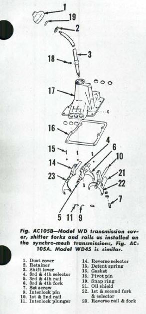

I dont have a D15 manual handy.. Here is a WD shift plate and forks.. you can see the SPRINGS and BALLS that are the detents.. Thats why the shafts appear to be "stuck"..
