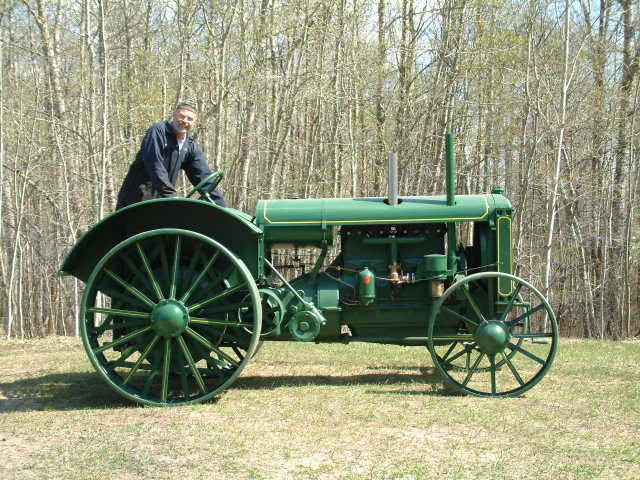

'29 20-35 had a Kingston L3 carb and an Eiseman GS4 magneto. This mag has automatic advance and no manual advance/retard control, as did the previous years using a GV4 magneto.  I have a '29 20-35 and a '28 20-35.  I have been running the Eisemann mags for 20 years now and have had no problems with reliability.
The 25-40 may have also used the Kingston carb, but most I've seen have the Zenith 6CEV carb.
