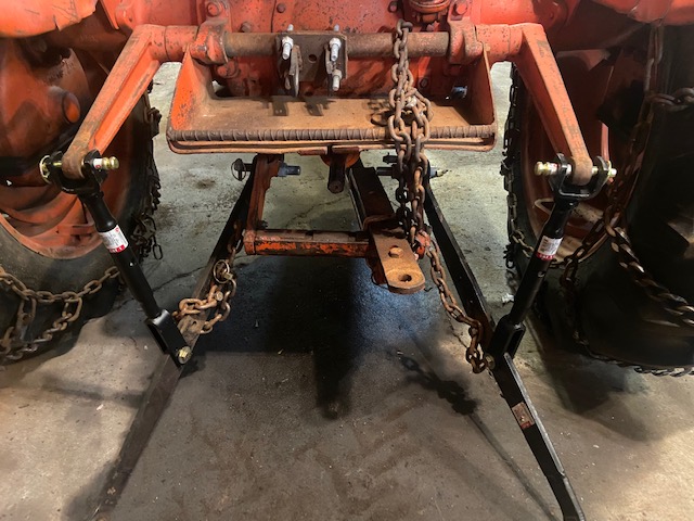

This is the setup I have on my WD for running my 6 foot snowblower and 3 point disc. Works good. Built it out of generic parts from Tractor Supply. (Ignore the big chain, that's just my pull stuff out chain that was hanging there).
