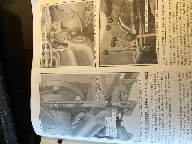

Post Options Post Options   Thanks (0) Thanks(0)   Quote Oldwrench Quote  Post ReplyReply Direct Link To This Post Posted: 21 Apr 2021 at 10:06am
$375 is a bargain compared to the aftermarket hitches, and there is no comparison in quality or utility since the factory 3ph integrates into all the controls.  Here is a page from the user manual showing the position control and draft control linkages.  Except for the connecting rods that I had to fabricate since they were missing on the salvage unit I got, the basic linkages are the same for the SC and 3PH.  You shouldn't run into any major problems on the switchover.
