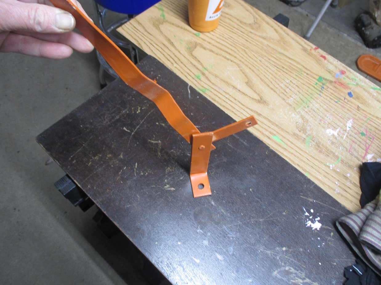

Several years ago I had repainted this part. But now putting tractor back together, I can't recall what it was for, or where it was mounted. Tractor did have corn picker on it at one time.
  Thanks Tim

Could be a home-made release for snap coupler.            MACK
Post Options Post Options   Thanks (0) Thanks(0)   Quote shameless dude Quote  Post ReplyReply Direct Link To This Post Posted: 13 Jan 2021 at 10:32pm
brake lock trelease?

well, I don't believe it to be a stock/standard/original part, but I would go with Mack on this, it does look similar to the original snap coupler release

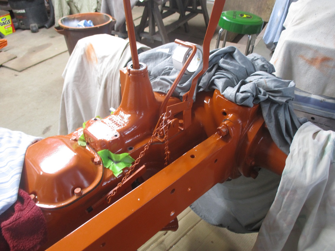

After looking at the lever I realized it would have to be mounted on the snap coupler release lever side. So I placed the lever over the next bolt, and it places the lift arm right over the foot clutch lock out lever. Then it hit me, I took the chain off that lever a bit ago thinking why would I want that on there. LOL  If that hand lever is home made there good.

I would agree its not any factory part I have seen.

Tim, I agree with Mack, SC release lever. That's different than what I've ever seen for SC release.This is the only style I've ever seen.

this is the snapcoupler release lever on my CA that is similar!

So I had a chance to mock up that lever today. I found it only fit in the bolt hole behind snap coupler lever. The position its in now, would disengage the foot clutch. When I pull the hand lever back, the lockout lever flips right up and over. Wants to chip new paint, and then hand lever goes ahead and down. Probably chip more new paint and rattle. Previous owner asked if I wanted the front mount buzz saw they used a lot with it. Nope, maybe that's why they rigged that lever up. So in the end I took it all back off, not going to use it.

Looking really good. Now I see about this homemade lever and its function. It is hard to work that clutch lock and this was a way to do it easier.

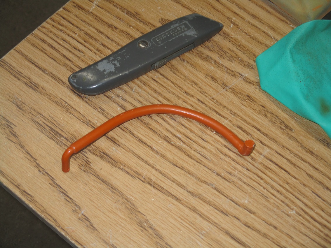

I have another piece I painted some time ago, and can't figure where it goes. Note the ends are different sizes.
  Thanks Tim
