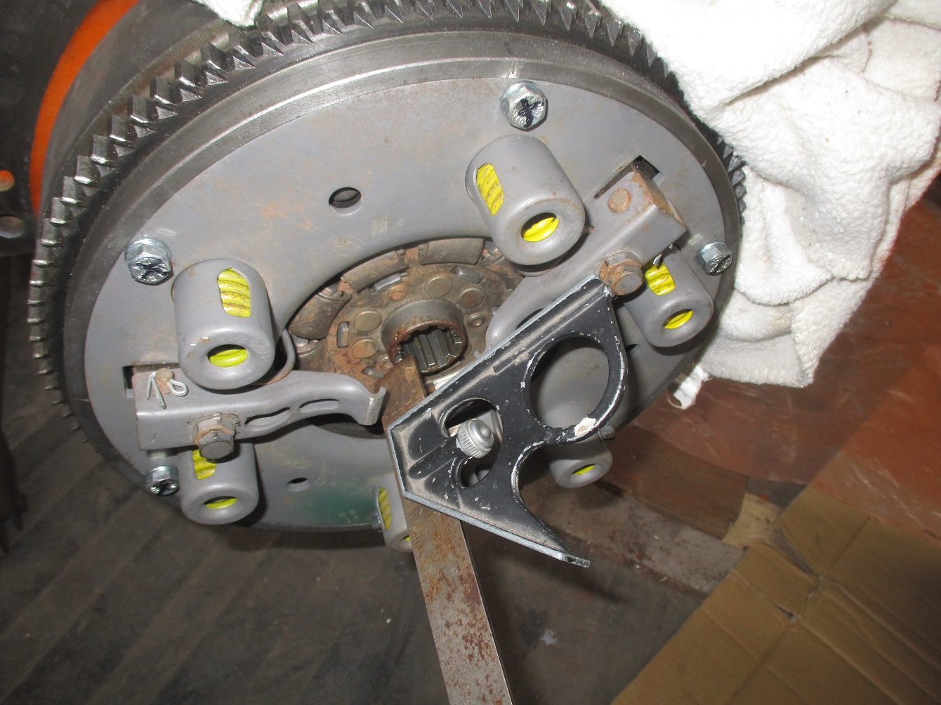

This sure seems to be the way to adjust fingers to 1 5/16". But am I right.
   Tim

Might be just the picture, but it sure looks like the yellow springs are collapsed ??

No the springs fine, must be camera. Will this method of checking adjustment work.

Good place to start. Easily done or corrected in chassis by removing cover plate from bottom of bellhousing.
