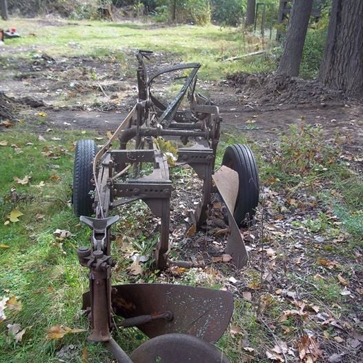

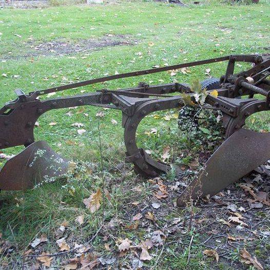

So, picking this up for $75 tomorrow
Started out life as a 3, but as you can see it only has 2. And the $75 price makes it a no-brainer to swap the plow over a location, and restore the whole thing for operation.
One rim is totally shot, plan on getting a matching rim and cutting out the center meat and reweld the steel spokes back to the rim, then some decent used tires on both sides. There's obviously a few bent parts and pieces that will require straightening and amendment, not to mention cleaning, greasing and oiling everything else.

Hey guys, I have that 2 bottom pin hitch plow.  Will it connect to where the WC draw bar connects?

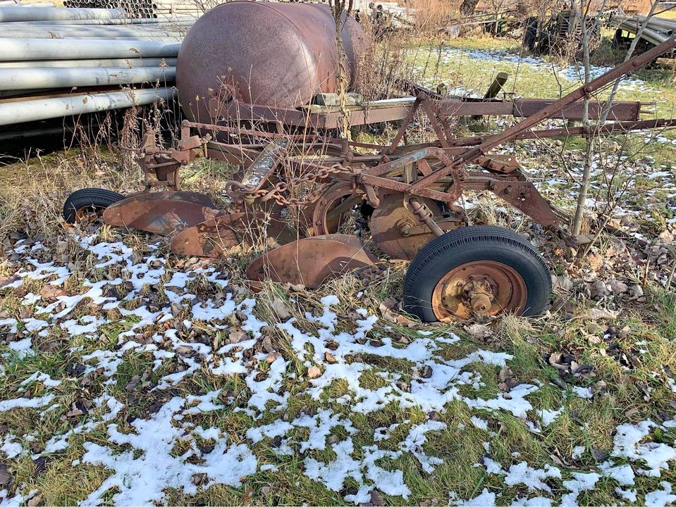

So, I'm looking at buying this guy:
I know I can rig a means of pulling it, and looks like it has a mechanical arm to raise and lower the plows while the trailer stays on ground. It's an old IHC.
My main question is, do I have enough HP to drag this through the soil at 9" or 12"?
