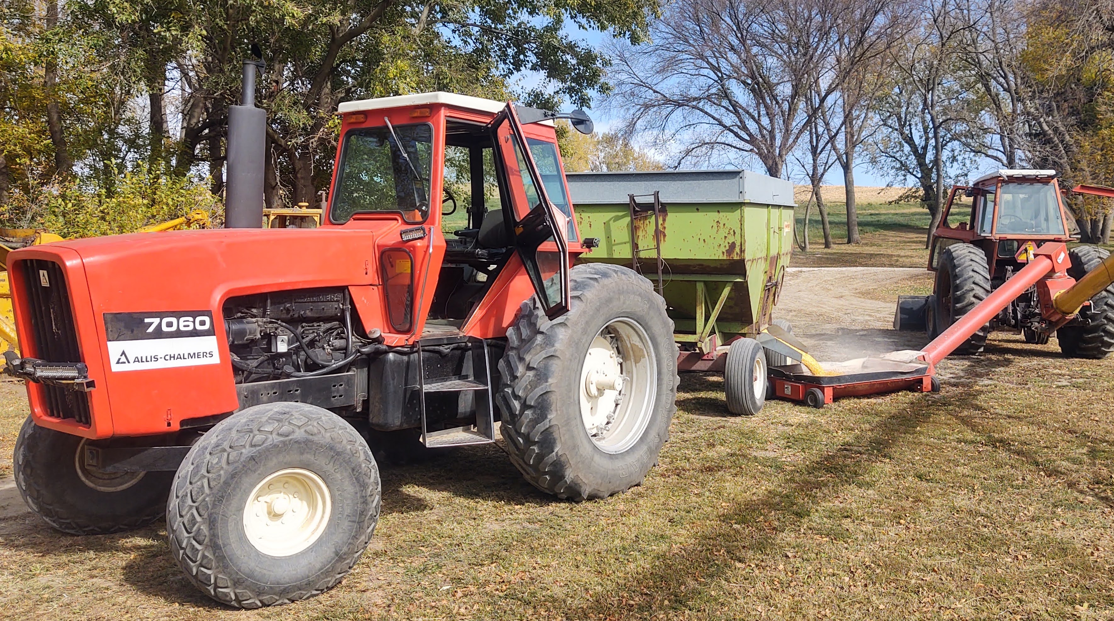

Hey everyone,
I am new to running the family since my Dad recently passed away. I recently bought my first ever tractor. I grew up with Allis on the Family farm, so I decided to stick with what I knew. I purchased an Allis 7060 with PowerShift. It is a brown belly, just painted black. I love the tractor. I recently used it yesterday for the first full day.
When I test drove the tractor for an hour the high/low would not slip into gear with the clutch depressed. I would have to kill the fuel to put it into gear. Once in gear, if I didn't let off the clutch I could always shift between high/low. I figured it was an adjustment with the clutch cable. When I had the tractor shipped, and I drove it off the semi, the high/low when into gear just fine with out having to kill the tractor. It was a warmer day when I unloaded it off the semi.
Fast forward to yesterday. The same thing happened. It would not shift into high/low without killing the tractor. As the day when on and the tractor warmed up shifting from high/low worked great. I noticed the transmission brake would get more aggressive with stopping the tractor as the day went on.
I also noticed the clutch with get more aggressive with engaging. With the clutch cold, I could inch the peddle out and gradually release the clutch. As the day went on, had about 1/2 inch play before the clutch would engage. I also noticed that with the transmission under a load pulling 200 bushels that if I put the transmission into reverse, the transmission/tractor would shudder/jolt when it first begins to move.
My question is I am assuming this is still an adjustment with the clutch cable. Would anyone have a manual or suggestions on specs on how to adjust the clutch cable? I know how to access the clutch cable, but can I adjust the cable so the clutch lets out smoother, and the transmission brake doesn't engage as hard, or do I give up one thing for another?
Can anyone also explain what is going on when the transmission is cold that the transmission brake is not kicking in until it is warm?
Here is my pride and joy! uploads/21457/7060.jpg
