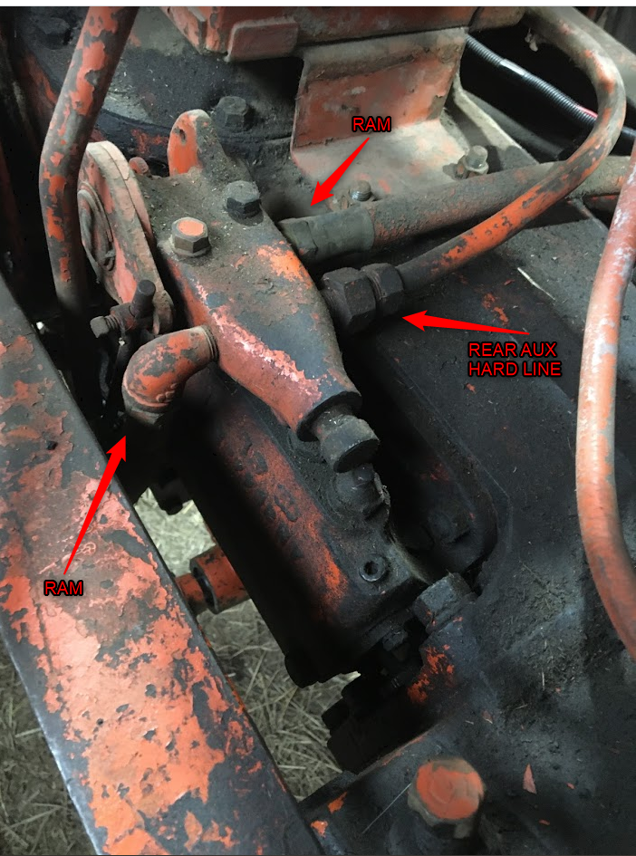

The "hold" position only blocks one of the two lift arm cylinders and I think it is the right lift cylinder that actually holds. The right lift ram hose should be connected to the right side of the hold valve. The left lift cylinder should be connected to the left side of the hold valve at the REAR port. The remote outlet (loader) connects to the LEFT side of the hold valve in the FRONT port with a steel tube running under the battery box and coming out under the seat. Anything that has been replumbed or jury-rigged in a way that isn't OEM is possibly the issue. Also, you must have the hydraulic pump actually set/adjusted for the "Hold" position, which I think you do. I just think hoses/lines are  NOT connected correctly.

Forgot about the ram plumbing for delayed cultivator lift. When I hung an RG630 on the back of my 45,I plumbed both cylinders to the hold side with a tee. Otherwise the lift shaft twisted and drooped one side when holding.

I checked over the weekend and the plumbing is done how DrAllis had said. If only one side truly does hold, I do like what Steve had said about plumbing them both to one side to keep it from twisting. I talked with my F.I.L and he was talking about setting it up for the hold position, but after looking in the manual, it appears that it already is, and since the loader holds, I'd have no reason to believe it isn't. Right now I don't have the loader plugged in. I took it off for the summer as I only need that in the spring time to scoop the padock, so I don't plan on using both the loader and 3 point at the same time.

I put a Tee where the outside elbow is and used the elbow in the tee to hook other hose to. I got some JIC fittings to make the hose connections easier.
