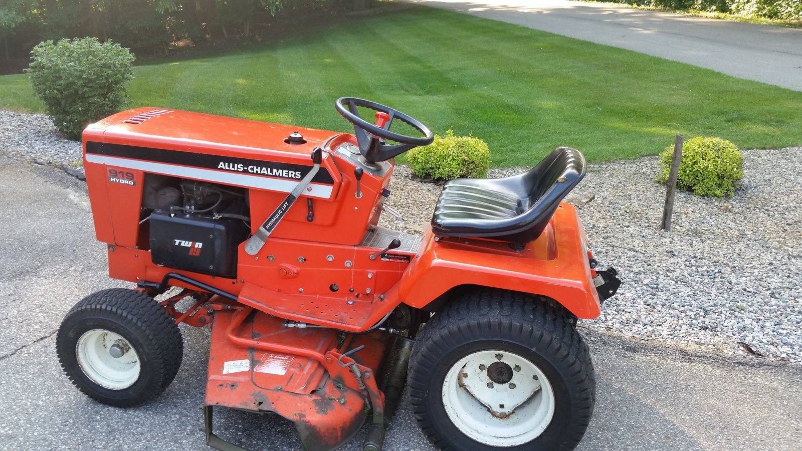

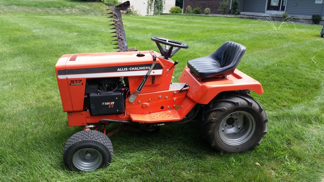

As mentioned, the #1 callout for the 917 is the series 1 KT17 engine vs the series 2.  A couple quick pictures of the tractor would easily identify which he has.  The series 1 is prone to crank journal oil starvation when run along inclines.  The series 2 corrected that.  The series 2 does not always have a 'series II' decal denoting that variety.  Below is a picture of one of my 917's and my 919, each with a series II.
These opposed twin engines are notorious for allow ags to flood into the crankcase, and the result is a hydrolock, blown out crank seals, etc.  Install and use an in-line fuel shutoff valve if that is not already being done.  Keep a watch on the oil, for telltale signs of diluted oil by way of oil level too high or smelling of gasoline.
The AC 917 never had a v-twin engine offered, howver the later AGCO 918 model used an 18hp Kohler v-twin.  The 917 and it's borther, the 919 were fantastic machines, and the KT kohlers were very smooth and strong.

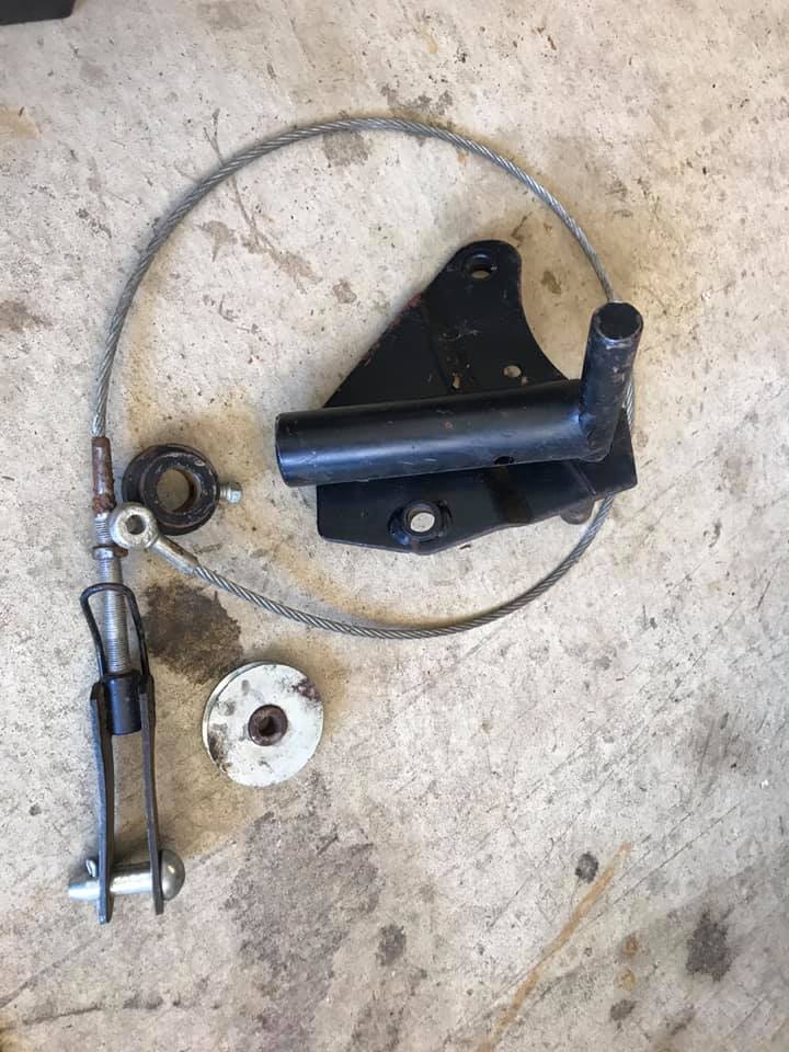

The last photo shows a rear lift kit for the 917.  There was never a 3 point hitch offered for these.  This lift kit attaches to all Simplicity manufactured attachments, and works with a sleeve hitch to raise all Brinly and similar style attachments.  A rear lift will run $100-150.  A sleeve hitch will run about the same.  The rear lift is required for all rear attachment use, while the sleeve hitch is required only for some.

I have a rear lift plate for sale. The black part shown in the above photo. It has the regular set screw shaft collar on it, but will need the "stepped" collar to fit the rear attachment point properly. That stepped collar is also shown in the above photo posted by Mr Green. The round black part..
I'd do $50 for it plus USPS shipping.
