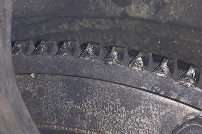

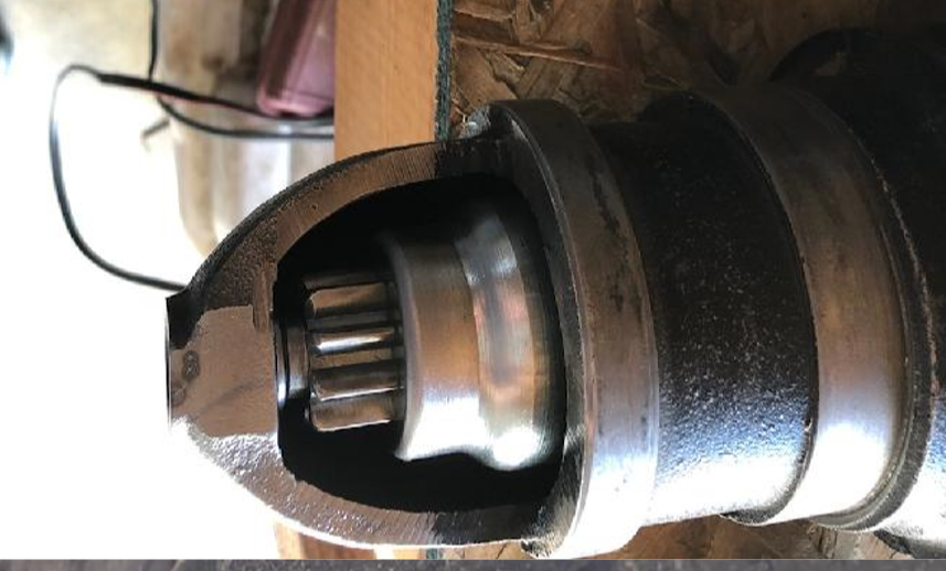

Our D15 has been having a random problem with starting. It usually starts right up with minimal cranking. Sometimes it will not turnover the engine and makes a grinding noise like the starter drive is grinding on the flywheel. It seems like the ratcheting starter drive is not fully extending to make good contact with the teeth on the flywheel. Its a crapshoot as to whether or not it will start again after this. We have tried removing the starter and retracting the starter drive, boosting the battery while starting. It will just grind again more often than not. We did get a new starter and it seems like its to short since the starter just runs and does not turn over the tractor or grind on the flywheel.
here are some rough measurements we have made. Keep in mind that this starter is secured to the tractor by the single pointed bolt and lock nut.
On tractor Stater bolt hole to far side of Flywheel teeth (so over the teeth) - 3 1/4 inch
Current starter bolt hole to end of drive teeth - 3 inches
New starter to end of drive teeth - 2 7/8 inches
It seems like our starter drive is not fully engaging. That coupled with some where on the flywheel teeth causes our issue.
Any advice on how to fix this? Is there a special Starter drive that fully engages? Replacing the ring gear?
Here are some pictures of the flywheel teeth and the starter drive.

Time to replace the ring gear. Try turning the engine a little by hand then try the starter. More than likely will start.

hmm... another 'chewed' ringgear...BTDT.
On my D-14 'Troy', I replaced the ringgear. Got from AGCO, made in India !
Please be sure to count the teeth ! D-14s were either 6 volt or 12 volt and used different ringgears ,so be SURE to count. 2 of my D-14s are 6 volts tractors with 12 volt batteries, the 3rd is a TRUE 12 volt tractor. I don't KNOW what a D15 has, so be sure to count !!
I was told all gas 4 cycle engines stop in 1 of 2 places. You'd think a 50/50 chance of stopping where there's good teeth.....yeah, right,not....If the bendix doesn't fully engage, chewing occours....do it enough and well....the picture shows what happens...
New ringgear was about $100,so I went that route. You could mark where it is now(use punch !),remove, and then replace about 30-45* from original location, providing the rest of the teeth are good. Since it's already 'split', maybe replace the throwout bearing and the pilot bearing...... one of those 'while I'm here...might as well...jobs..
if you don't , 3 days, 3 weeks later...grr.. 'I KNEW I should have' .......

Flip the ring gear. With heat.
Points: 25255
Post Options Post Options   Thanks (0) Thanks(0)   Quote jaybmiller Quote  Post ReplyReply Direct Link To This Post Posted: 22 Aug 2020 at 3:24pm
I couldn't 'flip' the one on my D14,would only go one one way.

I think it is right, only stop on 2 spots, if you want the work you can remove your ring gear and just rotate it 1/4 turn, by then I think it just makes sense to replace it.

I would replace ring gear before it eats up start drive. Starter drive cost about the same as ring gear.             MACK

Yes, that ring gear definitely needs to be replaced.  It cannot be flipped over!

Make sure the drive pushes all the way out to the end of the nose. I have had to shim a few on B and C starters.
That ring gear ain't that bad. Getting wore but still plenty of life.
My guess is under power, the bendix doesn't push out all the way.

Nathan (SD)How do I shim out the Starter drive? There is some room for it to come all the way out to the end.

Shimming is the wrong word. Adjusting would be more accurate. Usually have to cut and weld the the stop for the bendix on the starter shaft.

That ring gear is definitely wore bad and needs replaced.

Lol. That ring gear needs to be replaced! Bad by any standard.

You can see in the pic that the away side of the tooth never gets any contact from the starter drive. Usually that is a sign that the drive isn't pushing out into the nose cone far enough. To me it looks like over 70% of the tooth left. Maybe a bad camera angle? Maybe my eye sight sucks ? Maybe your eye sight is bad ? The OP can follow my advice or not. I could care less either way.

Sounds to me like you need to do two things. First, send out the Starter to get rebuilt the correct way by replacing the Armature as part of the build, (like I do) and second, change out that ring gear that's toast!  If the Starter you have doesn't fit the application, you have the wrong Starter motor. Hopefully, you still have your original Starter motor (and didn't use it for a core) and have that rebuilt the correct way.  While your changing out that bad ring gear, run over your Battery cables, grounds, and the Battery to make sure all those components that make up the cranking system are in perfect working order. You should then eliminate any of the problems your having with cranking the engine over..  HTH
