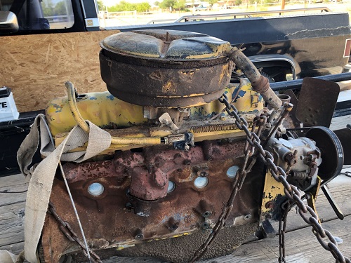

 I was up in the Alien town this mornin deliverin a parts car to a buddy that has a wrecking yard and met an old friend there that has a Hyster fork lift with a bad engine. He had picked up a Ford 6 cylinder engine that he was told would bolt up to the Hyster bell housing and wanted me to check out the Ford engine and get it running to install in the Hyster fork lift,,,,? The Ford is on a skid and has these numbers cast on side of block  D7BE,,,6015 - CA . It has a tag --Ford Power Products but the SN, disp nor Model are NOT  legible.
 Anybody ID this engine from this limited info,??  I'm trying to upload some pics of the engine now,,,,,

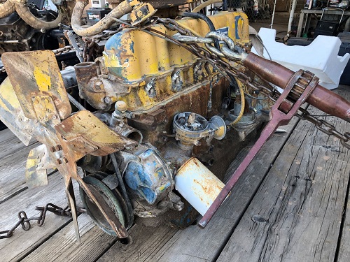

How does one tell if it is the 170 or the 200 six cylinder? It has whats left of a governor on right side,,?? Right off the bat,,looks like it needs distributor cap and wires and a starter. It does turn free and has compression,,,,

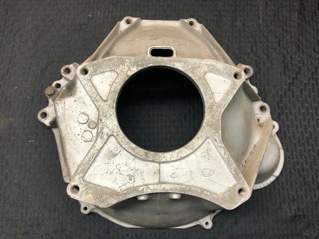

anybody know what bell Housing patterns this may be,,????

looks like an air pump on it. That alone would be enough to scare me away! no carb? no intake manifold. The emission set up on those '70s Fords were a nightmare. Of course, if it is an industrial version, may not have all the emissions stuff, but that would mean diff carb and manifold
I am still confident of this;
Wait for the Lord;
Post Options Post Options   Thanks (0) Thanks(0)   Quote shameless dude Quote  Post ReplyReply Direct Link To This Post Posted: 16 Aug 2020 at 1:18am
you can see it used to be blue, and was repainted. that is prolly a car engine, other engines that went into machinery/farm equip were industrial engines. had a Haggie high boy sprayer once with a Chrysler slant 6, when i had to get parts (starter) i found out they were different from a vehicle engine, it was an industrial engine. i then learned that most all engines werte leke that...they looked the same, but were very different. looks like your "friend" got "honked"!

Joe let me do some digging. Visually a 170 and 200 are the same. That’s what the pics appear to be.
Thad in AR. View Drop Down
Location: Arkansas
Points: 9668
Post Options Post Options   Thanks (0) Thanks(0)   Quote Thad in AR. Quote  Post ReplyReply Direct Link To This Post Posted: 16 Aug 2020 at 7:14am
The 144 170 200 except late ones and 250 had their own unique bolt pattern

144 and 170 have 3 freeze plugs visible below the exhaust manifold and 200 and 250 have 5.

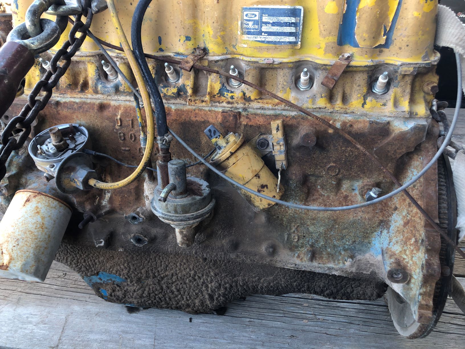

the BLOCK number D7B should be 1970 vintage, 77 actual year, and put in a Maverick... In 1977 i think the 200 was the only 6 cyl engine available for the maverick.
If it was for an industrial version, the letter "B" would have been a "J" or other ??
You would think a BLOCK was  BLOCK... why a different casting for a car / truck / tractor ?? maybe the distributor hole / etc ??

  Hey Thanks, Thad,,It does have the 5 freeze plugs on right side of block. It does have a belt driven "Pierce Cove" governor so is prolly an industrial engine,,??
 What is puzzling me is where did they mount the starter? It must be mounted way down low on the bell housing as there are no bolt holes on the block that I see,,,?? Fact is there is not a "relief" on either side of the block for the starter,,,?

Starter was prolly mounted on the bell housing plate adapter.

 Yeah,,JC,,I figured that but there is NO cut out or "relief" on the block like most others I've seen,,,,
 And NO!!,, Chask there ain't no crank start,,,,I done looked,,,,Wink
 Kinda weird there ain't a place for a starter,,tho,,,I cleaned and re checked on the btm of the block back there and there are NO threaded bolt holes on the ears of the block,,,,on either side ,,,so ,,WTH,,??

DJ, your in luck, I can give you a visual... asbra~KaDABRA!.. PRESTO!
Bonus... Wink
 Hope this helps.

 yep,,JC,,that sure looks like what I got. Went back outside and re-looked and the right side of this block has the 3 bolt holes kinda in a verticlal orientation that I'm thinking is what the bell housing bolts to,,?. Looks like what I got to locate is the "plate" that mounts the starter,,can't tell if that is a 2 bolt starter or a 3 bolt starter,,?? Plus a bellhousing, so I can see what else it is going to need to start and run,,,but RUN it will,,!!!!
 Is there any indication that the engine is an industrial model or maybe just one scrounged out of a mavrick car,,?? The belt driven governor makes me think industrial but,,,,,?? Many Thanks for your help, JC,,ClapClap

DJ I think it (the starter) definitely mounts on an adapter casting for the bell housing (clutch/Flywheel housing?), 2 bolts.
My question is what mounted on top of that casting, and what is the large appendage hanging below the starter mount

 Hey JC,,on closer inspection on the two pics,,one looks to have the starter mounting to be part of the bell housing and the other pic has what looks like a plate that fits between the block and the bell housing,,,???
Lots of Fords mount the starter like that. They have a flat plate between the bell housing and BlocK like pictured. The starter bolts to the bell housing. I’ve started many by just bolting the starter to that plate and bolting the plate to the block with short bolts.
desertjoe View Drop Down
Joined: 23 Sep 2013
Location: New mexico
Points: 13729
Post Options Post Options   Thanks (0) Thanks(0)   Quote desertjoe Quote  Post ReplyReply Direct Link To This Post Posted: 18 Aug 2020 at 4:33am
 You know,,Thad,,now that you mentioned that,,,,seems like I remember way back when My Son and I were restoring his 65 Mustang with a 289 and an automatic,,(an ALD, I think)  it had a Plate that fit between the block and the tranny and the starter bolted to it,,,,I'll have to admit,,the only'ist thing I used to dislike bout them fords is that they had so dang many different bell housing bolt patterns,,,,not like them Chevys,,,all v8s  had same bolt pattern to the bell housing,,,,Clap
Points: 12011
Post Options Post Options   Thanks (0) Thanks(0)   Quote Steve in NJ Quote  Post ReplyReply Direct Link To This Post Posted: 18 Aug 2020 at 8:38am
There were a lot of differences between the Industrial engines and the Automobile engines. One major factor, especially the Starter mounting which you feller's are discussing. I know a lot of Hysters used the F226 or F227 Continental engines which were one tough engine. We had em' at work. Starters bolted to the Bellhousing adapter also if I remember correctly.  And boy could they could pick! I think we still have a couple at other District locations. The one we had at our shop was a 1963 H80C.  I swear, that thing could pick a building up!  LOL! We had some air compressors and wire pullers equipped with the Ford overhead cam motors, (like Pinto/Mustang II) but again, they were a little different in their accessories.  Different intakes & Carburetors due to different linkages used for the applications along with Govenors.
Steve@B&B
JC-WI View Drop Down
Points: 34363
Post Options Post Options   Thanks (0) Thanks(0)   Quote JC-WI Quote  Post ReplyReply Direct Link To This Post Posted: 18 Aug 2020 at 10:56am
Well Joe, looks like your getting onfo to some degree...
Truckfarmer, Swathers were one of the applications, think the sprayers were another... and used in wood chippers, generators, etc.
Joined: 23 Sep 2013
Points: 13729
Post Options Post Options   Thanks (0) Thanks(0)   Quote desertjoe Quote  Post ReplyReply Direct Link To This Post Posted: 18 Aug 2020 at 11:43am
 OK,,I got on a Website,,Ford Power Products.com and according to some of those folks,,what I have is a 1977 Ford 200 out of a Maverick,,,, like ole Steve said earlier.  The pics I took of the engine are same as what they posted. The smaller of the inline 6 's have the integrated intake manifold on the cylinder head, which this one has, also the water pump is 3 bolts Vs the larger engines which have 4 bolt water pumps.  Somebody must of added the belt driven governor on this engine when they decided to use as an industrial application. Gonna remove the governor and prolly save or sell as it is free turning.
 What I need now is a bell housing and a starter for that year maverick or granada. I took the flywheel off and am gonna make me a template for the bell housing bolting to start my scrounging in the wrecking yards,,,,anybody got one in their stash,,,???
Points: 34363
Post Options Post Options   Thanks (0) Thanks(0)   Quote JC-WI Quote  Post ReplyReply Direct Link To This Post Posted: 18 Aug 2020 at 12:25pm
joe, the block is from a ford maverick, but the yellow is from a different engine bolted on to that block... Head, cover, cleaner, distributor, fan, coil, governor...  go check the Hyster bell housing, maybe it already has the plate on it that you need...  check location of the starter hole too...
  maybe get luck and find the flywheel would fit the FM engine?
Governor is used for constant stead power, I don't know if the forklift would need that or not.
chaskaduo View Drop Down
Joined: 26 Nov 2016
Location: Twin Cities
Points: 5200
Post Options Post Options   Thanks (0) Thanks(0)   Quote chaskaduo Quote  Post ReplyReply Direct Link To This Post Posted: 18 Aug 2020 at 12:28pm
Points: 88328
Post Options Post Options   Thanks (0) Thanks(0)   Quote steve(ill) Quote  Post ReplyReply Direct Link To This Post Posted: 18 Aug 2020 at 2:30pm
YEA... in the end if it has to match up to the HYSTER BELL HOUSING, you might as well get it NOW and check out the fit... TOO late later if it wont fit that housing.
It may not be just a simple bell housing since it has to have a hydraulic pump drive, transmission drive, and steering pump drive ???
