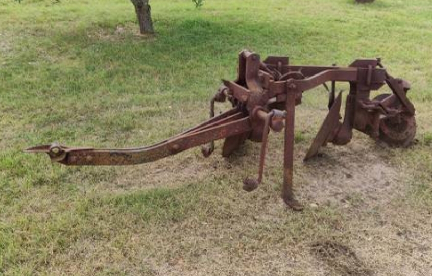

I stumbled accross this plow on my local Craigslist. I believe it to be allis chalmers due to the hitch style. I have a 1951 CA. Question is, can some one identify this plow and if so is it compatible with the CA? Is it too big?

It is a pin hitch Athens Plow, made for the Allis Chalmers tractors. I would love to have the tail wheel and spindle. Thanks Tracy

According to Norm Swinford's book, CA disc plows were two discs with 24" blades.  They were pin hitch like the one in your picture.  You might need different lift latches; I can't tell by the pictures.
If you look at Swinford's book, there are more pictures on page 223.
