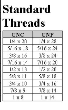

Most external bolts would be NC - national course.... internal to the engine and trans might be nf - national fine........ below is a table.... 1/4 - 20 would be 1/4 inch diameter bolt, 20 threads per inch.
