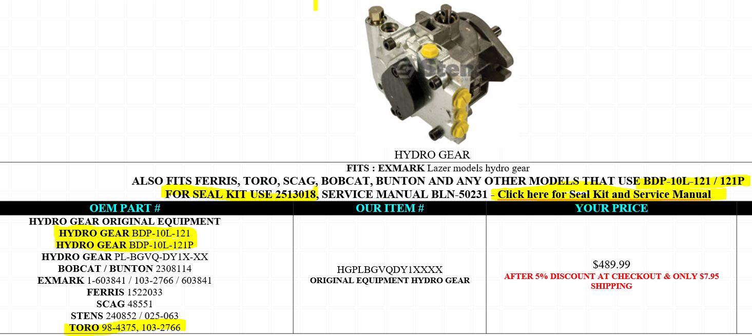

I been sitting before this computer forever trying to find a part number and source.
This is for a seal repair kit for a hydro motor on my Toro Z.  I have located the best price on a new pump if necessary.  A steal at $525 LOL
So here is the data off the label on the pump
HYDRO GEAR
EDP-10L-121P
9076P1415
Here is the Toro pump number out of the Toro parts book for the pump
E603841
Superseded by 103 2766
I am going bonkers finding the right seal kit for this hydro pump.  i would appreciate any assistance.  Thanks

I find BDP-10L
http://www.psep.biz/store/hydro_gear_hydro_pumps_bdp-10l_series.htm
Seal kit is like $20 + $8  on the click here for seal kit.
Hope This Is It.

Post Options Post Options   Thanks (0) Thanks(0)   Quote Dave H Quote  Post ReplyReply Direct Link To This Post Posted: 20 May 2020 at 6:08am
you the man chas.  thanks
