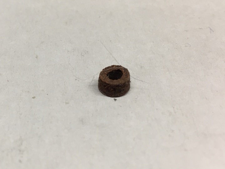

copyrite1972 - I don't have a picture handy, but I can describe it: on the 464, it's a washer about 3/16" OD - just fits inside the hole that the packing fitting screws into; hole in the center is a bit less than 3/32" in diameter.  It's about the size of the smooth shank behind the pointed tip of the needle screw. Maybe 3/32" thick, but it had been compressed by the packing fitting when I saw it so may come new a lot thicker. It's made of fiber - I had to be really careful picking it out of the assembly so I didn't ruin it. You might be able to use a small o-ring.

Can anyone post a pick of what that packing looks like? I am rebuilding my TSX-869 (D15II) and don't have packing, or don't know what it is!

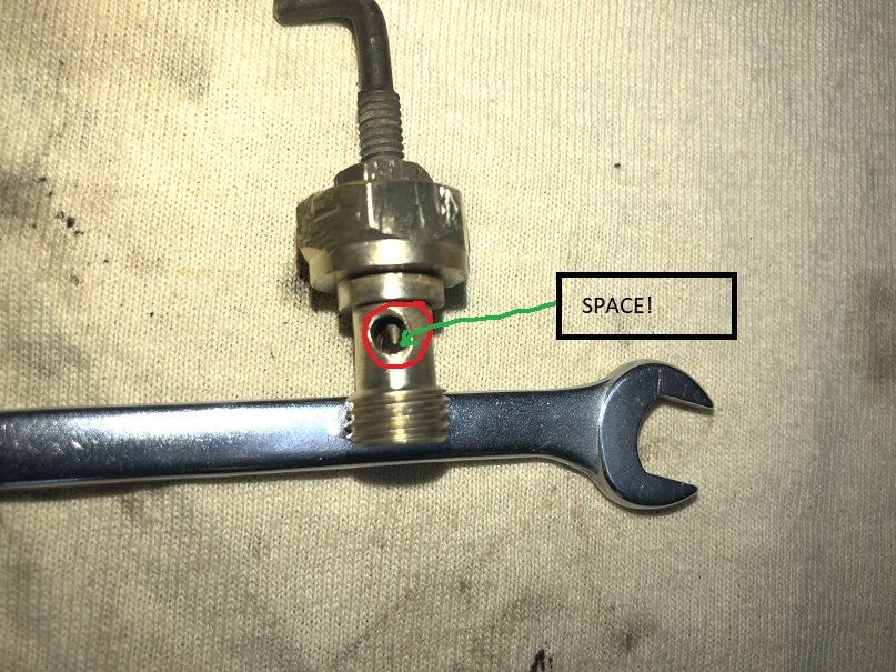

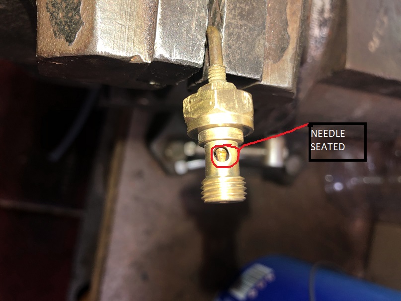

I'm happy to report that the mystery of the non-functioning Power Adjusting Needle Assembly has been solved! After several calls/emails with Steve in NJ and then this morning with Bill at Sandy Lake, I traced the problem to the packing inside the assembly.
The assembly consists of an outer housing with a needle inside a packing nut and a packing washer. The packing nut compresses the packing washer around the needle to prevent fuel from leaking out and air from leaking in.
With the packing nut is tightened, the packing washer is compressed, reducing the diameter of the hole through which the needle must pass to the point that it acts as a seat - the needle can't pass through the hole. The result is that screwing the needle into the packing nut seats the needle on that washer, preventing the needle from crossing the open area in the middle of the assembly:
To function, the needle must be able to cross that open space and seat against the opening just before the threaded section:
The solution was absurdedly simple: loosed the packing nut enough that the needle will pass through the packing, then tighten the nut. I turned the needle out 1.5 turns, installed the carb on the tractor and slowly turned it in until the engine began to falter, turned it back out a half turn plus until the engine sounded happy again, then a bit more. Whew!
