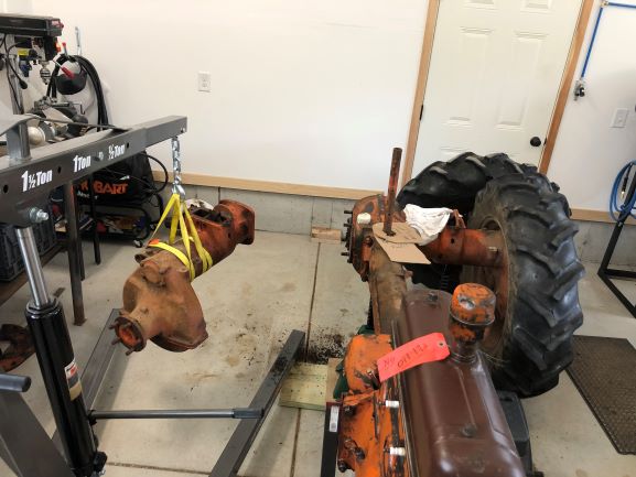

Like Greg, I used a cherry picker on my 'C' with a strap.  Image below shows were to loop it so it balances.  Rest of chassis was supported by a splitting stand I built and some tall, wide based jack stands.

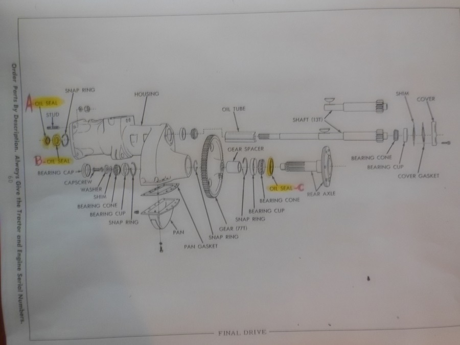

Thanks for the responses.  I plan to order the seal(s) in advance and want to make sure I order the correct one(s).  The parts illustration (see below) shows 3 oil seals, which I labeled (A), (B) and (C).  I think it needs A and/or B, but I'm not sure.  It seems that A and B oil seals are drawn as different dimensions.
Steiner's parts catalog shows only one oil seal for the "outer upper final drive shaft seal" which is 1.375" ID x 2.720" OD on page 60.  So do I only need this for the one labeled (B) and don't replace the inside oil seal labeled (A)?

I think the "B" seal might go down a foot INSIDE the final drive case and seal the final drive lube from getting OUT into the brake shoe area..... I would guess that "A" is the seal you need for the  outside of the differential case to keep the TRANS OIL INSIDE... I wonder WHY this seal is not shown with the DIFFERENTIAL case / bearings and shims ... on the other page ?

Dale, I've got two manuals here: Operating Instructions & Repair Parts Manual which came with the tractor, and a Jensales reprint of the AC Parts Manual. Your parts diagram appears to be the one in the Op Inst & Repair Parts Manual. Both show the oil seals you labeled as A and B. The original part #'s are 800351 for A and 206449 for B. [These would now be 70800351 and 70206449, I believe.] Both manuals imply that both A and B are used to form the inner seal and are held in place with a snap ring. Paul, Greg and C are all referring to "the inner seal" so maybe what used to be a two-part seal is now a single seal. Or maybe there's another, better explanation! I'm guessing that this is just adding to the confusion, so perhaps a call to Bill in the service area at Sandy Lake Implements might clear things up if one of the other posters doesn't jump back in to do so.

A cross sectional view looks something like this.. The A seal on the far right keeps the trans oil (ORANGE) from getting into the brake area that is DRY.... the B seal on the far LEFT keeps the differential gear lube  (GREEN) from getting into the brake area that is DRY... The GREEN gear lube is "SLING" around by the big bull gear.. There is only a couple inches of lube in the bottom... The ORANGE trans lube is up on the shaft / seal and easier to leak thru seal "A".

here is the differential case... this should be the seal you are looking for.

Brenda at Sandy Lake mailed me the $14 oil seal they suggested was the problem (the "A" seal on my diagram).  This was consistent with everyone's comments and the seal's dimensions are the same as noted by C in Concord.  Brenda sent me a better parts diagram that clarified the difference between A and B seals, similar to what Steve(ill) posted.
