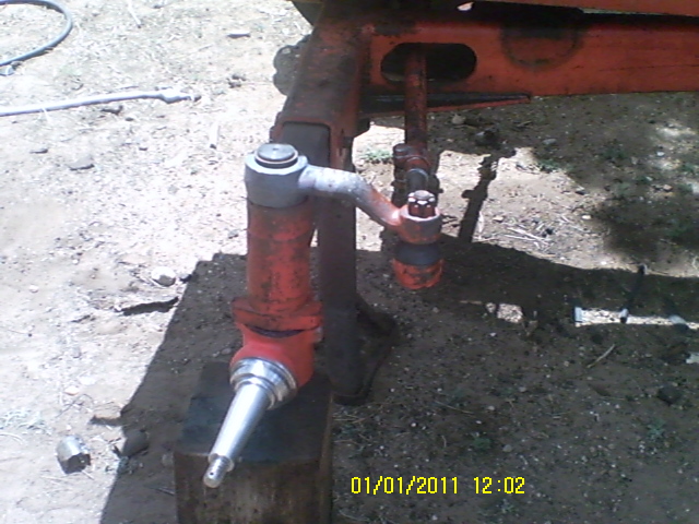

new spindle, used steering arm, tie rod and hub, knee machined for a sleeve to fit top bushing,, oh yea, a new key for the steering arm @ $32.00 from agco...shoulda got a pic of it before I got it put together,,,but I did not see any gold on it....

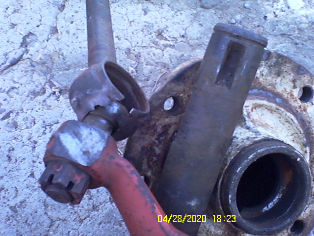

ok, I changed the topic title,,, maybe I can keep y'all up dated with what's happening with my 220, #1025
scrap iron..
I don't know if y'all can see the worn out keyway and more, the outside race spun in the hub so much, there was no way to "shim" it, ran loose enough the tire rubbed the tierod and wore it and steering arm, which was already loose and wore the spindle shaft...

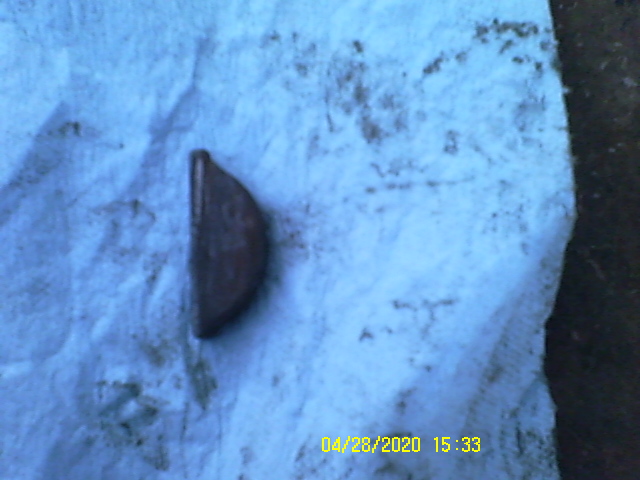

for Ted and others , the steering arm 'golden' key, this is the old one
picture is not real clear, but it has "ears" on it, and by measurements, most have concluded that it is a metric size

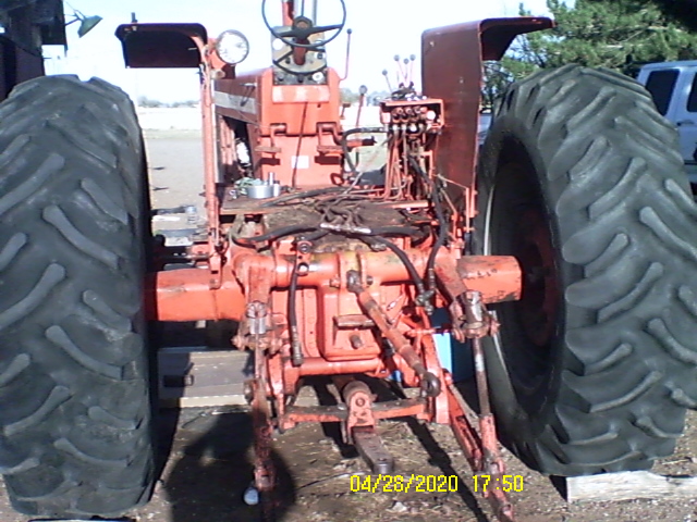

more work today,, kinda getting it naked,, gotta replace some hydraulic lines,(if I can find some) hoses will all be new. gonna get after it with the HOT Hi pressure washer and clen it up a bit, then pull off the trans shifter, and rear end cover, take a look and see what gears look like.... the way this was treated as an unwanted stepchild, I hope it wasn't run low on oil too much...might get after the insides with the hot water too...

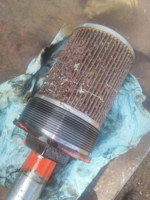

I've just replaced all the hydraulic hoses on my 220 restoration project. Luckily have a farm equipment repair shop a mile away to make up custom hoses. I would drain the rear end and clean the screen on the suction tube to the hydraulic pump. It will amaze you with all the crap that has accumulated over 50 years.

Calvin;, already been there, its on a previous post somewhere, the suction screen was plum full of crap, the power steering quit, and I hope it was cause of the stopped up screen, BTW a new screen at AGCO was priced to me for $200.00
