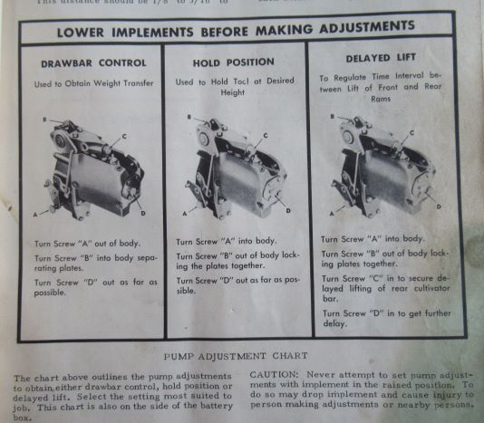

Do you have a manual?
could be something as simple as the control valve falling out of adjustment.
That thumbscrew is turned one way or the other to perform different functions.

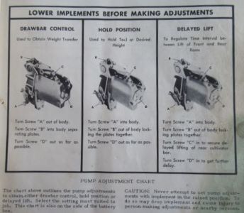

Post Options Post Options   Thanks (0) Thanks(0)   Quote Brian G.  NY Quote  Post ReplyReply Direct Link To This Post Posted: 19 Apr 2020 at 4:21pm
Brian G. NY View Drop Down
Location: 12194
Points: 2278
Post Options Post Options   Thanks (0) Thanks(0)   Quote Brian G.  NY Quote  Post ReplyReply Direct Link To This Post Posted: 19 Apr 2020 at 4:26pm
Having a hard time getting the picture sized c orrectly.

I have the original manual for the tractor. I looked at that page but it didn't seem to apply to the runaway bucket. Also, the thumb screw has enough paint on it it will take a hammer and chisel to move it!
