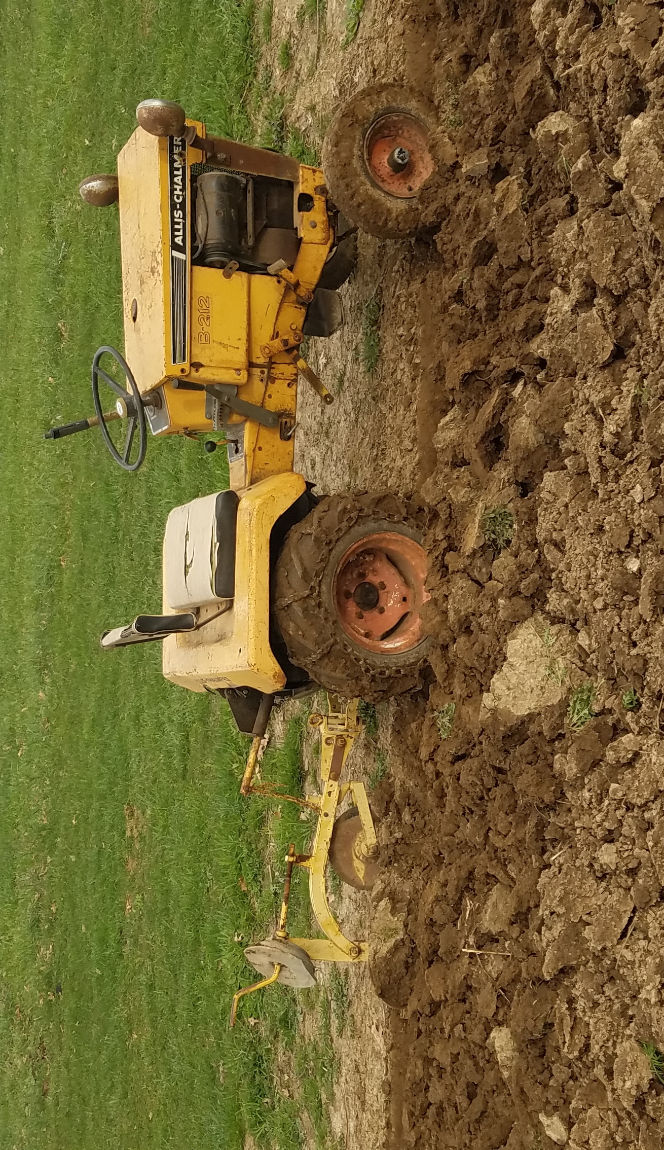

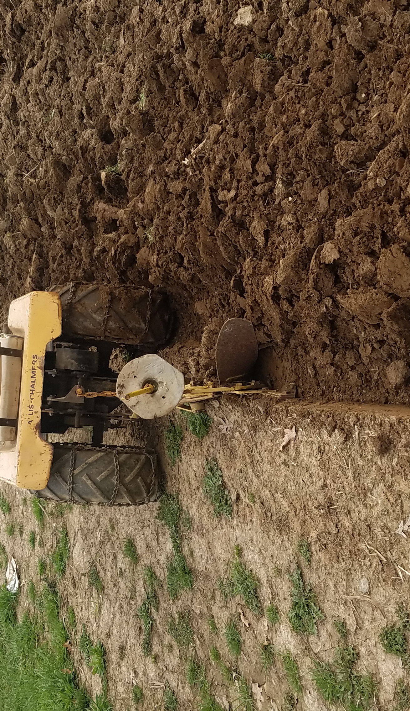

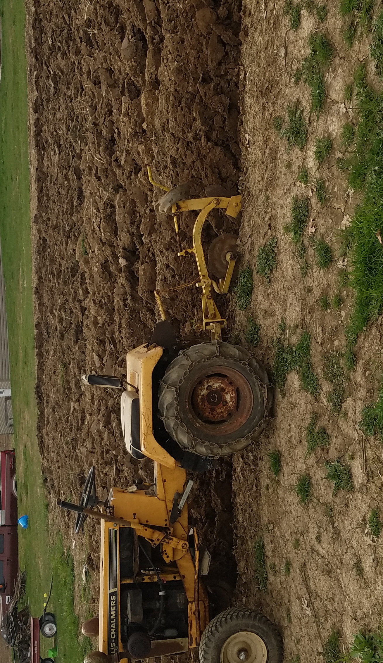

It uook about 2 hours to get the plow to plow the way it should.
Lots of fine tuning.
Plows like a dream and i had fun

Ah, first gear, variable speed on max and a little weight on the plow.

Believe it or not that 212 pulled that plow 2 gear full speed on variable.

I've watched many you tube videos and wonder where those guys learned how to plow. Yours looks so nice and a even cover of the trash and a very nice furrow, Good Job. You should be very proud.

one trick I do is look far,far away to get straighter rows. Also I can 'feel' the right front wheel in the last furrow and keep just enough pressure to keep it there...
I'm thinking if you plow 10,000 acres, you'll get good at it....Big smile

Gadzooks!!! I thought I had hills, yours are vertical!!! That little beast has some traction! LOL
Kidding aside, very very nice. I have one, but the sleeve hitch on my Ingersoll 4020 (sorry for a red-color lol - but it's really a type of orange similar to my AC 6140) is not getting it right with the plow, fortunately I have a 42" Ingersoll hydraulic tiller for the gardens.

I hear you on the plowing technique yes it drives me nuts too if I don't have nice furrows.
Lost of playing with adjust ments and patience.
Most of the you tube videos thoes aren't plowing to the correct depth.

I set all my plows so that when they go in the ground the full entire moldboard is covered with dirt there's no exposed area and is ware i get the nice job.
The funny thing is watching on YouTube those guys they seem to have a hard time pulling them when they go into the correct depth.
