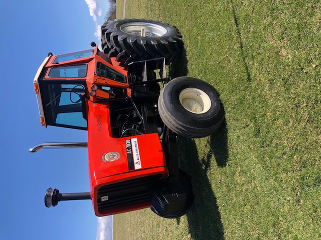

Post Options Post Options   Thanks (0) Thanks(0)   Quote captaindana Quote  Post ReplyReply Direct Link To This Post Posted: 01 Apr 2020 at 8:22pm
New 20.8’s, I’m sloooowly getting her up to our standards!
