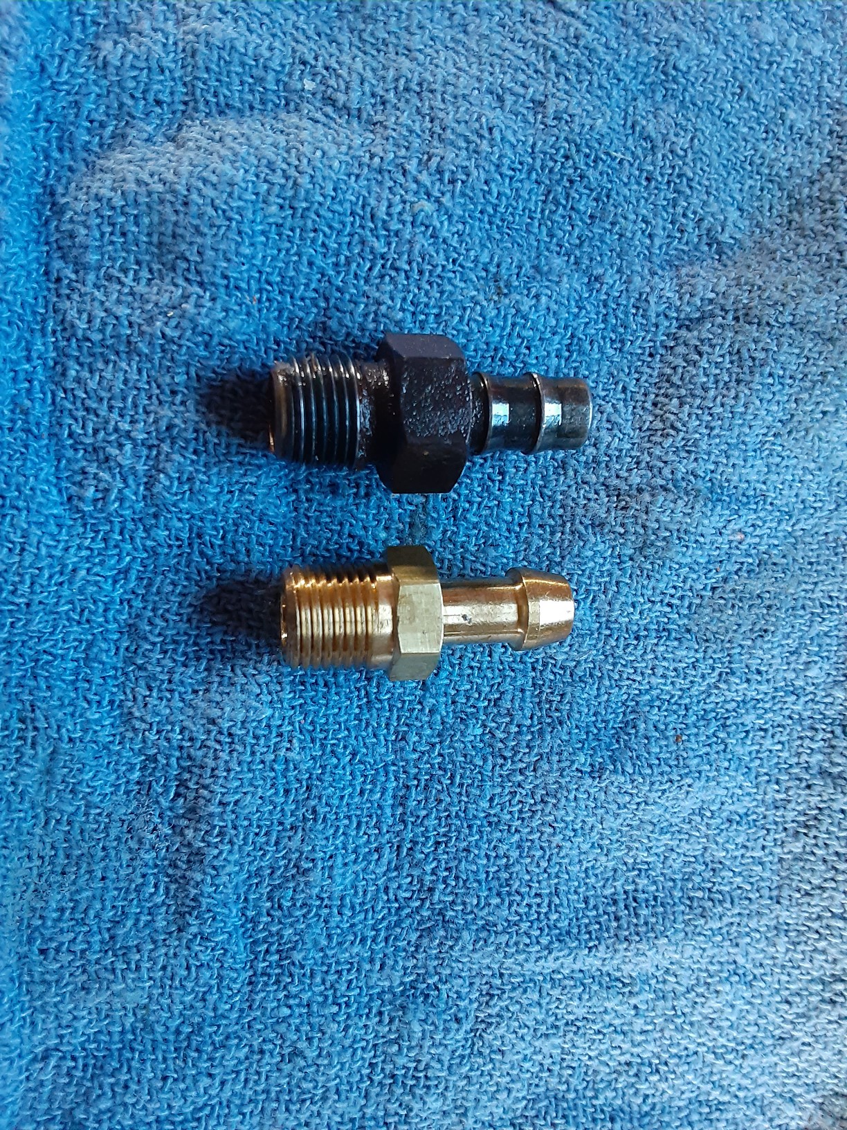

Thanks InjpumpEd and the good Dr. for the help, that will get me going for the weekend. Pump rebuild coming up, looks like I found a project to spend my corona cash. Instead of ruining the  check valve I just replaced the fitting for now with an open one.

Is that the same fitting that's on a F2 Gleaner with a 433 ??  I remember taking a fitting off to clean/remove the black plastic pieces out of the return line( our local independent frowned on the breaking the glass ball), but I don't recall this (pictured) fitting ?? And YES, there were MANY  "clean-outs" that fall Ouch. The pump was rebuilt off-season the following spring.
