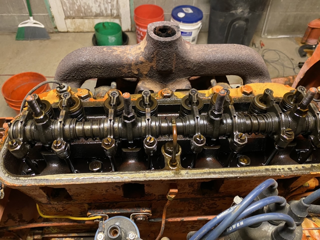

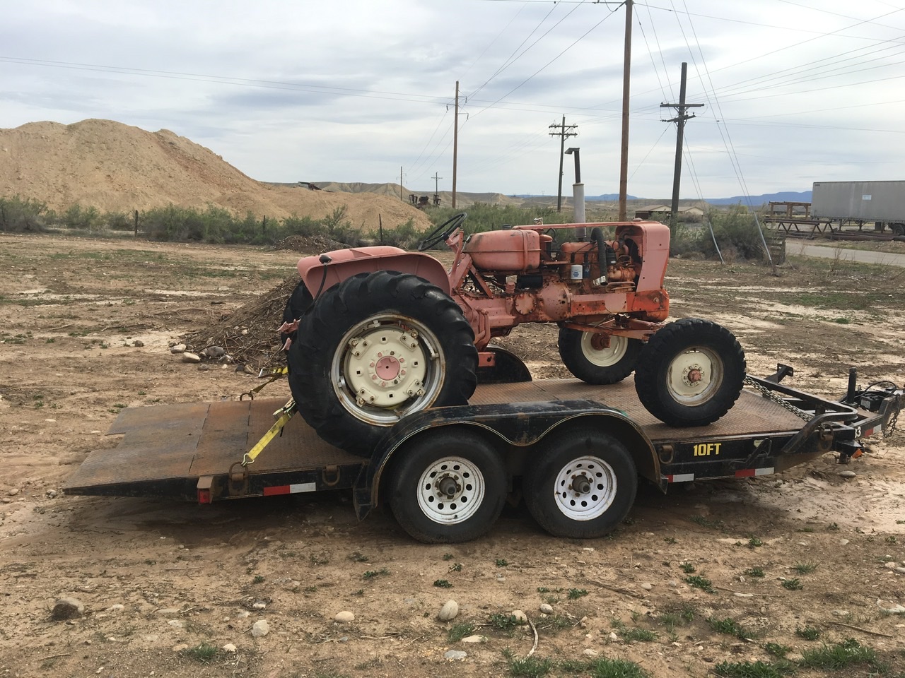

I am in the Middle of a in frame over haul on my tractor who the wife has dubbed "Ruby". A 1958 Allis-Chalmers D14. I purchased this tractor from an old farmer in western Colorado were I  currently live. When I first got her the tires were really bad but held air. I recently got new rubber all around . (fluid filled all around) The transmission, Clutch, Hydraulics are all great. The brakes are even operational. The engine is the 149 CID straight 4 gasoline. It had so much blow by that the valve cover looked like a second exhaust pipe but still ran. I have in completely torn down and cleaned up.
Here is a list of what is getting done.
New Cylinder Sleeves and pistons. Rod bearings obviously.
Valve train Kit
New Muffler
Oil Pressure Gauge
Water Temp Gauge
Ammeter Gauge
Gear Shift dust boot
Gear shift lever washer and snap ring
Air Cleaner mushroom cap
Fuel Strainer
New Carb  (Zenith)
Fuel Filter
Fuel Gauge
Tank Webbing
12v Ignition Coil
Pentronix Electronic Ignition 12v negative ground.
Spark Plugs
Spark plug wires
Alternator 12v 63amp
Alternator Bracket
New Belt
Water pump
Cross MFG Leveling arms (Pair)
Hastings oil filter
Radiator pads
Thermostat 180 Deg F
After this overhaul the only things that does not work is the power steering pump. It steers very easy now so I did not feel like messing with it.
One Piece of information that I am missing is Torque Specs . I purchased a service manual from Steiner Tractor but it does not have torque specs or tightening patterns. Can someone help me out with this information.
Will be posting some pictures.
