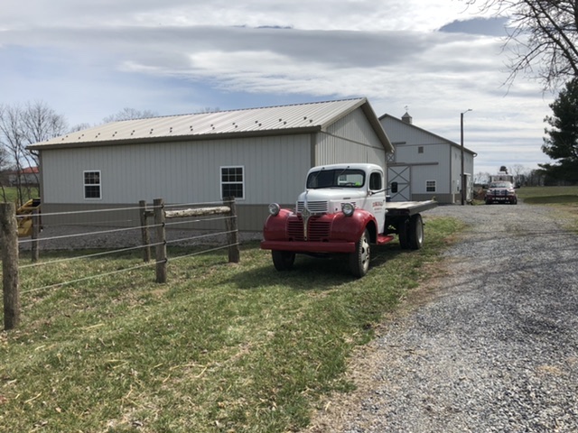

Your rear ratio is probably 6.38:1 like my B2F. I have a 3 speed auxiliary I'm going to be fitting into it sometime soon.  The extra 2 speed rear I have here is 5.33/8.39:1. It will bolt right in and only the driveshaft will need to be about an inch or two longer. If you make a bar to lock it in HI you wouldn't need all the vacuum shift controls, although I should have them also.  Maybe you have something I need to trade?

Drove one like that many years ago chasing a fox silage chopper across the fields! --- I kinda liked the truck, ---- Gm guy myself, ---but as long as they run I don't care what animal is on the hood! LOL!!
Nice truck to start with--wont take much to parade that one!

Paul, Just brought the truck home yesterday and not going to touch anything till I get the title. I haven’t got it on the road yet to make the fenders flap, had enough brakes to hold it back when unloading. I want to drain the fuel, flush the tank/lines, change oil/filter. Motor is free, going to put a little ATF in the cylinders just to make sure the rings are free. Looks like a 1.5 ton 236 flat head, 4spd so far w/out turning signals. There was quite the story with this truck, I’ll wait until the title gets here before I share. From what I understand the truck was last used in ‘08. I’ll need a bunch of small parts and on the lookout for a 2spd rear. ExSW— I would like to find any information available if you have something you’re willing part from. BTW— that Cummins will stay in the car

This is a 1947 1.5 ton Dodge. I have been looking for one of these for a very long time. If anyone is familiar with these trucks, I’ll have several questions.
 Those W series trucks  share many components with my B series trucks. How are the brakes?  It probably has a slow rear and will only do a little over 40. The 1.5 ton should have the 236 motor and 4 speed.

Got a rusted out pickup to steal the Cummins out of?

NICE!  I thought you were talking about the car in the background.LOL

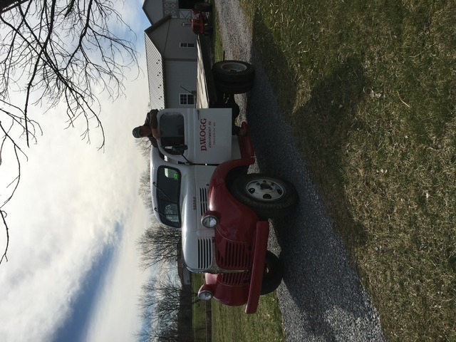

This is me and my new toy!

Looks like a International and in nice shape

project ??? dang it looks GREAT the way it is....whatever it is...
