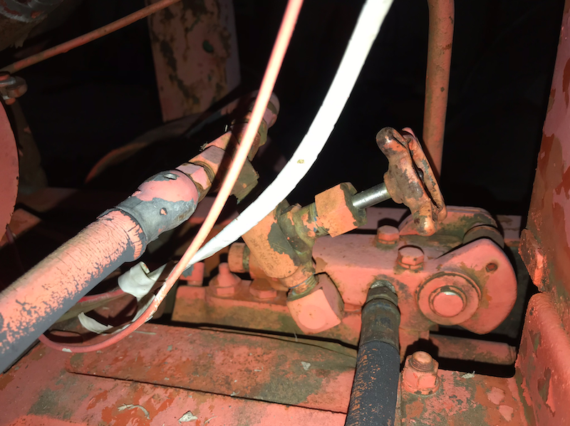

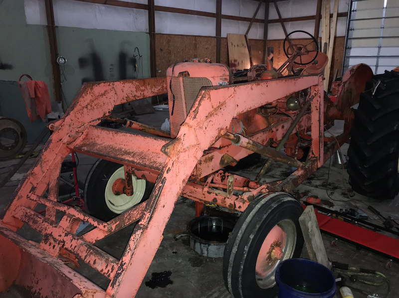

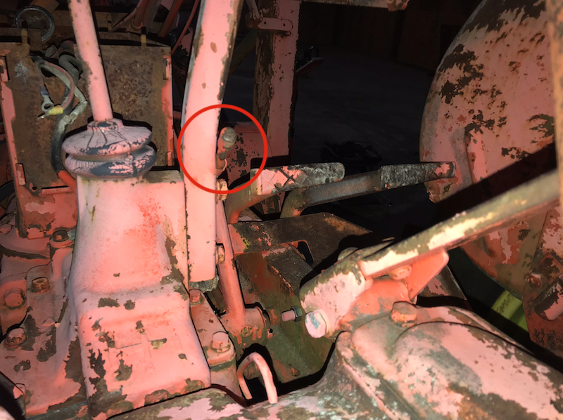

Hello to you all. New to the site. I recently purchased a 1955 WD45 with a 3-point and loader. The loader is a New Idea 501, serial 01989. I'm restoring the engine currently, as it became seized sometime within the last 5 years. I'm wondering if anyone can direct me on how to go about using this loader. I don't see any obvious levers anywhere that would be used for up/down. Below are pictures of the loader, where it's plumbed into the hydraulics, and looking at tractor controls. One of my pics here has a red circle around a knob next to the steering column that can be pulled in or out, and I have no idea what it's for. Looks like it's connected to something somewhere down close to the hydraulics. I've never driven one of these, but I'm looking forward to restoring it. Any and all info in appreciated. Thanks!!

One lever up by the steering wheel is throttle the other runs your hydraulics. You pull the lever on the right arm to dump the bucket then lower to the ground to reset it.
Brian G. NY View Drop Down
Location: 12194
Points: 2269
Post Options Post Options   Thanks (0) Thanks(0)   Quote Brian G.  NY Quote  Post ReplyReply Direct Link To This Post Posted: 12 Jan 2020 at 7:51pm
The lever you have circled in red controls the PTO and has nothing to do with the hydraulics.
You will have to follow the hydraulic hoses to figure out how the loader operates.
It appears that it is simply controlled by the lever on the LH side of the steering wheel;
the one that mirrors the throttle lever on the RH side of the wheel.

Have one just like it on my 45 and it's a pretty strong unit. I couldn't see the bucket release in the picture but it will be there because you can see the latch pin in the front above the bucket. because of the hydraulics it has it's limitations but is still useful. Some have added a second pump on the front of the engine and with extra cylinders made it more user friendly. Never done it myself so you can directions from someone on here on how to do it.      Leon

Welcome! You have a solid tractor The guys have given you good directions on the use of the hydraulic controls and bucket operation. I used one very similar every year to clean out a barn.
Removing that loader might make it a whole bunch easier to work on the engine. Are you pulling the engine?
I like the 45's! Does it have power steering?

Thanks for the helpful replies, everyone! Chris, yes it does have power steering. Another reason I wanted it. I won't be pulling the engine completely, but so far I have removed the oil pan, belts, and cylinder head, which is soaking in my electrolysis tank. It was severely neglected. I had to unbolt the loader from the front half of the frame and lower it to get the oil pan down.
On the hydraulics, I guess I'm not understanding how the 3-point is to operate separately from the loader. Doesn't the LH control lever also raise/lower the 3-point?
MACK View Drop Down
Joined: 17 Nov 2009
Points: 7664
Post Options Post Options   Thanks (1) Thanks(1)   Quote MACK Quote  Post ReplyReply Direct Link To This Post Posted: 12 Jan 2020 at 8:43pm
The knob in first picture shuts the loader off to where you can use arms on back.
.            MACK

Oohh, got it. So with that valve open, does that shut off the rear, or are both operating at the same time? Seems like it would be easier to just replace that with a ball valve for on/off operation.

My gut feel is that the lift arms on the rear will go up and down with the loader. Mack and lots of other folks are way better than me on hydraulics.

That's what I had thought, too. I figured if I had a mower attached to the back, I could lift the front off the ground a bit, shut it off, and use the lever to control just the back. Ideally I'd like to plumb a rear shut off as well, and maybe get the shut-offs up on the steering column a bit closer to the seat? Lots of dreams for this thing, lol. I don't currently have a stand, but will get one soon. I agree it's a far better experience to do it out of frame. Yes, so far I've gotten parts cleaned with it and it's done a very good job! Have never hot tanked though. Is it more thorough? I'll post more pics of the going-on's as well.

By looks of pluming, with valve open, both would work. With valve closed, only rear would work.        MACK

The hydraulics will raise the rear first then the loader. I put a valve on mine so I could isolate the rear from the loader. Makes it a little easier. Here is a pic of the valve mounted on the fender. If you get a valve make sure it is a high pressure valve.
Location: 12194
Points: 2269
Post Options Post Options   Thanks (0) Thanks(0)   Quote Brian G.  NY Quote  Post ReplyReply Direct Link To This Post Posted: 13 Jan 2020 at 9:51am
I also installed a diverter valve on my WD.
In the forward position, the loader operates and the rear lift arms stay wherever they were when the valve was switched.
In the rear position, the loader stays wherever it was and the rear arms operate as normal.
This works out great as I always leave my back blade on which enables me to do clean up work when using the loader and provides lots of ballast when using the loader.
These diverter valves say they are limited to 2,500 PSI but I've had mine on the WD for years without a problem.
I installed a lever reachable from the seat which makes it more convenient like mdm1's valve.

Be DANG CAREFUL when you're working with hydraulics!!!!!!!!   There was a thread on here about what can happen if a hose or fitting breaks and you get injected with hyd oil.  It's some BAD stuff.  So I don't think I'd want any hoses or fittings close to me that might snap at any given moment.
Yes, you got a good grasp of how the system works.  It really is simple.  I put ball valves in mine and I like em a lot better than turning one like that all the way in or out.  Make darn sure you have a valve or hoses that are HIGH pressure, in excess of 4000 lbs.

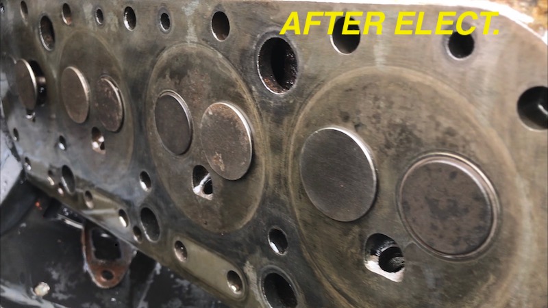

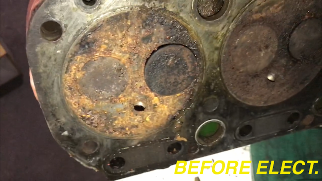

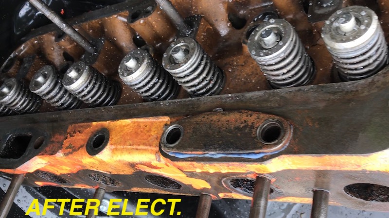

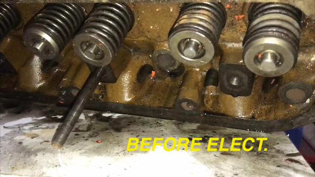

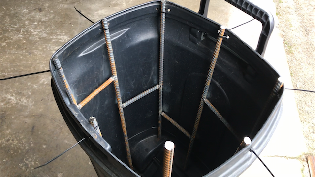

Hey fellas'. Thought I'd post an update on the engine cleaning process so far. I've had the cylinder head sitting in my "Mach 1" version electrolysis tank, which was the biggest storage tub I could find at Wal Mart, filled with about 40 gallons of water & 1.5 cups of washing soda. Threw in some positive anodes (spare angle iron laying around the shop) and dunked the head. Three days later & I'm astonished at the results. Pics are below to see for yourself! I have a "Mach 2" version electrolysis tank now; 35 or so gallon trash can, 8 pieces of rebar from Home Depot (1/2" x 4') all welded together. This makes it so much easier to use my overhead electric winch to dunk it in. Check it out!
Points: 8558
Post Options Post Options   Thanks (0) Thanks(0)   Quote Sugarmaker Quote  Post ReplyReply Direct Link To This Post Posted: 14 Jan 2020 at 6:22pm
ssccarb,
Yes its not like sand blasting or other aggressive mechanical cleaning methods, but I like it I like the idea of using the lift to dunk the heavy items. I also like the idea it works around the clock unattended. If you get real creative you can insert rods into the blind areas to clean the inside  of cavities too. I did a gas tank once., the inside and the outside at the same time with a suspended anode down in the tank. (insulated so as not to touch tank)
When I am cleaning parts I have trouble keeping up with them coming out of the tank.
Head looks much better. I like your welded rebar annode system too!
 I believe there is a down side and you may need to do more research on this? The process can cause hydrogen embritilement. I do not know the extent or much about this. Some folks don't do bolts, it might affect your valve springs???
Here is a example of some Allis parts Before and after E tank.
Edited by Sugarmaker - 14 Jan 2020 at 6:33pm
