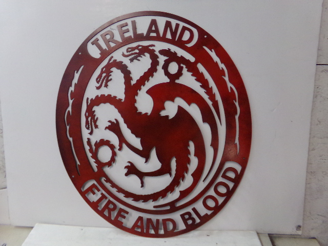

I have not done a base color then a top coat.
You have to wet sand the first coat, before you put on the 2ed one.
What I have done, is have 2-3 guns setup with difference colors that all cook at the same time/temp.
Here is a picture of a sign that is two colors, shot at the same time.
Edited by cabinhollow - 03 Dec 2019 at 11:35am

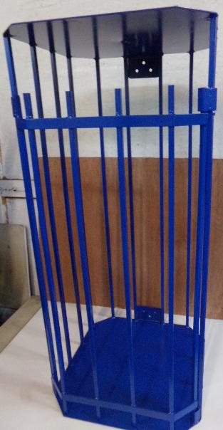

DJ, here's what you missed today.
Did two of these.
Post mounted small sq hay bale feeders for mini horse, donkey, sheep, goat.

 Them look greta,,Cabin,,,Clap Hey,,you might sell some of those to ole Dick L ,,,he gots some of those mini horses,,,,,Clap
