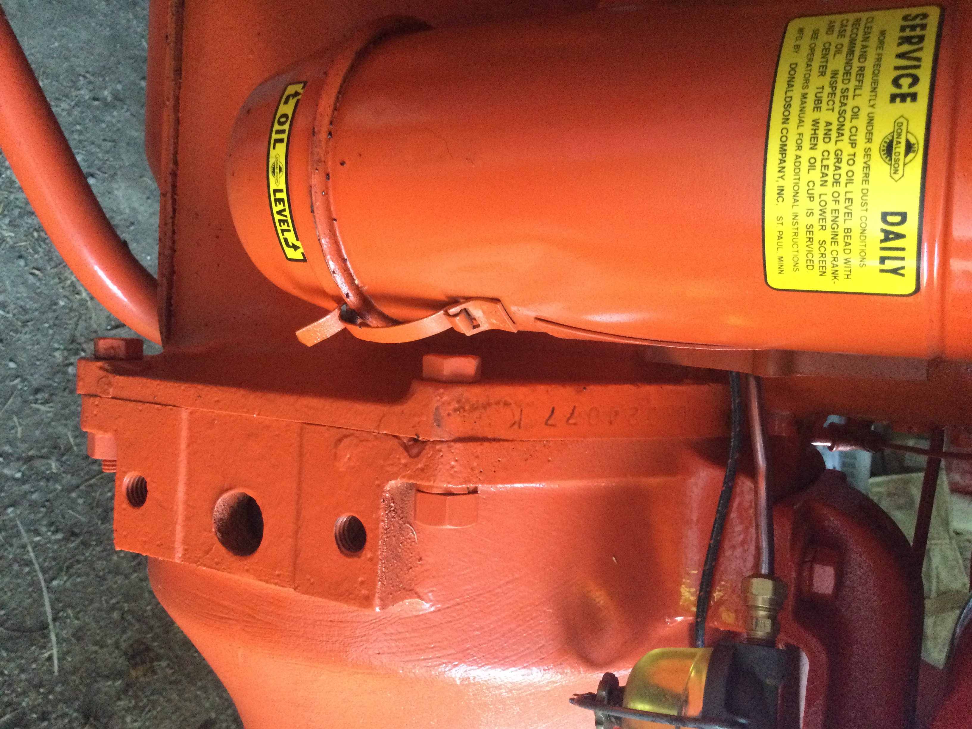

Hi yes it sounds like you have the pan seat the number 715130 is the casting number the engine serial number is on the engine just below the fule tap where the engine bolts up to the bell houseing it will start with CE or BC but should be CE  unless it is fitted with a P3 perkins diesel which some of the English variant are .

hi Kiwi, mine is a petrol number. I looked on the left hand side (from the front) and couldn’t find any numbers where you described

Just a photo on where to look. taken on my EB 1950

ok, fund the engine number with a bit of degreasing. It is not on the flat part of the engine block, but on the 1” wide ridge that bolts to the gearbox.
Anyway, my numbers are CE 3461 K.
Googling furiously to see what this means
