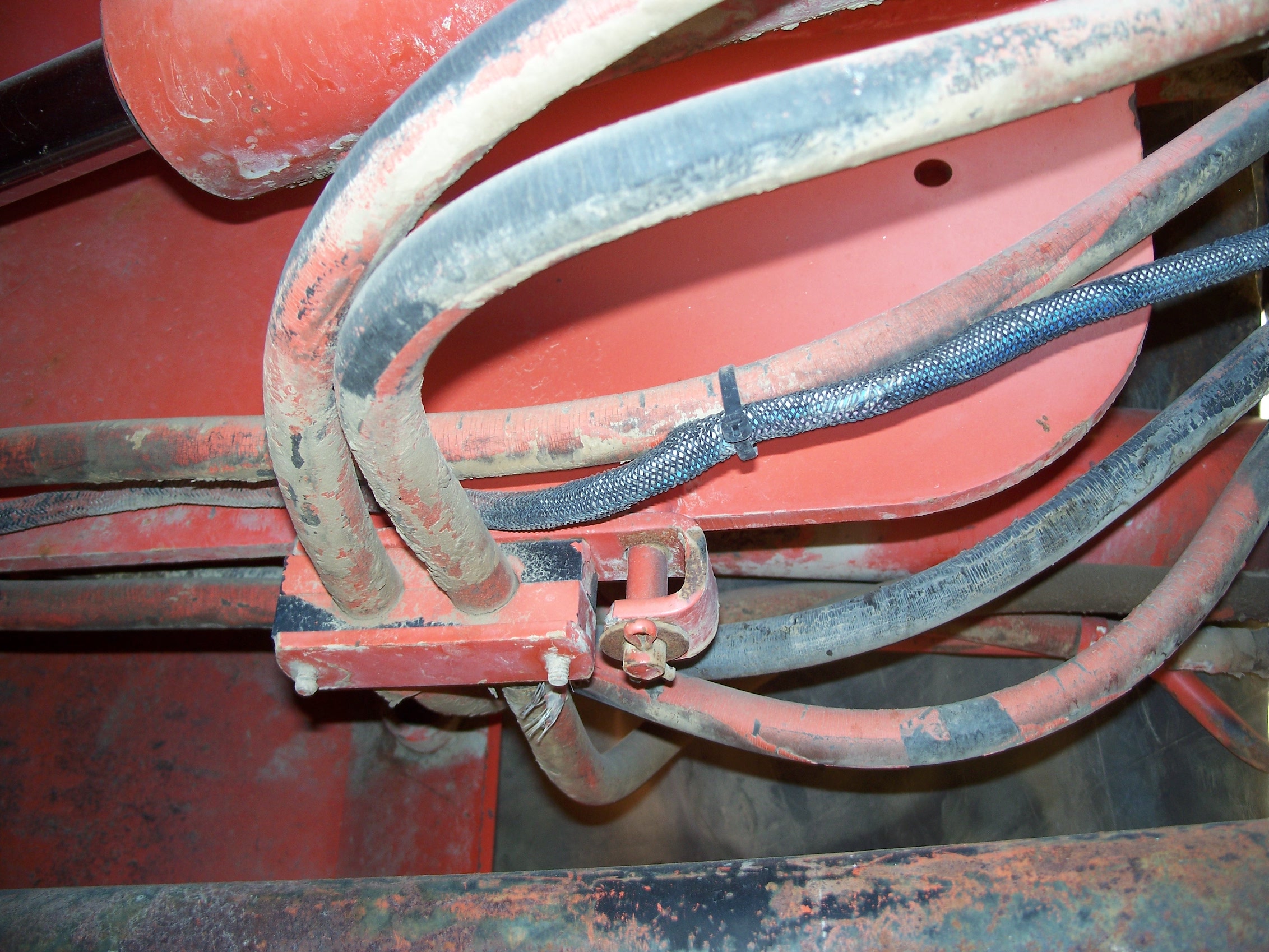

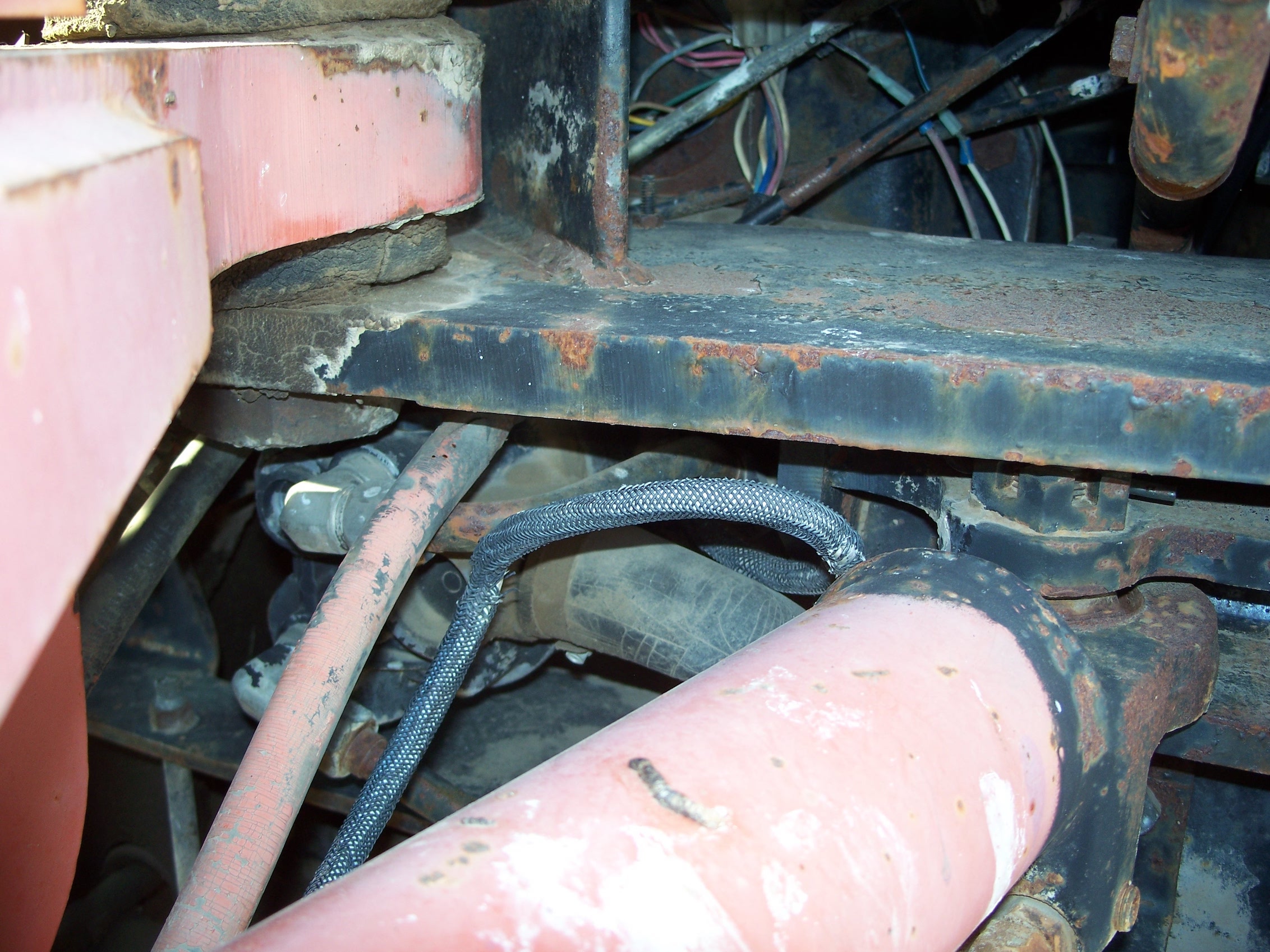

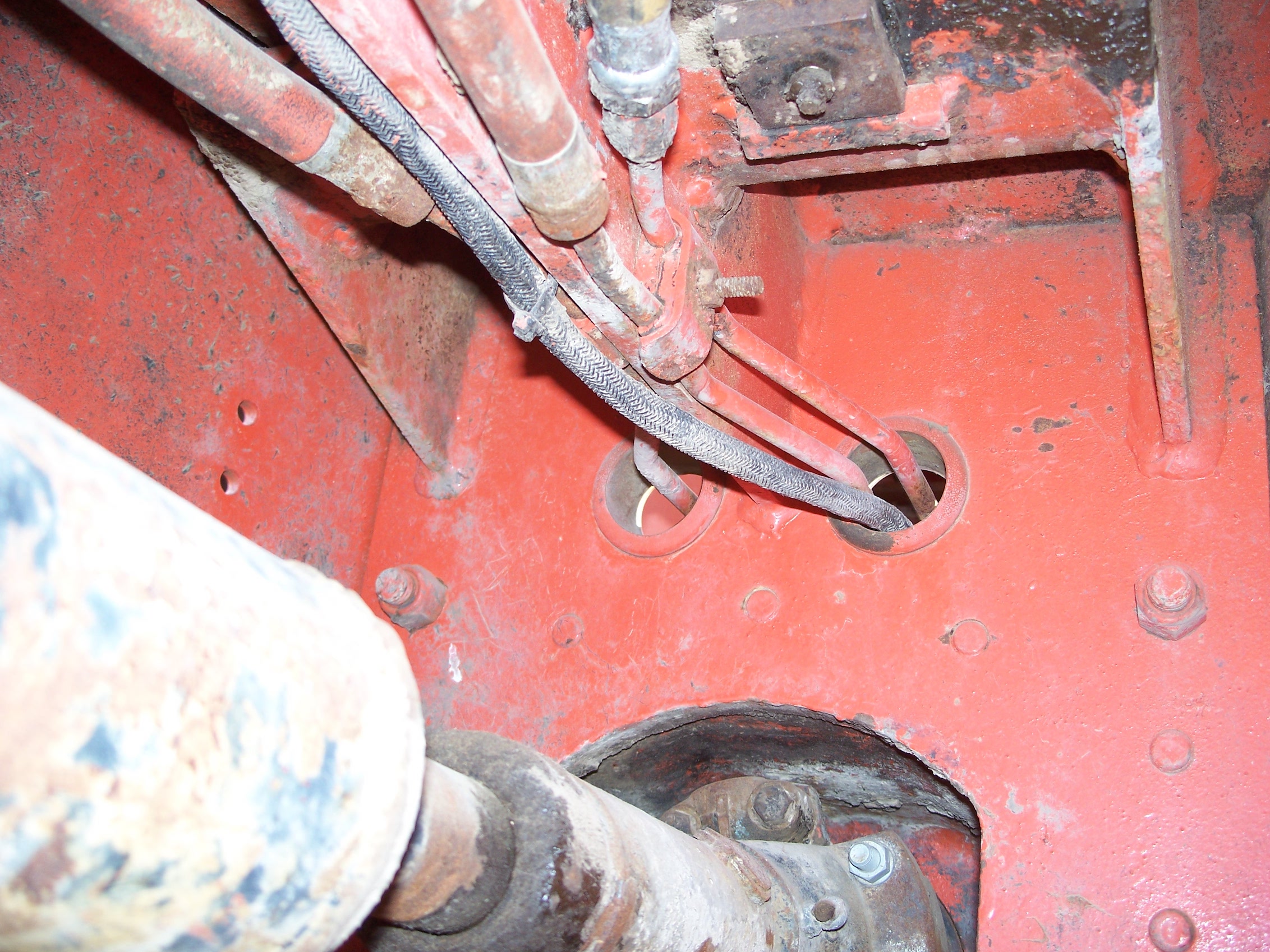

Took a couple pictures of mine.  Runs right by the right steering cylinder.  Probably missing a wire tie there.
