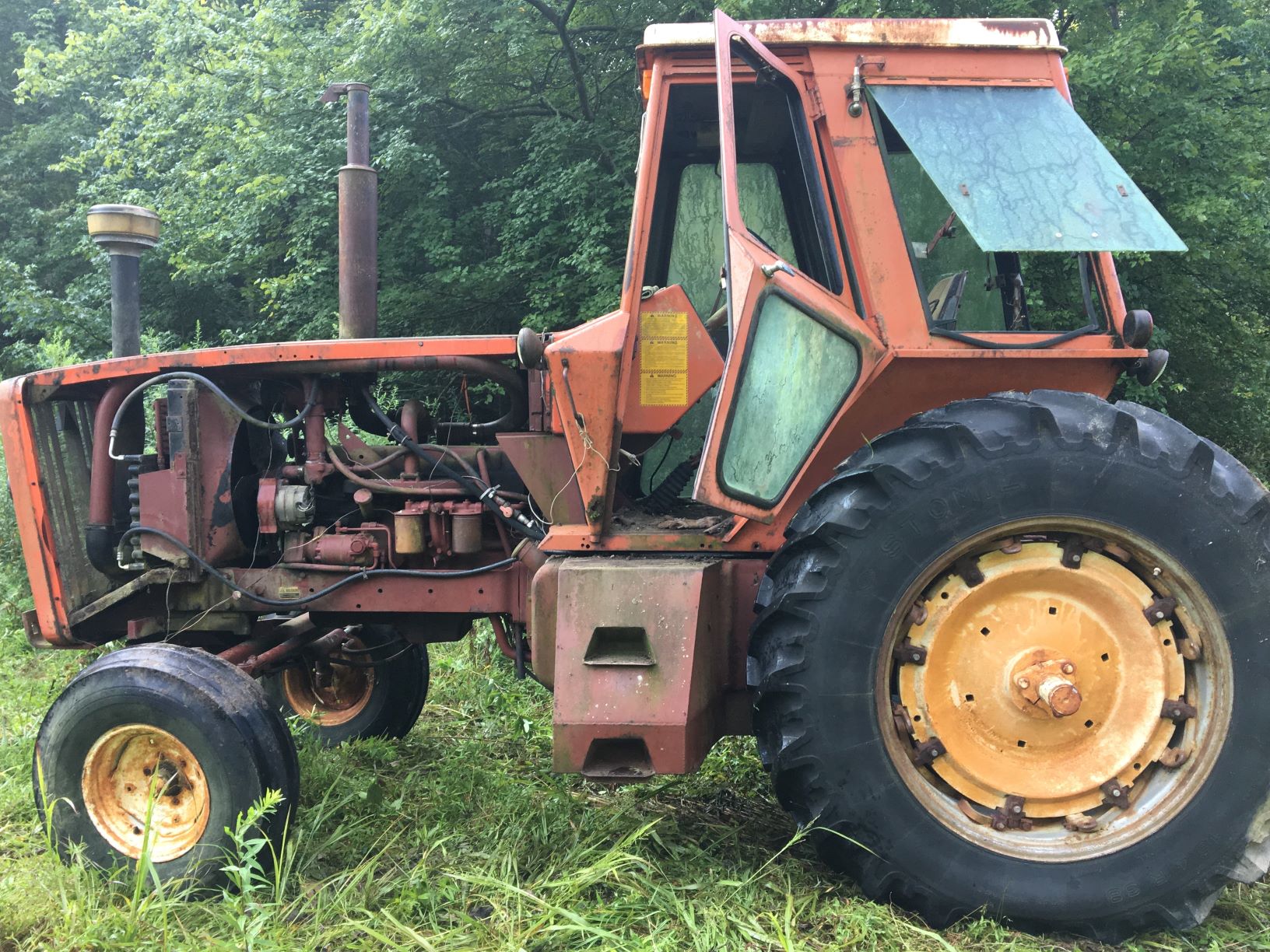

I just purchased a friends farm equipment he has been in a rest home for 8 years now here is the 7000 I got I had to remove the covers to pull it out of the woods and briars you could barley see it , it had been sitting for 8 years 7000.JPG

That's an interesting step. Is it an extra fuel tank?

Hope you have the side panels. Looks pretty good for sitting
that long. Good luck with the tractor.

IT only has one big fuel tank so im not sure what your asking ,this is my first experience with a allis chalmers, heading over this morning to try and get it running.

Yes I have them I had to remove them to move it as there were vines all grew up inside it and I did not want to mess them up

I don't remember a 7000 having those steps. Did I miss something over the years?

To those that have/had this particular model, what are the various black hoses on the step side of the engine? One of the "rear" hoses seems to have some sort of valve ?? Thanks, I have never seen this much of a "7000" series engine without the covers .

Looks like a heater hose with the valve. Also two black ac hoses running to the cab

Looks like a cooler has been added in front of the oil cooler. Would have to trace them back to see where they go to. Trace them and see where they go and take a picture. I’m sure someone can figure it out. They had heated and cooled cabs so maybe something went wrong and this was a fix?

The steps look to be homemade. Black hoses are for air conditioning and route to the condenser core. The hose with the valve is a heater hose.

ac condenser in front. The hose with aftermarket valve is the heater line for heat in cab. Theres a knob in cab to close coolant flow off under roof, over the years they rot and stay open and when ac is on you still have hot air blowing on you. And then someone added the in line valve on hose.

correct he had the step base made after his first stroke , the valve is a cut off for the inside heater .
