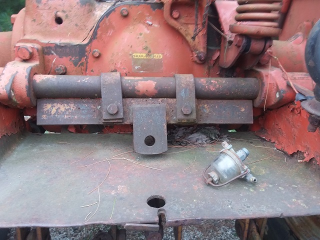

The cupeling on the arm I don't think is for a top link. The top links I have found don't go into a hole. I loosened the bolts to center and also noticed it is welded together! AND the hole is angled to the left and not centered. (if looking straight on). Not sure what he would have used that for? It has a serial number on it too. the other two brackets are also on there perm. I would have to bend them unusable to get them off. Not sure what they are for either. LOL

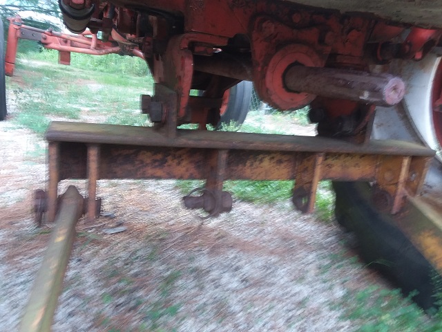

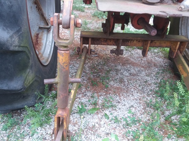

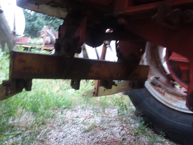

Post Options Post Options   Thanks (0) Thanks(0)   Quote ac fleet Quote  Post ReplyReply Direct Link To This Post Posted: 17 Jul 2019 at 8:56pm
Here are a few pix. of the hitch on one of my 45's. Simple made and strong. I am going to make one for another 45 using this idea, so you should be able to copy it too. thanks; ac fleet
 The coupling is not FOR a top link,  but could be used for it, with a bit of imagination.
 The two brackets on the sides look like a simple strap clamp and if they aren't welded to the rock shaft, could be loosened and moved without damage, or just cut off and pitched in the scrap pile. JMO
That is the exact same 3 pt adapter that I have, I have what I believe is the original top link..what I didn't like,was the drawbar has to be completely removed...

Post Options Post Options   Thanks (0) Thanks(0)   Quote bhaynes Quote  Post ReplyReply Direct Link To This Post Posted: 18 Jul 2019 at 4:00pm
Thanks AC Fleet! This is the back of mine. Looks like it already has some of it? Just need a top link and maybe longer bars at the bottom with the links? (if that makes sense)
 - Sorry for the pictures being sideways. Not sure why the website does that? Anyways....

CTucker - I wonder what that main coupler was used for? Whatever it is, it can slide but is welded shut/together. The hole is angled to the left slightly. Unfortunately, my grandfather isn't in a mindset anymore to remember and everybody else has since passed that had anything to do with the tractor.
My grandfather did say he knew there were still old attachments for the tractor and an old hay trailer in the family barn. I plan taking a road trip (about 2.5hrs drive from my house) and go scavenger hunting. . . :)

Post Options Post Options   Thanks (0) Thanks(0)   Quote ac fleet Quote  Post ReplyReply Direct Link To This Post Posted: 19 Jul 2019 at 9:32am
I think you could re-engineer this design so you could leave the regular drawbar on if you wanted/needed it to stay on. I just use a cross bar in the lift arms for what little I use the regular drawbar on mine.
Also on one of my wd's the 3-pt adapter on it hooks into the snap-coupler. It then goes out in a sort of vee then back to the lift links. I was told it was factory made, BUT I think more like shop made as I never seen one like it before. It also is simple made.
Arms from old ford tractors do work on these without any problem if you can find some of them.
For the most part with some time and a few parts it's not that hard to put something together that will work. thanks; ac fleet
