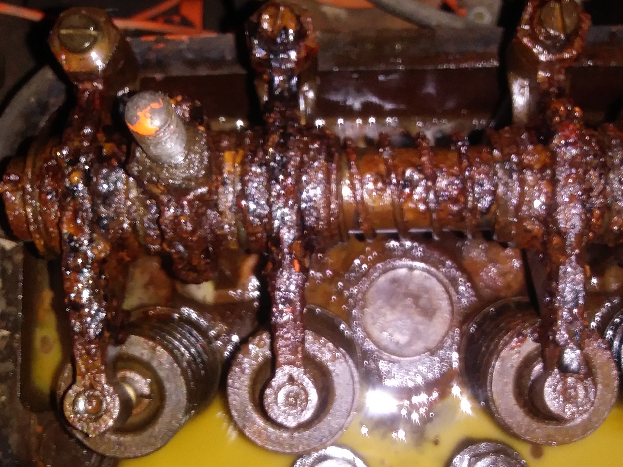

I've got coolant in my engine oil. On the advice of this forum, I took off the valve cover to see if there was a hole in a core plug. If there is a hole in one of the core plugs, it must be very small. I've got two questions.
1) Is there any way to tell for sure if there is a pinhole in a in a core plug, like by poking  around with a thin wire? Or should I just go ahead and replace them all?
2) Taking off the valve cover, there was a lot of rust in there, as shown in the picture. What should I do to address that?

I had a coolant leak in one of those plugs on my B. After wiping the frost plugs clean I was not very easily able to see the tiny pinhole where coolant was leaking. If you take an awl or small screw driver and poke you are likely to find the weak spot. My plugs looked nearly perfect from on top but were so corroded underneath. New plugs cost me $1.00 each. They are easy to replace. It would be best to replace all three. Try and clean up everything under the valve cover as best you can, once the rocker shaft is removed it's much easier. With enough rags around, wiping, scraping, using a paint brush or parts washer brush with some gas or diesel you can get it all looking much better. Keep an eye on how long it takes for the oil pressure to come up as the screen on the oil pump may be very clogged with that same gunk also. If it is very slow building up the oil pressure it is a good thing to remove the oil pan and clean the sludge off the oil pick up screen and out of the bottom of the pan.

Welcome to the forum, Lots of these types of issues on 60 year old tractors! Yes your top end is pretty crusty. Could use a good cleaning. Several areas wher water can leak into the oil. good luck in your search. I agree with Dick, finding the leak before you take the engine apart is the best thing to do. then you know the source and can plan repairs.
