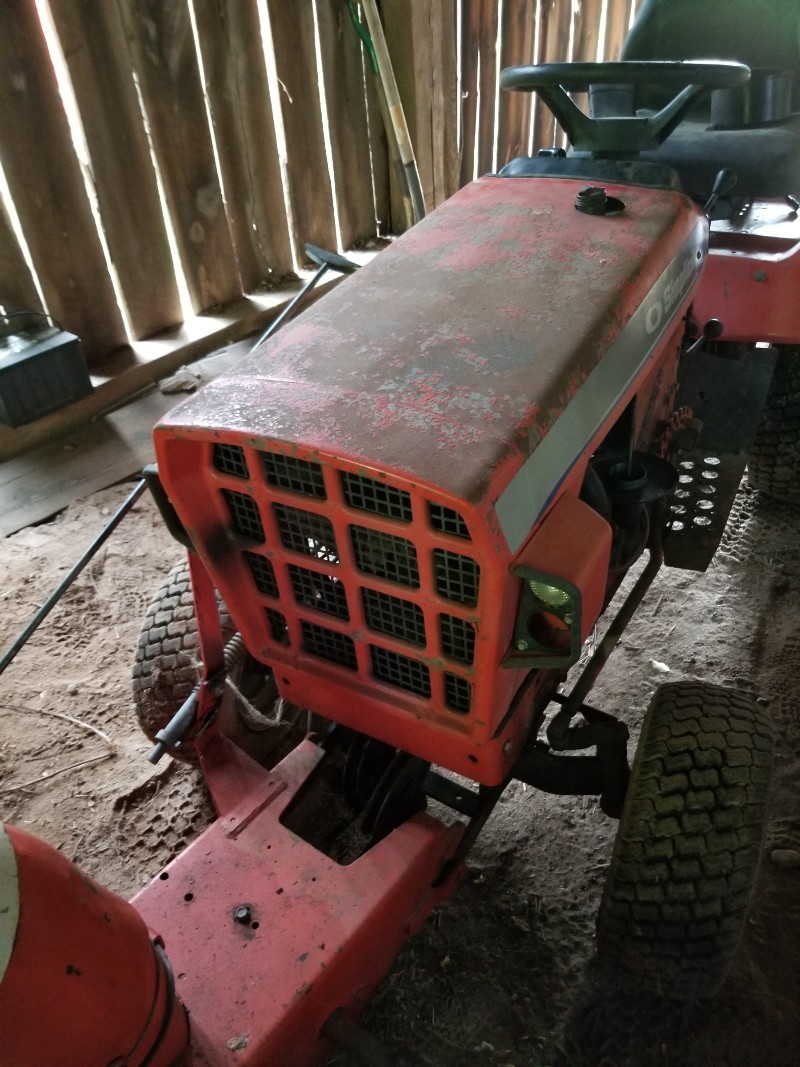

I was given this garden tractor and there are no identification numbers anywhere. Nothing on the tractor and nothing on the motor. It has a Kohler engine in it and what I believe is a starter/generator on it. Electric lift on it too.I'd like to bring it back to life but I need some information on it. It was left on a farm that my brother bought so I can't ask a previous owner anything. Thanks, Joe

Looks like a Simplicity 700 series

Thanks Dave. After looking up images it looks like a 7018. Now to try to get it running again. The wiring is all cobbled together and the spark is weak. I'm sure the carb needs a rebuild. It seems like a well built tractor. I'm looking forward to seeing it work again.

If it is a 7018 it has a Kohler engine and also overhead valves in that version .I have the Allis 718 version I just overhauled my engine. A great place to get parts his I Save tractors. The model of engine is on the very back of the engine.Hope this helps.
