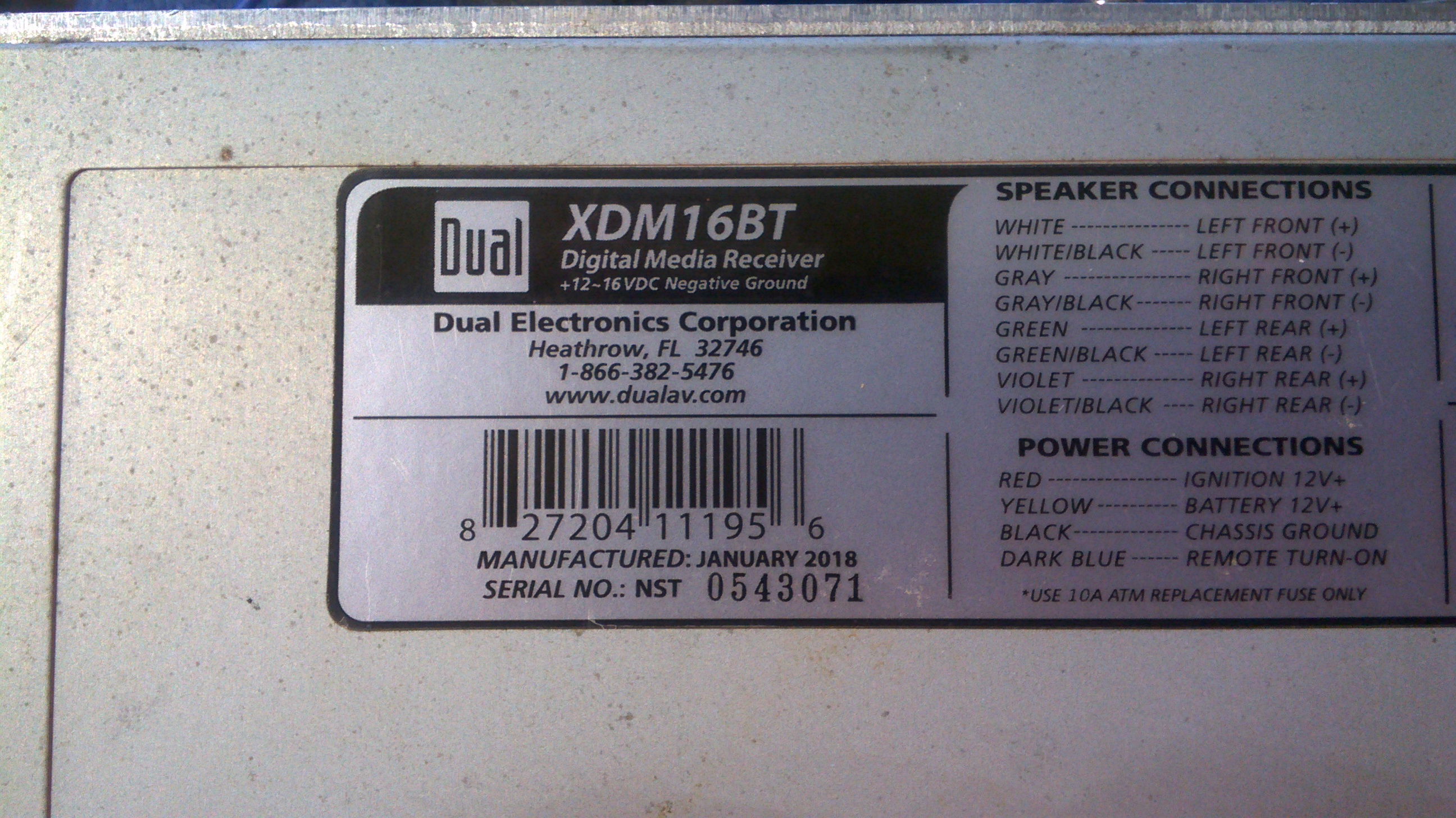

More than you ever wanted to know about a cheap $20.00 receiver that fits a 7000series. I think for $20.00 bucks I'm going to rig and wire it so Ican pull it from inside. When it breaks. It's twenty bucks! Buy another.

I looked at the specs on that radio and it appears to be a 7 inch unit which does not work in my cab. I need about a 6.5 inch width. All of these cheap stereos seem to be 7 inches. So that may not work for you. That guy did a good job of breaking that unit down though.

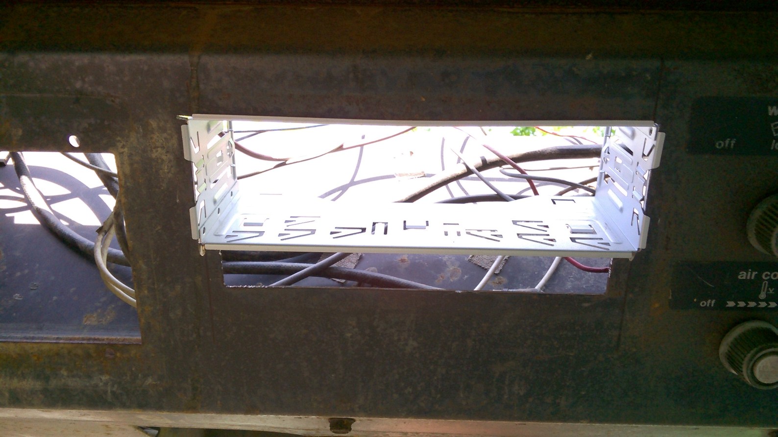

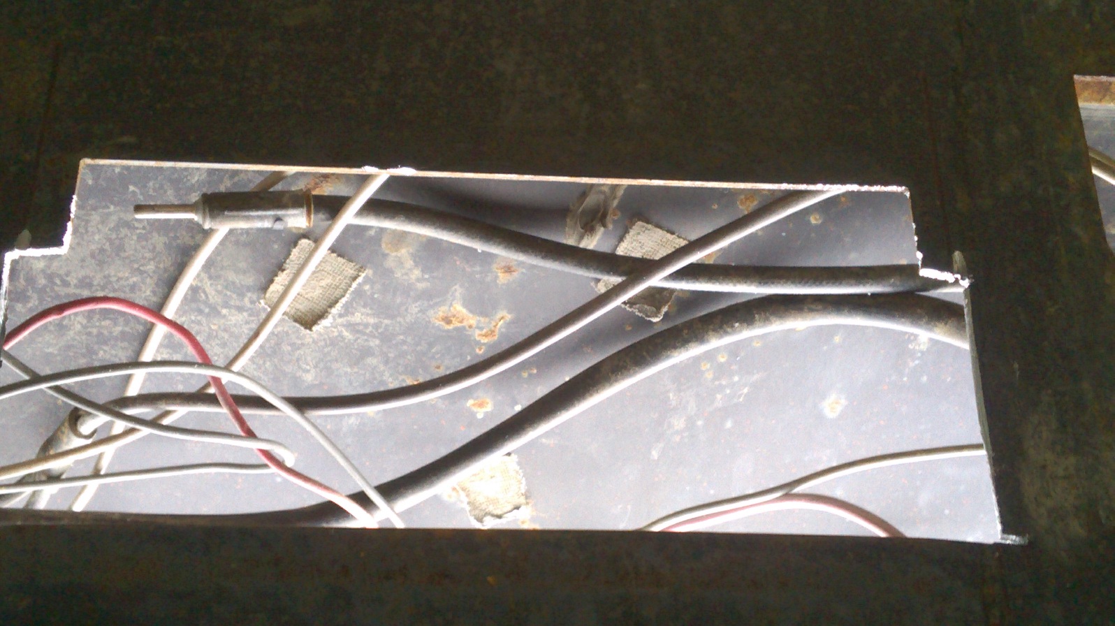

I have one in hand. I have the cab lid off my 7010. Climbed up there and physically checked. It will fit. With room to spare. You have to trim about a 1/4" from each side of factory opening. That's it.
Edited by exSW - 13 May 2019 at 5:38pm
exSW View Drop Down
Joined: 21 Jul 2017
Location: Pennsylvania
Points: 914
Post Options Post Options   Thanks (0) Thanks(0)   Quote exSW Quote  Post ReplyReply Direct Link To This Post Posted: 14 May 2019 at 2:35pm
Not the neatest cuts but a faceplate covers it.

That looks like the same unit I put in mine. I centered it in the opening with the cuts similar to yours. The faceplate did not cover the entire opening so I made a plate from black ABS for a mounting plate. Will try to post a photo but I have to reduce the size and was unsuccessful so far.

I am trying not to cut up my cab to keep it original, but we will see how my stereo turns out.  I can always cut the sides if I don't like it.  I will post pictures when I am done.  I got the LED light on last night and am going to hook it up tonight.  Still worried about not using the relay but we will see.  Like to see your pics though.

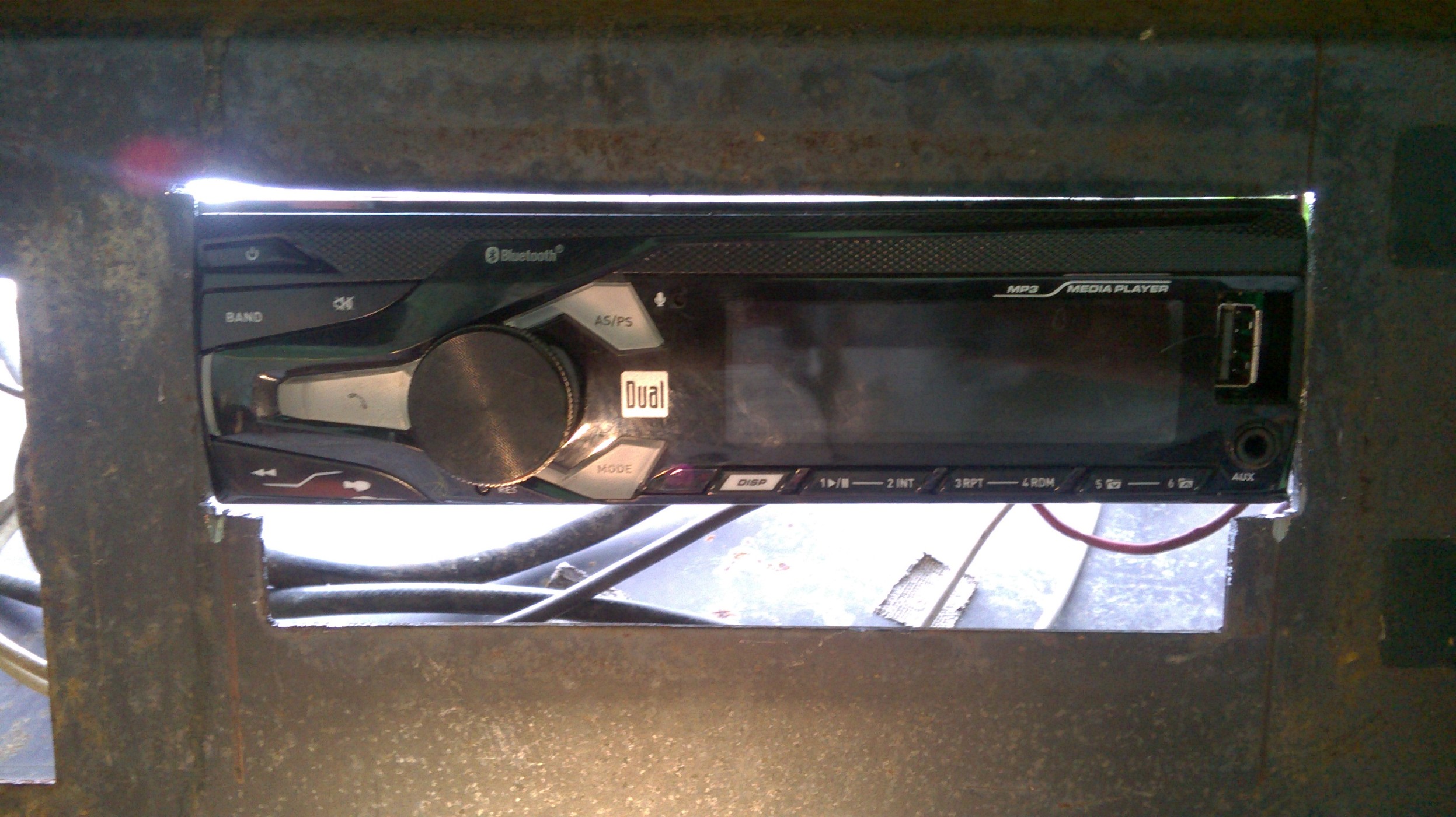

Rough the opening in with a Metalbo. Finish with a file.Friction fit. Have to make a cover plate and figure a way to secure from behind.Resized this pic down to 480 wide. Still abit big.

Fit looks good.  I think you are supposed to bend those tabs out to secure that cage once you are finally ready.
On my 190 cab, I bought some 1/4 inch black plexiglass and made a cover plate out of that.  Easy to cut, drill and form and looks good in my opinion.  You could also go with some thin treadplate.
With that extra space below your radio, you could add some additional features like a usb charging port, light or a voltage indicator and place that into the plexiglass.  You would have to drill some 1 inch round holes in metal and plexiglass.  You could use sheet metal screws to secure the plexiglass to avoid removal of the top in the future.

I'm dry fitting everything for now. The goal is to make it removable from the front. It's a cheap head. Just pull and replace as needed. Not a bad idea on the USB or power ports. I do want to wire some in. But that location would have wires hanging in my face so they'd have to be clipped out of the way. Plus they're never long enough. I was thinking down to the right of the gauge cluster where the monitors are. If I'd used the hole on the right instead of the left for the radio that would have been amuch more viable option.
