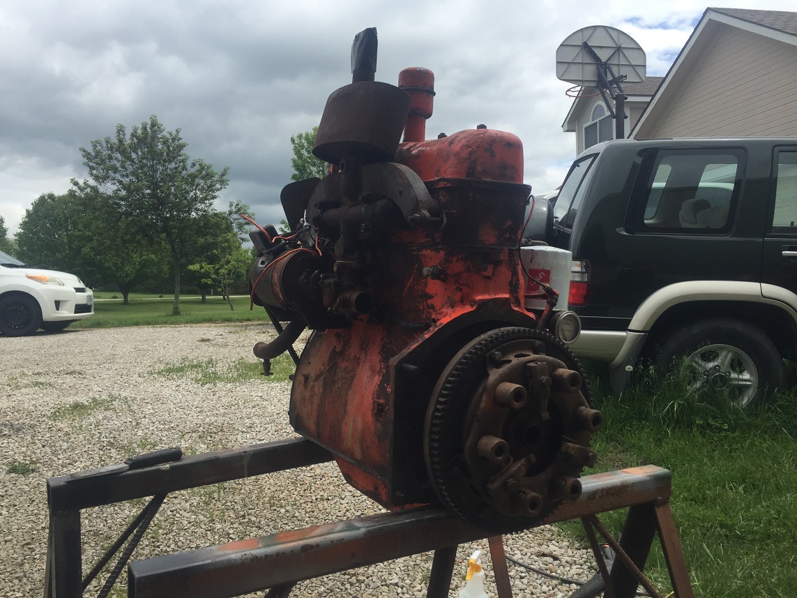

Simpson, my 57 CA, is getting a heart transplant.  This motor popped up a while back, the guy hadn't gotten any offers.  Said it ran strong but came out of a C with a bad rear end and transmission.  Hope it holds up until I get a look at the old one, it developed a serious lower engine knock at Don(MO)'s plow day.

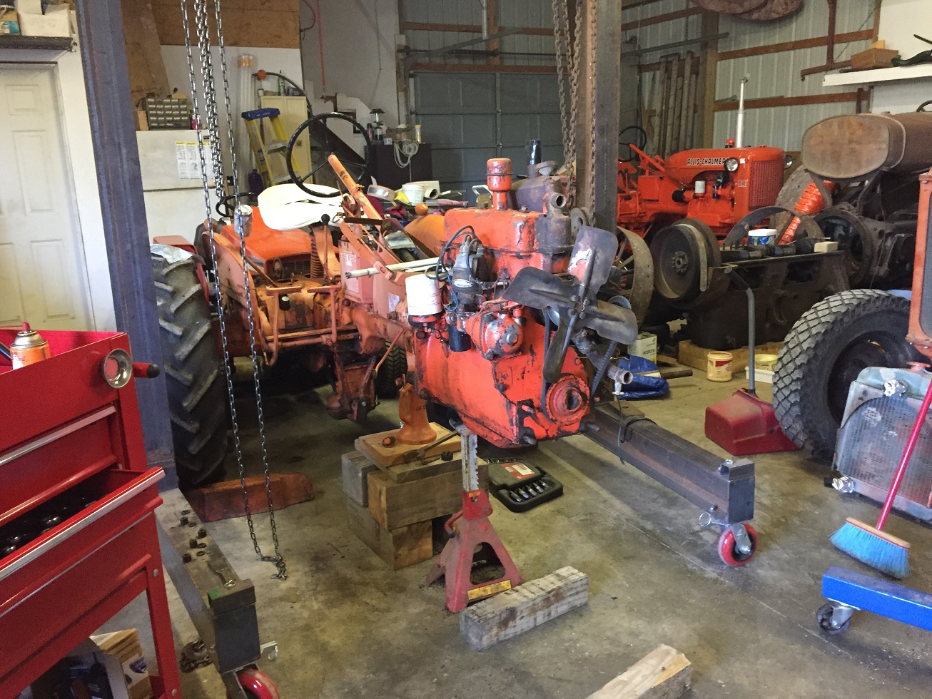

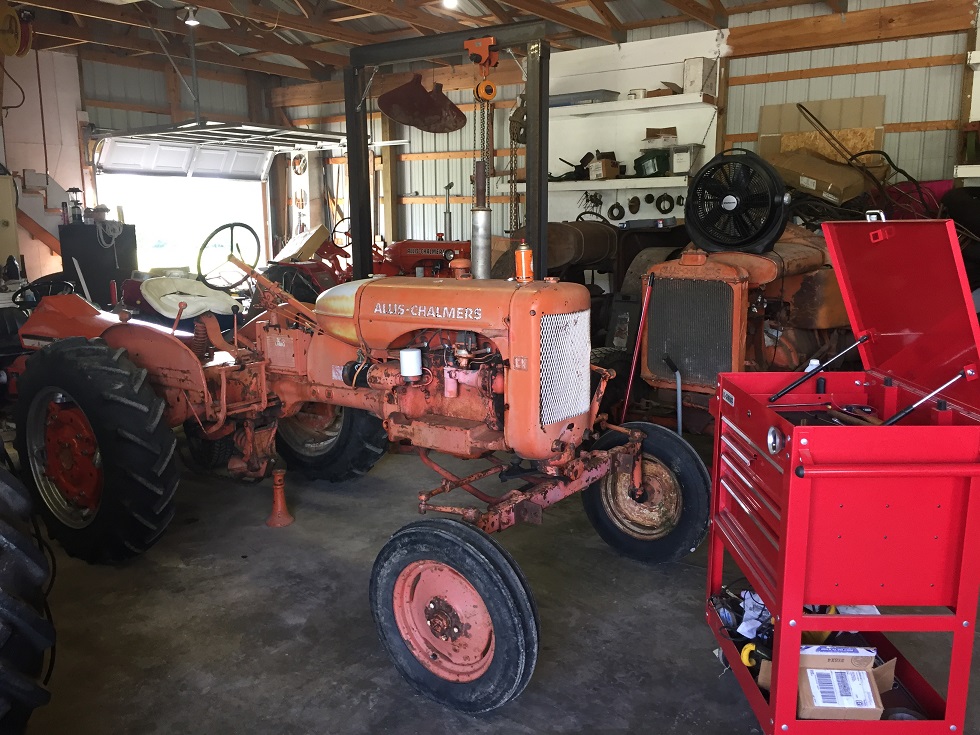

Moved  the U out of sick bay for a bit, and even used the 720 to pull Simpson in to place.

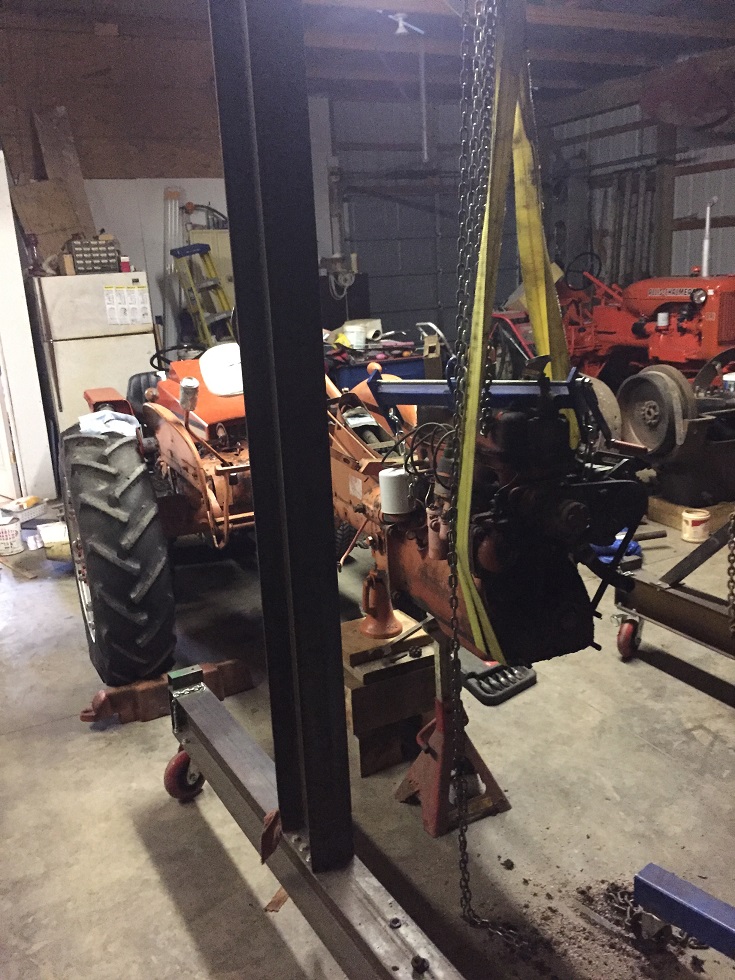

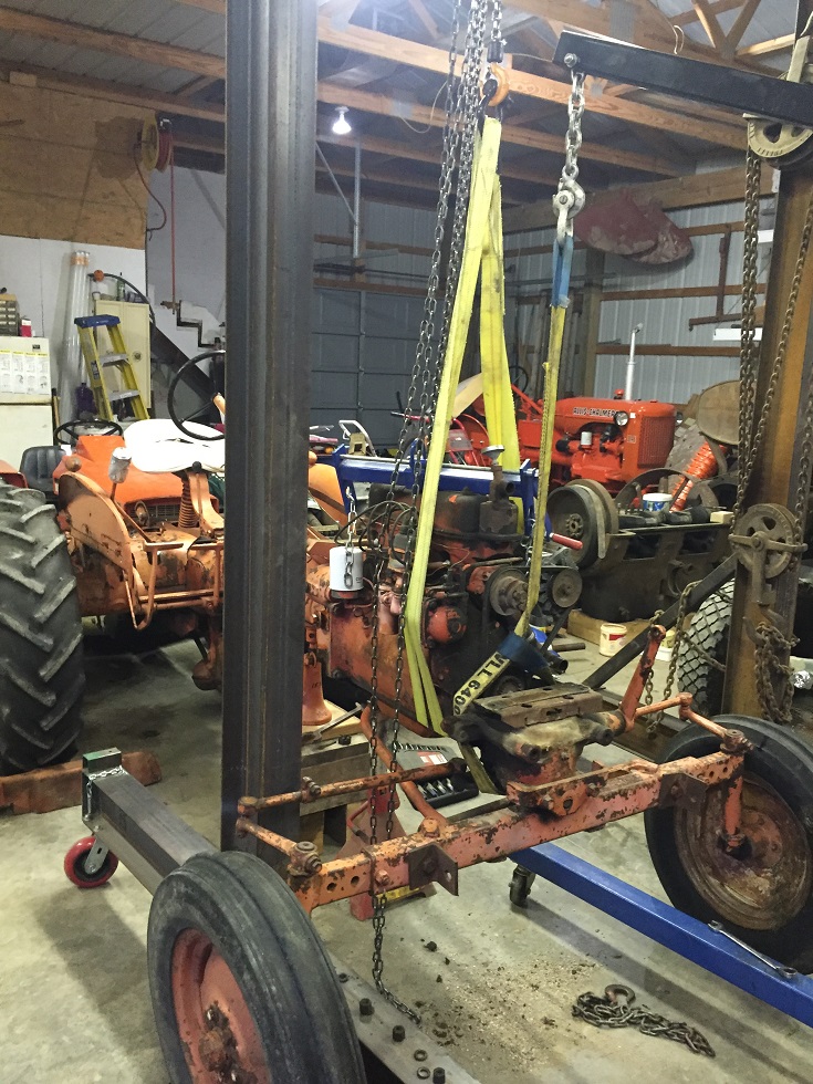

Bolts are broke loose, old motor is ready to come off.  Didn't loose near as much religion as I expected getting the nose off.  Kind of surprising to see how little the front end is held together, things could go to worms in a hurry if a person wasn't careful.
Post Options Post Options   Thanks (0) Thanks(0)   Quote shameless dude Quote  Post ReplyReply Direct Link To This Post Posted: 19 May 2019 at 11:37pm
sooooooo...how are you gonna get the hoist holder I-beams away from the tractor?

The job will go faster if you keep in this  mind the CA is held together with nuts and bolts.

That gantry crane was made special to replace ammonia compressors, it;s narrow to fit between the racks.  It wouldn't fit on the outside of the front tires due to the wheel position locks that somebody mounted on the inside.  The gantry was there just to hold the motor steady, rolled the front axle away with the engine hoist.

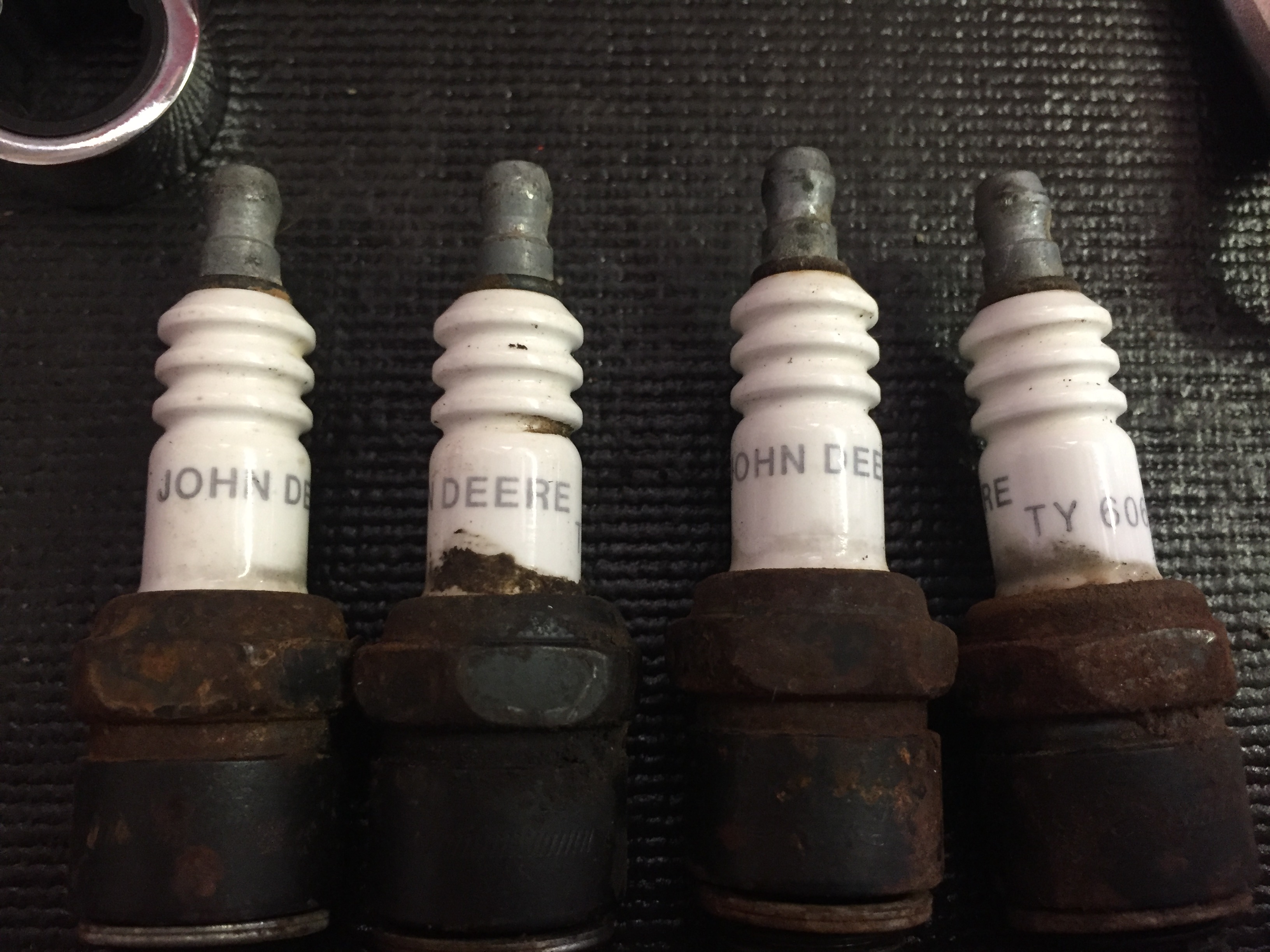

SIMPSON IS ALIVE!!!  But not without a couple of glitches.  I moved the whole governor and housing along with the distributor and installed 12v windings in the generator.  I made the mistake of reading my I&T manual to set the timing, would have worked but it would have put the rotor 180 degrees out from all my other AC tractors so I closed the book and did it the way I've always done it and away she went, a little too fast but I don't think it rolled over a full revolution when she fired.  The head is shaped different on Simpson's new motor and was impeding the governor rod so a couple of bends later, she purrs like a kitten.
I did avoid disaster, pulled the plugs out of the new to me motor and what a horror of a sight, put the kibosh on that real quick.

I'd list them dang things on E bay and they will bring more than a new set of good plugs. lmao

Glad that Simpson is alive and well! Those plugs oughta be illegal......and surely are on an AC forum! LOL

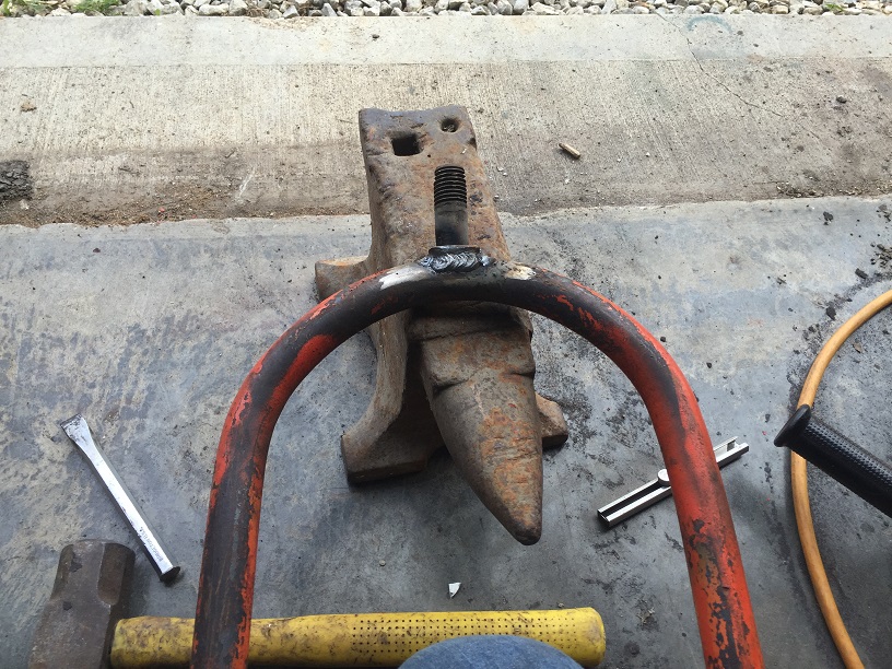

I was going to blame Don(MO), he warned me, "watch that front end, that SOB will flip over on ya."  Sure enough, rolling it across the floor, over it went!  As I was contemplating the easiest way to flip it back over I noticed a couple of issues, #1 someone welded the front back together and not very well, then#2, I noticed it wasn't centered either so tomorrow out comes the hot wrench, grinder and welder.

OK JW I'll take the hit. lol
I'm not going to say I told you so because that's just plane hateful and now you have seen it first hand. lmao   I'm happy it didn't get you when it rolled over!
Points: 8534
Post Options Post Options   Thanks (0) Thanks(0)   Quote Sugarmaker Quote  Post ReplyReply Direct Link To This Post Posted: 30 May 2019 at 7:42am
Good shots of the front on the floor! Yes glad you didn't get injured! Sounds like you have a plan to improve the weld joints and get it correct! You will be happy when its fixed right too! I like that stuff!

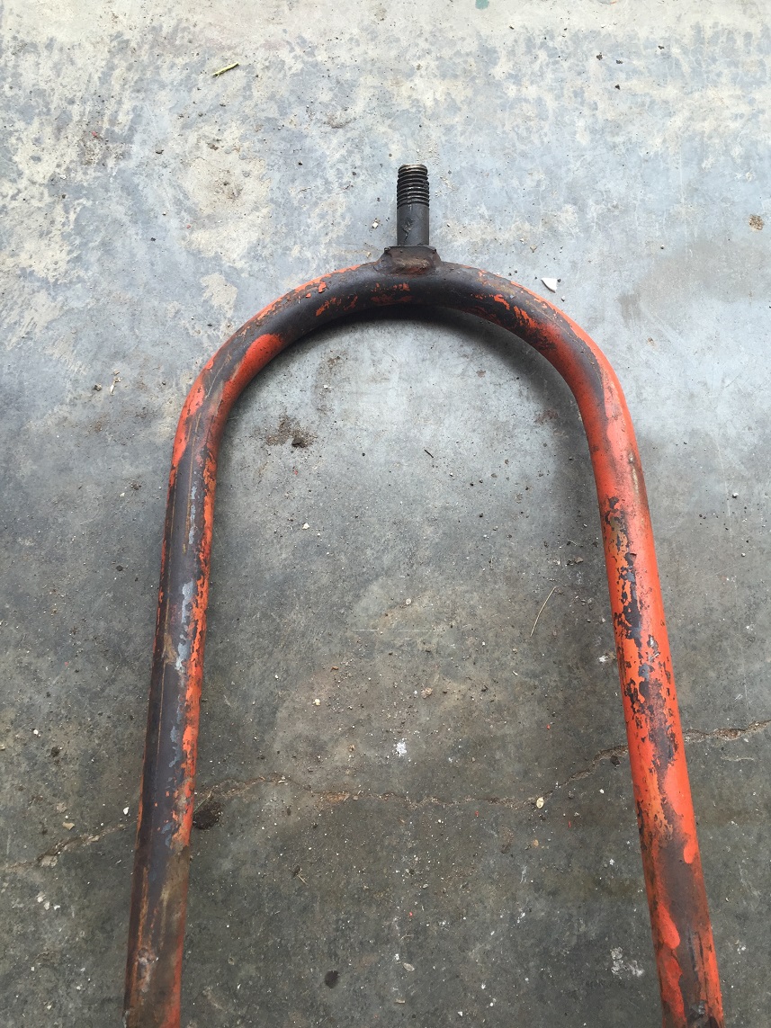

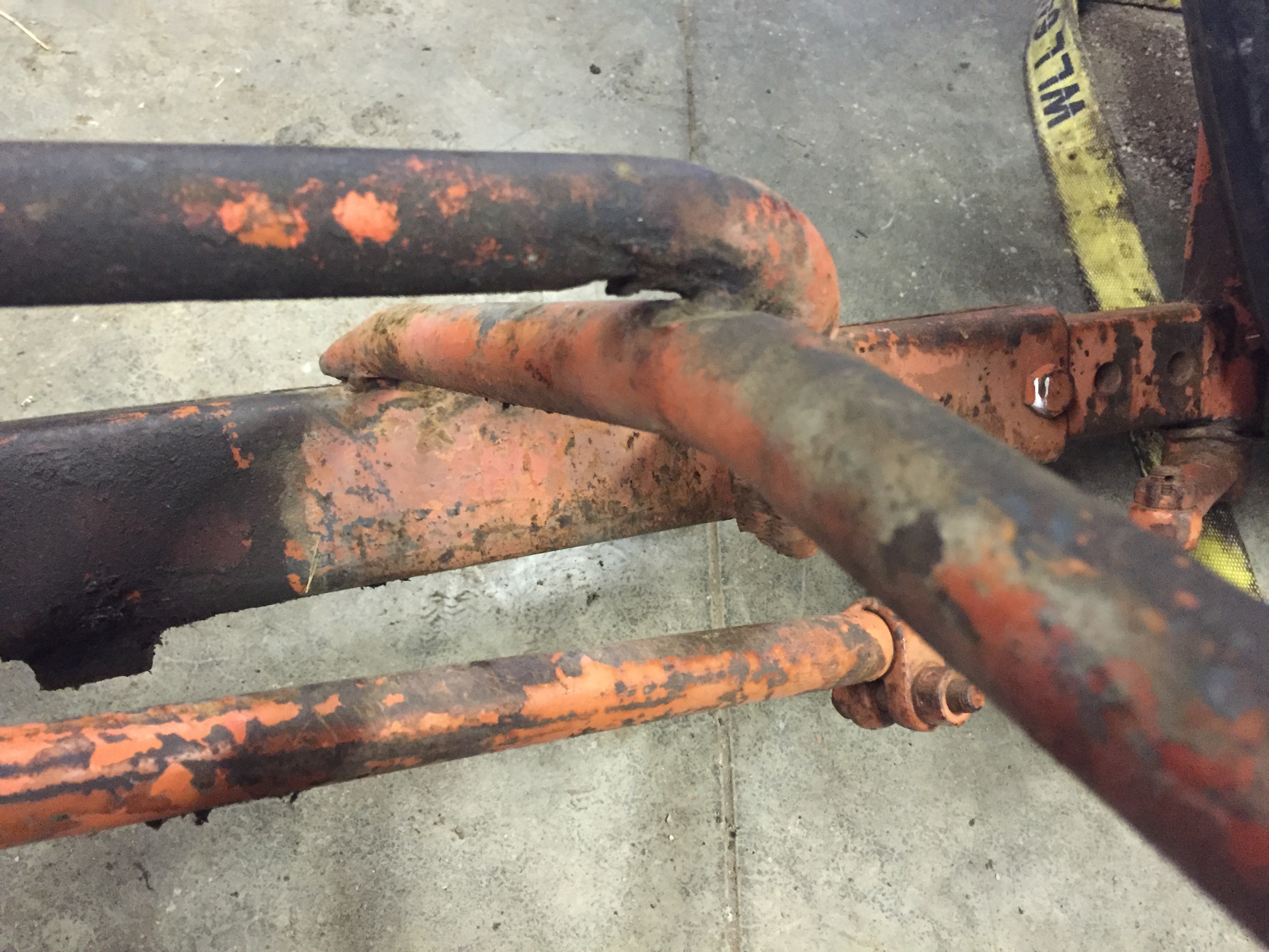

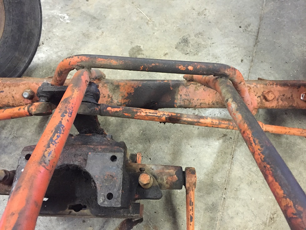

My OCD is why all my tractors aren't done, I think the only cure for it is a coffin.  After taking the front end apart I noticed the pivot bolt was almost a 1/2" off center.  A quick look at the other CA confirmed it wasn't supposed to be that way.  It appears to have alway's been that way, no sign of being moved. Once again, the cut off blade in the grinder, hammer and cole chisel and got it off.  Marked center of both pieces, set everything back under the tractor, aligned and then marked it, took it back out to weld and everything fits like its supposed to.

You had that one of a kind off center wishbone and you took the rare right away!
Looks like a good solid job though.

 Now that looks like something I would do too! Nice work bringing it back to spec!

O-no now you have changed the wheel base so now the left side will be longer than the right side and the tractor will not plant corn in a straight line! lmao

Front end is back under Simpson, neighbor across the street is a welder, I tack welded it in place, added a few c-clamps and drove it over there and I dare say the welds from the factory don't look that good.  Now to install the radiator to see if my repair will hold or if it has to go to the radiator shop.  If it holds I'll post pictures, if it doesn't, . . . . . . . well . . . . . . we'll just pretend it never happened!

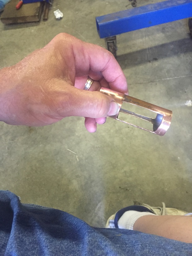

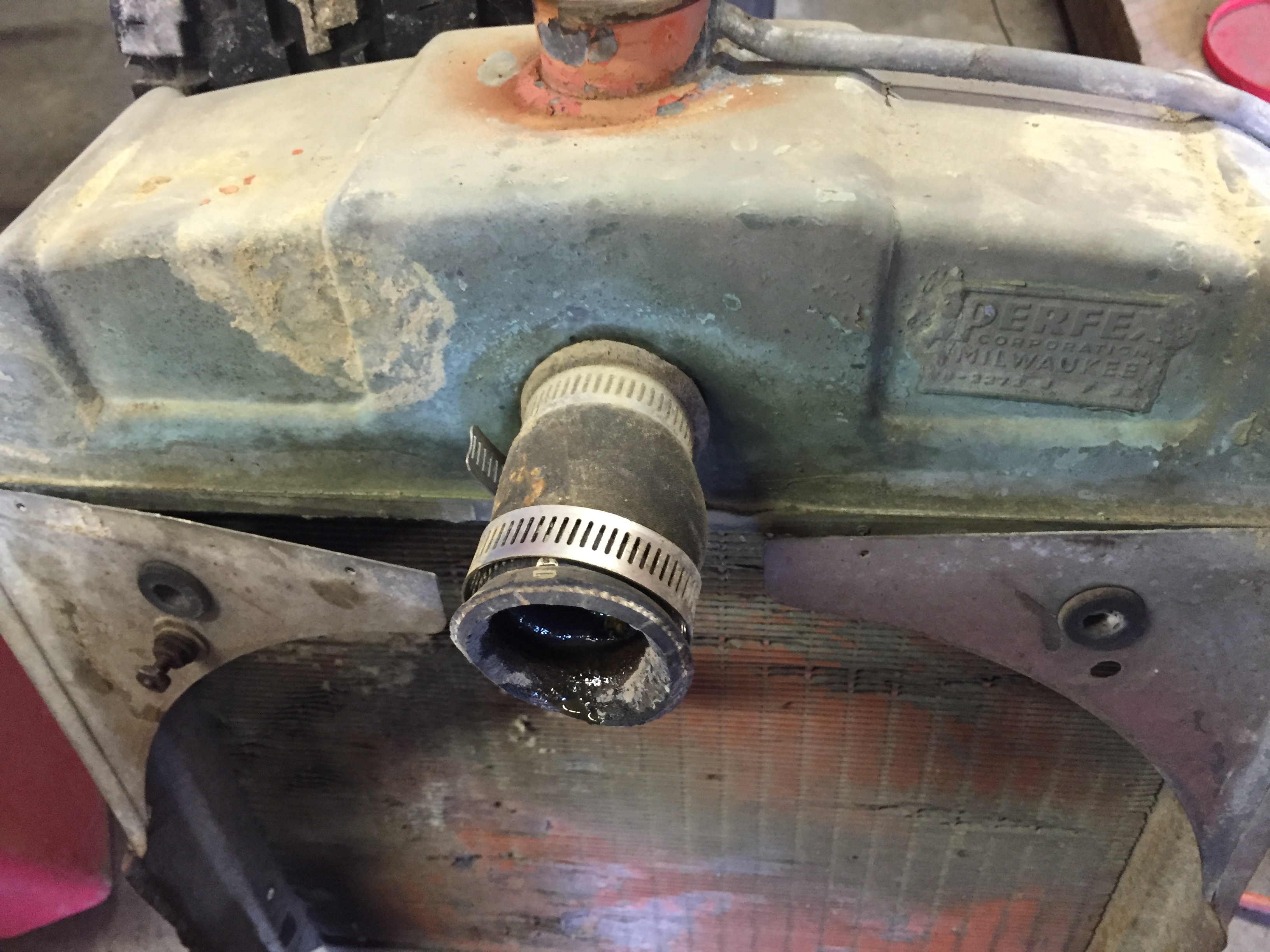

By jumpin jehosaphats my radiator repair worked, finally got around to getting it together tonight and my part worked just fine, however the shaft seal is leaking on the water pump but we're going to give it a few days first.  The baffle slash splash guard or whatever they call it that sits at an angle inside the radiator top tank to keep the water from directly hitting the radiator cap broke loose and had fallen, blocking off about a third of the radiator.  It would slide side to side but covered the entire width of the core so I found a piece of copper pipe the size of the inside diameter of the inlet neck, took my die grinder to it, pushed it inside the and soldered it to the radiator inlet holding the baffle up at the right angle then drilled and screwed it to my newfangled bracket.  Seems to be holding up just fine.  I can only imagine the conversation if and when somebody finds it in the future.
