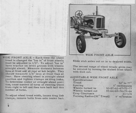

I have a 1948 WD with 3 bolt wide front end, can it be adjusted wider than it is currently or was that only an option on newer models? And if if can be adjusted, how is it done?

If you look closely at the axle, it will be quite obvious that the width can be adjusted
by using the available holes in the axle tube and movable sleeves on the tie rods.
Having said that.....you may have a big task ahead of you if you choose to do it.
Years of rust on the axle stubs and tube as well as the tie rods and sleeves may require the use of some serious heat and hammering to free them.
