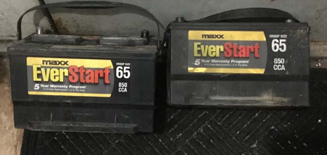

went out to the shed the other day, tried to start the 180D after sitting all winter...fired right off! WooHoo! then went out yesterday to use it, and it would barley turn over and did not start....PffffT! cleaned all the terminals on battery and starter, checked over the cables, put the charger on a bit...nope, won't start. o-k...took the battery out, shows free replacement within 12 months time. this one is 13 months old. went to where I bought it, they tested it, and told me the battery is fine! uh...no...it isn't. told them I wanted to trade this one in for a new one and they did trade me, cost me about $47. for a $99. battery. took it home, topped it off with the charger and put it in, the tractor popped right off running! WooHoo again!

That's why I no longer buy the lead acid battery's. As they go bad I replace with AGM's. I have never had a AGM go bad yet and the oldest one is 20 years old and works like new yet.

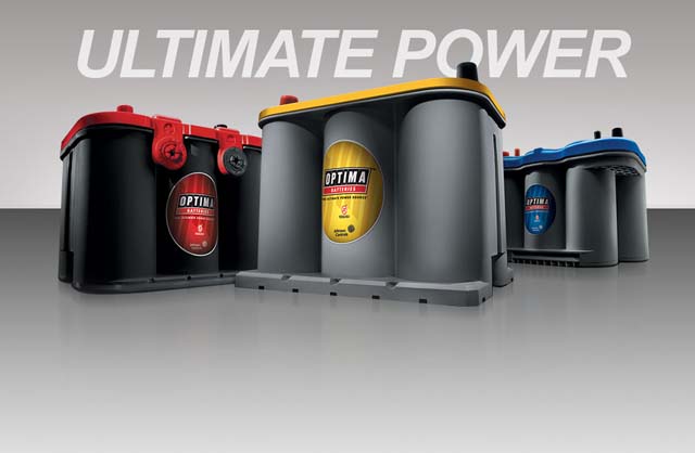

This is what I've been using in everything I own. When the lead battery goes in goes the AGM. They cost a bit more up front but you save money over the long haul.

DennisA, your pic and Gatz's link look like totally different batteries?? Perhaps they are the same though.

Just different brands. The optima's have a look all their own.

Optima is okay. I've heard they're made in Mexico now. Bummer. If you want a really good AGM, get an Odyssey.
https://www.odysseybattery.com
Tractors would be considered as industrial use. Don't confuse industrial use with normal car starting use.
I have two Odysseys. Free shipping from batterymart.com in Virginia.
Advantages of AGM:
1. They are ground shippable. (I think I heard the FEDEX man cussing under his breath, though.)
2. They are rugged. There are sheets of electrolyte-impregnated fiberglass between the plates. Shorted cells are a thing of the past.
3. They are more powerful for their size, compared to standard lead acid batteries.
4. They can sit idle for a year and not lose any significant charge. (Personally I'd throw a charger on the battery every few months if sitting over the winter.)
5. They charge faster than conventional lead acid batteries.

thanks Dennis, I may try a few of them, like said, could be cheaper in the long run if used in applications where they sit over winter time.
Post Options Post Options   Thanks (0) Thanks(0)   Quote shameless dude Quote  Post ReplyReply Direct Link To This Post Posted: 28 Apr 2019 at 1:58pm
I think the "ever start" batteries are made in India.

AGM for me too. I don't waste money on Optima's anymore, the quality has declined since they first came out 25 years ago. Mostly Dekas for me.

The problem with Optima is they were bought out by Johnson Controls and production was shifted to Mexico. From what I've heard the quality is hit and miss. Interstate Battery also gets some of their batteries from Mexico. The quality is hit and miss there too. Some Interstates are excellent, some not so much. I've heard good things about Dekas. I prefer Odysseys because I know they are American made.

Bought a Everstart battery at Wally world a few weeks ago . It was made in Mexico . Hope it lasts a few years. Thanks

I hope your wrong because I have 11 in use right now. Time will tell.
