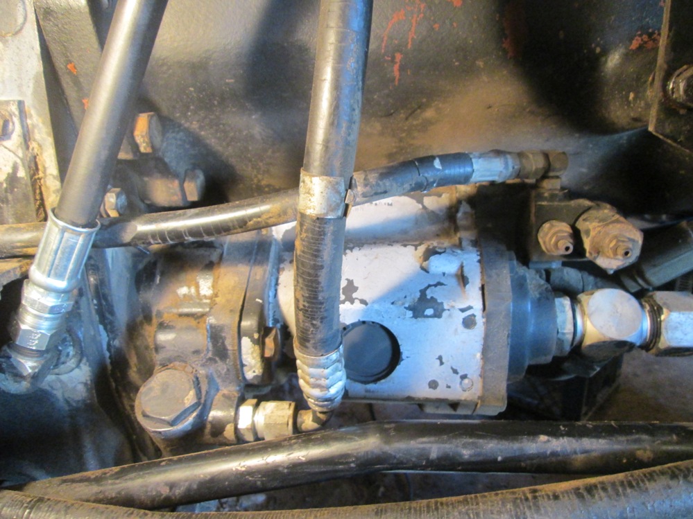

Is it possible for anyone to post a pic of the compensator.
It seems a very common adjustment problem as these tractors get older...

Post Options Post Options   Thanks (0) Thanks(0)   Quote Lynn Marshall Quote  Post ReplyReply Direct Link To This Post Posted: 20 Mar 2019 at 7:58pm
Compensator is on the front of the piston pump. This one is screw adjusted.

Post Options Post Options   Thanks (0) Thanks(0)   Quote LB0442 Quote  Post ReplyReply Direct Link To This Post Posted: 20 Mar 2019 at 8:17pm
Here is a picture of one that is adjusted with shims.

Post Options Post Options   Thanks (0) Thanks(0)   Quote Ron(AB) Quote  Post ReplyReply Direct Link To This Post Posted: 20 Mar 2019 at 10:34pm
You guys are fantastic!
Thank you from me and everyone else who looked at those pics.
