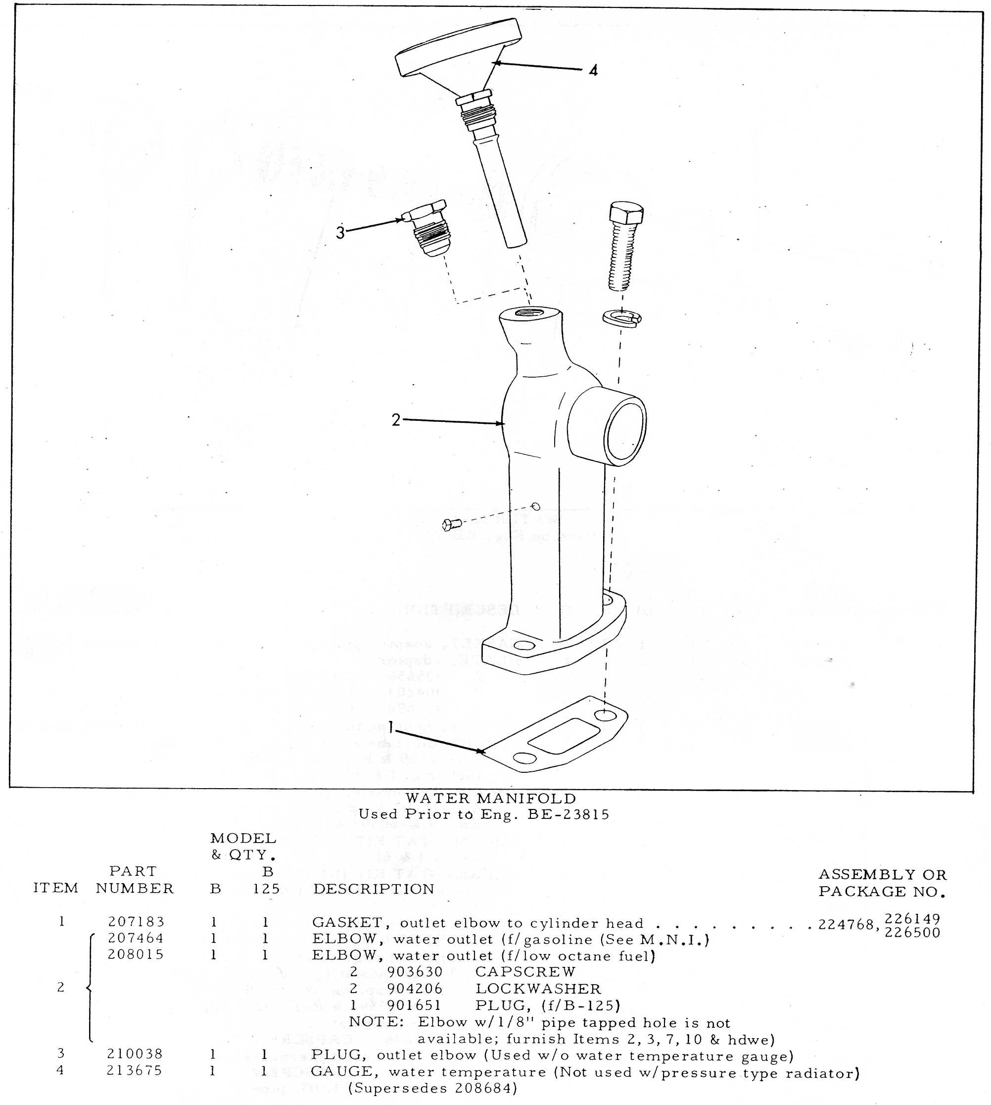

I found a complete BE engine to rebuild for my 39B. It has a water manifold  outlet elbow cast like this drawing except the casting is not drilled and threaded  for Temperature Gauge or a plug to be used without  a temp gauge.
     The part number for the elbow used for gas is 207454. Part number for untapped elbow is unknown.  My radiator is non presureized . I have a hole in my hood for a gauge. Anybody wish to trade even your tapped casting for my same casting without it being drilled and tapped for the gauge.  My guess mine is for a BE engine  prior to 23815

Why not drill and tap yours?

OK, I have to ask a dumb question......
Why isn't it tapped ? Is it for a 'special' engine setup ??

For the RC in the 1939 timeframe, the un-tapped was for Gas engines and tapped was for Kerosene - only kerosene had the temp gauge. I believe the B was the same but I don’t have my info handy.. I suspect the B was the same. Later, all were tapped for a gauge.

Jay
    My thoughts exactly.
I just mailed out a elbow for a 38B not shown in parts manual. It is a straight up and out for use without a gauge. The casting is like the drawing less the knob above the outlet hole where the gauge threads in .    When Gary and I restored B-751 it came with a straight up and out elbow and no hole in the hood for a temp gauge.

Never just get in a rush to judgement of what water neck is correct without checking Engine Numbers FIRST. Mine after looking is BE-28198 G. Well above the change to water necks WITH a Thermostat.  My parts book says that engine number for the change is BE-23815.
     I grabbed one WITH a Thermostat off the shelf and took it apart and cleaned it up real good. I just need two new long mounting bolts that aren't almost rusted in two. The adapter plate is still OK enough to use..

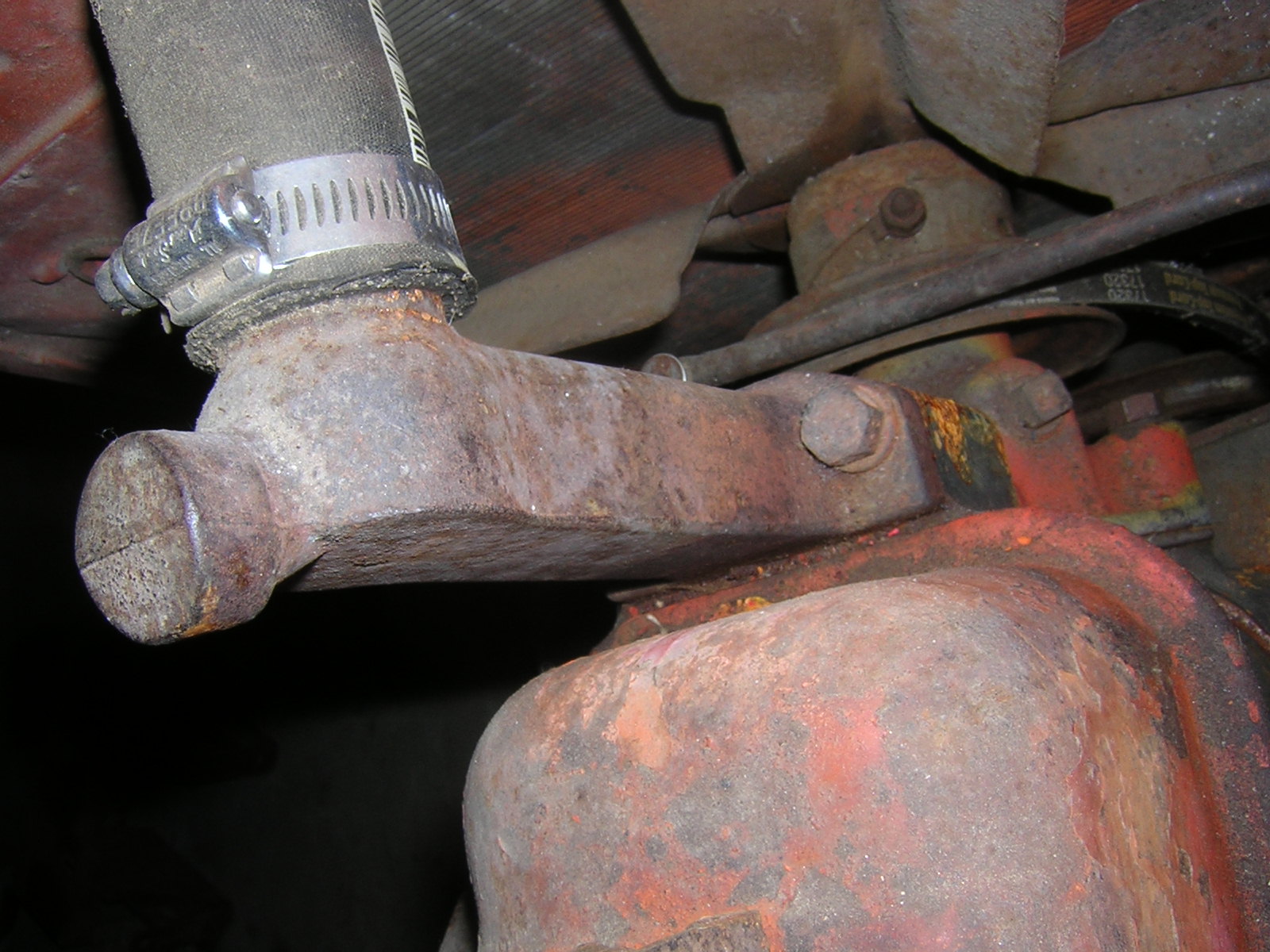

     Now. Who would have a use for the early style elbow we talked about being untapped for a temp gauge?  Maybe Someone restoring a very early 38-B that when new did not have a temp gauge.    Picture Next.   Anyone seen one exactly like this .   Only one I ever ran across for sure.     Ken

from my understanding no 1938 B's had a gauge, I am looking for a water neck for my 38 B without gauge provisions!

      Make me a offer by a PM in US Dollars Cash for the water neck pictured. No Canadian Money order please.
      I have no proof that the water neck I have pictured was used on 1938 BE engines.  I had another without the knob on top that I know was used on B#751 .   However it should work just fine without needing to use a plug
