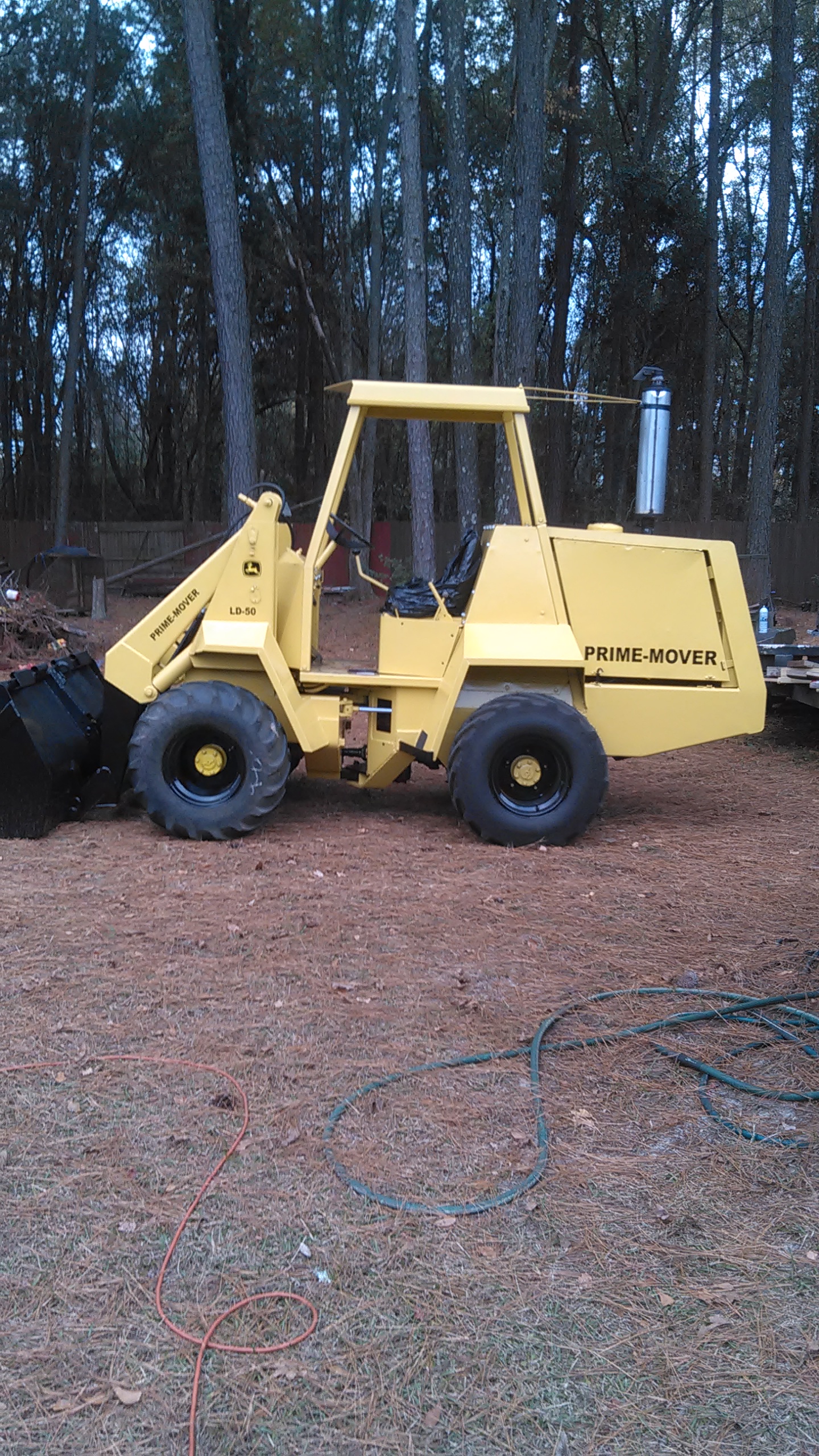

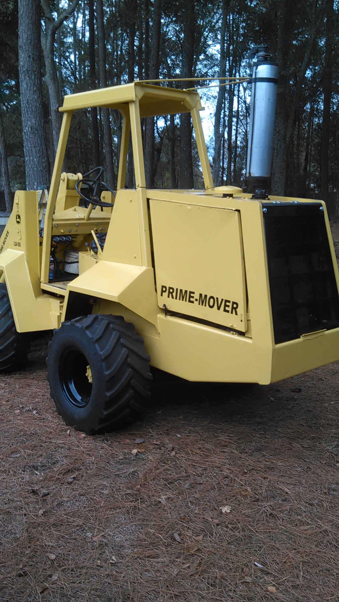

I have a friend that would up with this machine included in a real estate deal and he has no idea what it is.  I haven't seen anything other than the picture below.
He claims the engine appears to be a John Deere but there are no manufacturer nameplates he can find on the machine.  It has a problem with the hydraulics and he's trying to figure out where to find parts.
Any help would be appreciated.

I think it's a Prime Mover.  They used JD engines.  Don't think the company is still in business but there was one on EBay not long ago.  Search "Wheel loaders"
Just looked it up, none on Ebay but Googled Prime Mover,  I'm sure that's what it is.  Found out they were made by John Deere for the Prime Mover company.  Seem to be good machines and most parts are still available from the manufacturers.

I think JohnCO got it. Apparently they were also under the Lull name at one time. Here is a link to a LD50 on craigslist, it looks right other than not having a full cab.    https://cnj.craigslist.org/hvo/d/hellertown-wheel-loader-small-4x4/6817668968.html .   Minnpar has Parts Manuals in their on line manuals, so they may be a resource.

John's right. Here's one just like it.

I agree - - it’s a Lull / Prime Mover.

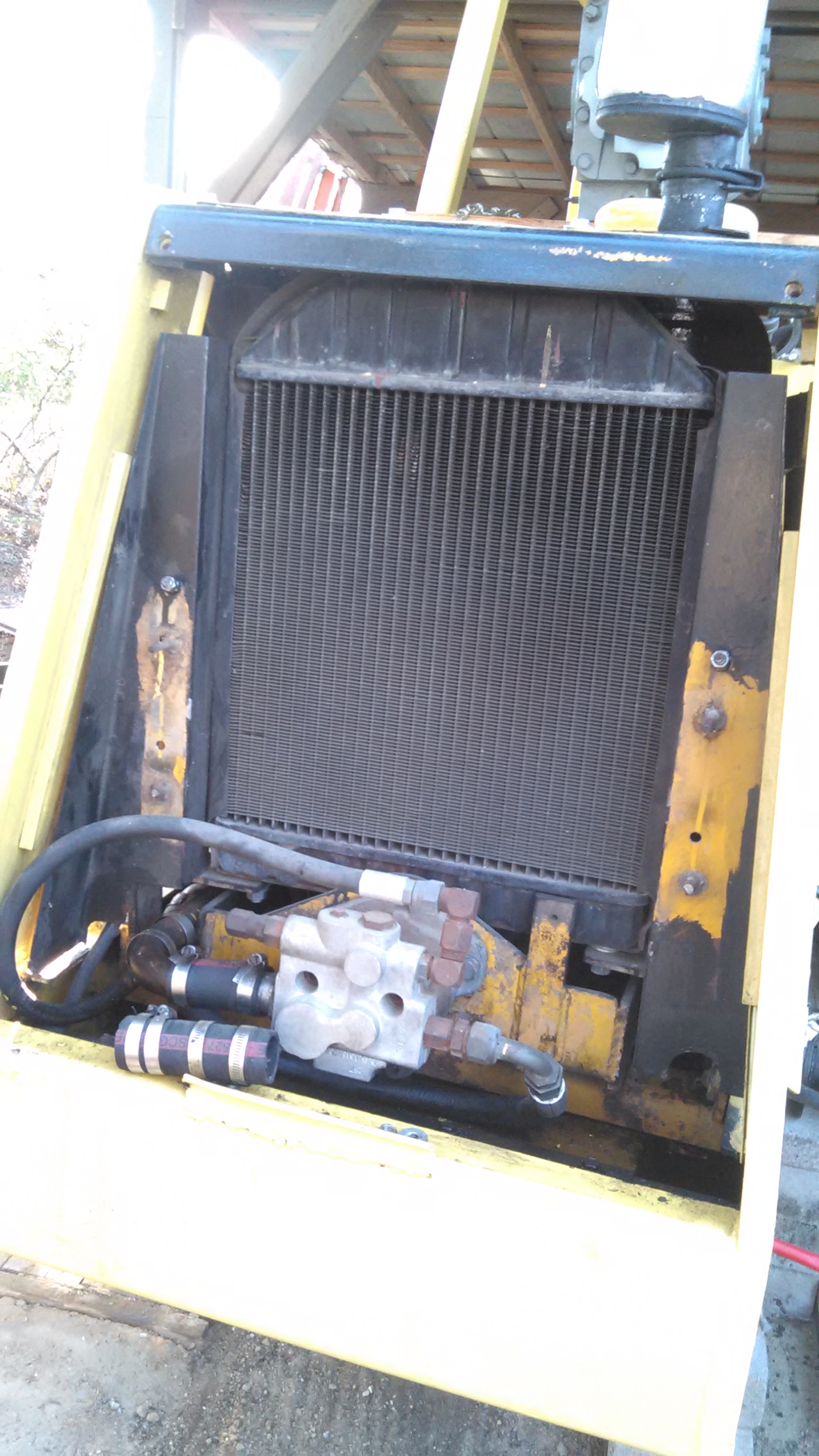

It's a Prime Mover LD-50. I have one that I use on my property. Mine has the Deere 3164d engine. The company is out of business, but the good thing is the Prime Mover company didn't actually make the mechanical parts and many of the parts were used on other machines. So most of the parts can easily be found.
You didn't specify the problem with the hydraulics. If the hydraulic pump itself is bad (located under the radiator and oil cooler) then nothing will work. If the pump is making a constant loud noise, check the spline coupling located on the shaft connected to the pump. The splines on the coupling become worn down to the point where it just spins on the shaft and doesn't turn the pump. This is what I'm repairing on mine as we speak. I'm also replacing the rubber coupling connected to the crankshaft while I have it apart. Both parts are available. If the spline coupling isn't the problem and if the pump itself is bad, that's probably the hardest thing to find for this machine. It's a priority valve gear pump (CCR) made by Tyrone Hydraulics which is no longer in business. I done some searching and found one that appears identical to the one on the machine and made by Parker mfg. It can be found in the Parker Catalog (Catalog # HYP9-1000/US) called the "PVP 16 series" with a 13 spline shaft (Pages 12 and 13)
If the problem is with the hydrostatic pump( located under the hydraulic tank), the first signs of problems is when the machine continues to roll when the foot pedals are released, which is very dangerous. This has something to do with the neutral control switch and is usually a sign the pump is beginning to fail. (my own experience).  Eventually over time the machine will stop working in either forward or reverse which requires replacement of the entire pump. The pump is made by Sundstrand Sauer, model # 22-2069. The hydrostatic motor connected to the pump is probably OK (Sundstrand Sauer 22-3077).  When replacing the hydrostatic pump, the oil cooler must be replaced as well along with flushing out the entire hydraulic system (all the hoses, tank strainer, etc) to cover the warranty on the pump. It's labor intensive, but not bad considering how much is saved when doing the work yourself.
The last issue would have to be with the bucket control valve which can easily be rebuilt at a local hydraulic shop. I have a lot of other information for these machines if anyone has any questions. I've saved a ton of money doing all the work myself and it's a lot cheaper than buying a new one. The first thing that needs to be done when buying one of these machines is a total hydraulic system flush because you have no idea what type of fluid has been used in it. With hydrostatic pumps, it's important that only high quality premium tractor fluid be used, not the cheaper low quality tractor fluid.

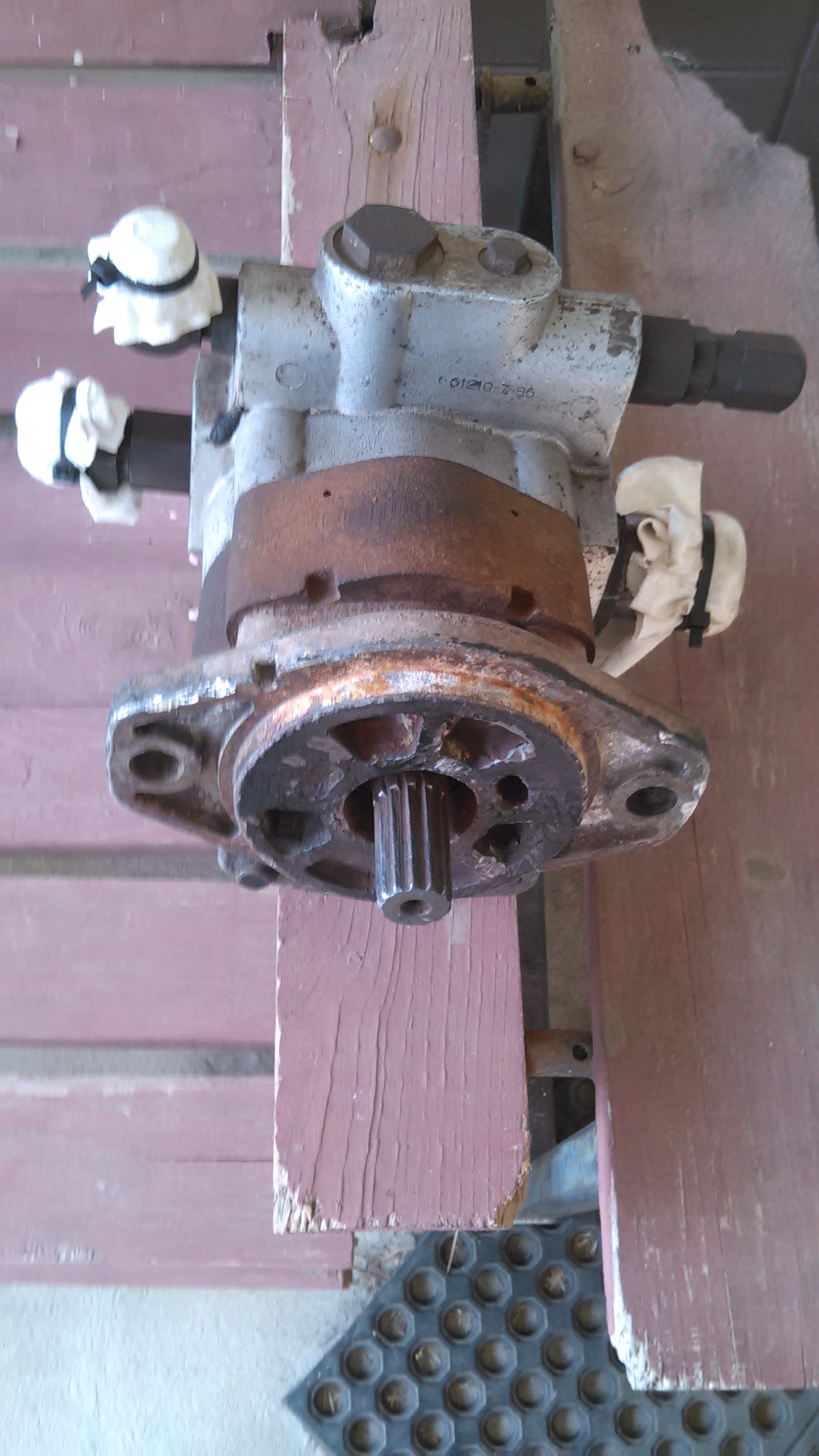

Does your friend still have the Prime Mover LD50 loader??? I'm in dire need of the make and model number of the hydraulic pump located under the radiator. The tag on my pump is missing. The model number is a metal tag on top of the pump. The rear grill on the back of the machine has to be removed to view it. These are obsolete pumps and I'm having a hard time finding one. I can't find anyone who owns one of these loaders.

It would be much appreciated if he can provide this for me and I can return the favor if he ever needs any info on other parts on his machine. There should be a metal tag on top of the pump. If I can find this pump, I can provide him the info on where to get one if he ever needs one himself. In fact I can provide a LOT of other info on this machine and where to get other parts if he needs it. These machines being as rare as they are needs as much information shared about them as possible. There is zero history about them on the internet or the former company that made them. I will be posting some more pictures of my machine soon on this forum. Stay tuned.

I'm betting that if you take that pump to a good hydraulic shop, they can tell you what it is and what will replace it.  You can probably find one on the internet cheaper but maybe it's worth supporting a local business.
I've been looking for a pump for an IHC 3200 skid steer loader but haven't taken the time to search it out, it mounts to the pump drive housing and has a tapered shaft with a gear on it, kind of different.  I heard whoever built them made them for MF too.

Post Options Post Options   Thanks (0) Thanks(0)   Quote DaveKamp Quote  Post ReplyReply Direct Link To This Post Posted: 17 Aug 2019 at 3:51pm
A 'priority' pump is an ordinary hydraulic pump with a 'priority flow' valve.
The priority flow function is simple-  if the pump is running in any circumstance where it's demand is exceeded, a selector valve shifts to make certain that the 'priority output' port gets full flow, and the 'secondary' port is the one that sees limitation.
The PRIORITY function is typically used for steering circuits, with the secondary going to bucket control, etc., so that you're not stuck running a machine that has limited steering.
I used a priority pump on my homemade front end loader tractor, and it's convenient in packaging, but I could have simply installed a priority flow control valve downstream of the main pump output (this is how they USED to be made)... just so happens I found a perfect solution (integrated priority) at one of our favorite surplus retailers... so I didn't HAVE to.
on  a machine like this, a good option is to replace the pump with a standard, of similar or slightly greater displacement, and install a priority valve just past the output, mounted at some safe, yet convenient location inside the chassis.  that appears to be a C-face pump, should not be hard at all to match.

Yes, I've taken it the local Hydraulic shop and the old man there said it appears to be an obsolete Tyrone pump, but Parker has one that looks exactly like it in an older catalog. So if it's not a stocked item I'm sure they could build one....with a hefty price tag. The pump still works but the spline shaft is worn so the spline coupling that fits on the shaft is loose. Which means it will soon stop working. The problem is the repair parts including the seals, pressure plates, etc. all come as a kit which is no longer available for this pump. So for the time being I came up with a quick fix temporary solution.(which I've done in the past on something else) I purchased a new spline coupling and drilled and tapped 3 equally spaced 1/4-20 holes around the coupling. I used 1/4-20 stainless steel set screws and this keeps the coupling completely tight against the worn out spline shaft. I've been using it for a month now with no problem. But this is only a quick fix. Once I get another pump then I'll feel safer. I've searched high and low on e-bay and found 2 that looks exactly like it made by Parker.(called a PVP-16 priority valve pump). But Parker makes like 8 different versions. That's why I need the exact model number of the pump I have. The last thing I want to do is order something that doesn't work.

Parker hydraulics has this style of pump listed as "PVP-16 priority valve gear pumps" but they have several different models. Which is why I need to know exactly what model I have so it can be cross referenced. This is the only item on this machine I've had trouble finding. The hydrostatic moter, hydrostatic pump, steering pump and other items are available. I'll will be listing everything I've bought along with part numbers on this board in the future in case someone else runs across one of these rare machines.
