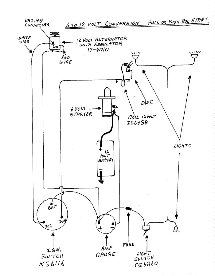

I did a 12 volt conversion on my wd45 this week and when I tried it out today everything worked fine except for the tractor would not quit running when the ignition swith was turned off.  I wired in a diode just like I was told.  It was a 50 amp diode in the wire between the the ignition switch and the internal voltage regulator on the alternator.  I know I had the cathode turned the right way too because I tried it both ways.  If anyone could help me with this problem I would greatly appreciate it.  Thanks.
This is how my tractor is currently wired.  As i said above I used a dioe instead of the warning light.
Location: Prairie City Ia
Points: 10508
Post Options Post Options   Thanks (0) Thanks(0)   Quote Brian Jasper co. Ia Quote  Post ReplyReply Direct Link To This Post Posted: 22 Jul 2010 at 9:33pm
Where did you get that schematic? I'm pretty sure the wires on the alternator are backwards. Switch them around and see what happens.

unless the you have the terminals mixed up on the ign. switch. the voltage has to be coming from the alt. disconnect the lead from the alt. and see if it still does it. i think you can get away with not hooking up that wire off of the alt. as it is excited by the wire hooked to the bat. the light was to tell if it was charging or not. hopes this makes sense.

No, it doesn't work that way. It uses one wire to sense voltage. The other wire with the bulb excites, or turns the alternator "on".  When the alternator is not working, it provides a ground path for the bulb. Since the bulb is connected to the + side of the ign switch, it comes on. When the alternator starts working, the bulb terminal switches from ground to B+. Two B+'s equal bulb not lit. That's why a diode is needed so the alternator doesn't back feed the ignition system on an old tractor. The regulator looks for a B+ signal in the bulb circuit to turn on the rotor circuit and begin charging. Once the charge process has begun, the alternator is self sufficient and will continue to operate as long as the rotor is turning even if the bulb circuit were removed.

Looks to me like the alternator feeds directly to the coil.  Try switching the wire to the other side of the switch

if that were true that the b+ (or no.1 terminal on this diagram) switched from ground to hot, which it does, then the tractor would stay running due to voltage coming through the bulb and feeding the coil. i have wired up tractors this way but cannot for the life of me now figure out how they shut off with voltage coming through the lite. i need to find my diagram to see what the heck i did.

Been a while since I did one and memory is not what it should be but wiring looks OK and the only way it can backfeed the coil is through the diode, which means it is bad. This can be checked by removing it and placing a test light in that circuit. I have never been able to figure out the diode deal, a light bulb and socket is cheaper to free (if you keep some junk around) self diagnostic, and cannot back feed. For those who dont want to look at an idiot light you simply hide it.
Dads dozer the reason the bulb wont feed the coil is the volage on the ground side of filiment (in this case the side towards the coil with the switch shut off) HAS to be zero or you have what is known as a short circuit. Which ever side of  the filiment is not being fed (which changes in the case of an idiot light depending on if charging or not and if the switch is on or off, this is how the idiot light circuit works) has zero voltage or same potential as the ground circuit.

Diagram is correct,used it a few times.
The diode's cathode ( the banded end, ----->|----- ) goes to the alternator pin 1.
I use 100V 10A diodes ( have a pile of them here...).
I've also tied the alt. pin 1 to the ACC terminal and not needed the diode, but that depends on the ignition switch. Made for simpler wiring...

Diode will work fine. A 1 amp/50V diode will do the job yer' looking for. Also, a 3.0 ohm coil would be a better choice than a ballast resistor that's shown in the diagram, being Mother Nature plays havoc with the ballast resistors. If you intend on using an Ammeter, choose the 60/60 sweep version in lieu of the OEM 20/20. Most "SI" series Alternators can put out way more amperage than that 20/20 can handle if a problem should occur on board somewhere, which makes it the weak link in the system. A Voltmeter is a safer way to go if so desired. If using a Voltmeter as I use in my 12V conversions, wire it to the aft side of the Ignition switch, this way you can use it as a junction for the Alts output circuit and not worry about a parisitic draw on board the Tractor while not in use with the key in the Off position. In my systems, the key switch controls all on board power. Use a 10 gauge wire for your output circuit.  In the diagram, #2 circuit from the Alternator is used as your "sense" circuit to tell the regulator whats needed to satisfy the Battery and normal system load.. HTH

Are you using a single wire exciting alternator?  I am using the old style three wire alternator and this diagram worked for me...

The diode is in backwards.

still does not settle the issue. does the wire #1 or white wire on bee's diagram need to be hooked up to anything? reliable alternator rebuilder that gave me my diagram said it was optional as in remember but my memory is getting foggy. does an ign. switch give voltage to the acc terminal when key is on? i never checked.

Sorry for all the replys everyone.  Apparently the diagram was right and I just had the diode backwards.  I thought I tried it both ways last night but I must have had it the same way both times.  I turned it around this morning and now the ingition switch works exactly as it should.  The alternator is charging 13.8 at idle and 14.4 at wide open throttle.  Thanks for the help everyone.

yes dad, you need both wires. the #1 wire is 12 volt excitation to make the alternator kick in and charge... the #2 wire should be always hot and jumpered to the lug on the back of the alternator that is connected to the ampmeter- then battery.
