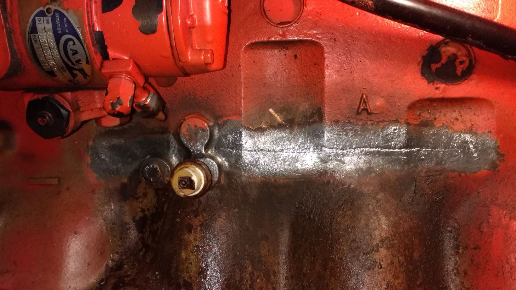

Bought a nice low hour original paint 175 diesel earlier this year that has a crack in the block. Previous owner had it 25 years and said the block cracked about 20 years ago. I didn't get a clear answer on why it cracked, it seems it is a frost crack, but don't know for sure. No water gets into the oil, previous owner put JB weld over block, but the JB weld has since cracked. Owner said he could run it for an 8 hour day and it would lose very little antifreeze. When I got it, I ran it for about 3 hours and it lost almost no antifreeze so that story seems to be true. However, I changed antifreeze with a heavy duty diesel antifreeze and ran it for about another 3 hours and it seems to have deteriorated the JB weld some more and started leaking more.
I could JB weld it back up and continue to run it, I don't really use it much, but would someday like to fix it right. Replacing the block would probably be the best option, but it runs fantastic the way it is right now. I've ruled out welding it. There is something call metal stitching, but that looks costly and time consuming too and I don't know if that would fix it 100%.
I'm curious about other people's opinions would be for fixing or not fixing the block.

I would clean it off and "lightly" peen with air punch and fill with liquid steel or Cat 2 part steel Epoxy  and continue running it. If you don't want to peen it you could still clean good and put the better epoxy's on it and continue running. We also had a small crack tig welded on block and it did well for many years.

It appears to be very close to a main engine oil galley, as evidenced by the oil pressure sender just below the crack, which leaks coolant.  I have plated a couple of tractor pulling blocks years ago, but they were flatter and not as contoured as this one is from front to rear.  As the engine works, that crack is trying to spread apart from the crankshaft pushing down and the cylinder head lifting up. If there was any way to get some good weld on it to keep it from spreading, then more epoxy/goop would last longer because the crack would stay shut.

There is a liquid metal product called belzona that puts JB weld to shame. It's a two part product that you mix together prior to use. I would try it. Not a fix that I'd be proud of, but I bet it will work, and if it doesn't, you really aren't out that much. Darrel

I agree with the good Dr, a good welder can fix that. My local machine shop has a welder that is unbelievable. When he is done you can barely see the repair. And it will be permanent.

Thanks for the comments, that gives me some more to think about. I did just check out the block on Ebay.......that is brand new still with the crate. That sounds tempting, but it's probably newer than the one I have, not sure what may have changed over the years.
I wanted to stay away from welding, but if people have had good successes with it, then I'd still consider that too.
Or maybe with a higher quality epoxy, it can take some stress flexing if the crack wants to open up a little under heavy load.

I have welded several of the years with great success and is a much more permanent fix but as stated before, Belzona is a very good product and we have built up worn shafts, blocks and axels. It is tough as metal and machines very well. In the same token, a good spare block laying around for 500 may be a good deal if you plan on keeping the tractor. It does look like a good one.

What I would do is to have someone who has a magnaflux machine, and knows how to use it, use it to find the ends of the crack.  Then talk with a good welder, he will be able to advise you better.  Important thing is to stop the crack from spreading further.  Once your welder advises you on what to do, take his advice...
If it were a shorter crack, I would recommend an epoxy or belzona type epoxy, but that one is damn long...  Also after welding, an antifreeze sealant containing sodium silicate, like Blue Devil block sealant, would be a good investment...
I once had a JD 420I, that had a crack, about 3" long, from a rod hit, it was a vertical one, heafing up toward the water jacket.  Found the ends with magnaflux kit, then drilled a hole, at each end, and threaded in a 3/8" fine threaded bolt, + 1 in the middle, then veed out the crack, and JB welded it shut.  This was an oil only crack, snd that ole buvket of bolts lasted another 10 years, before I traded it off...Wink
