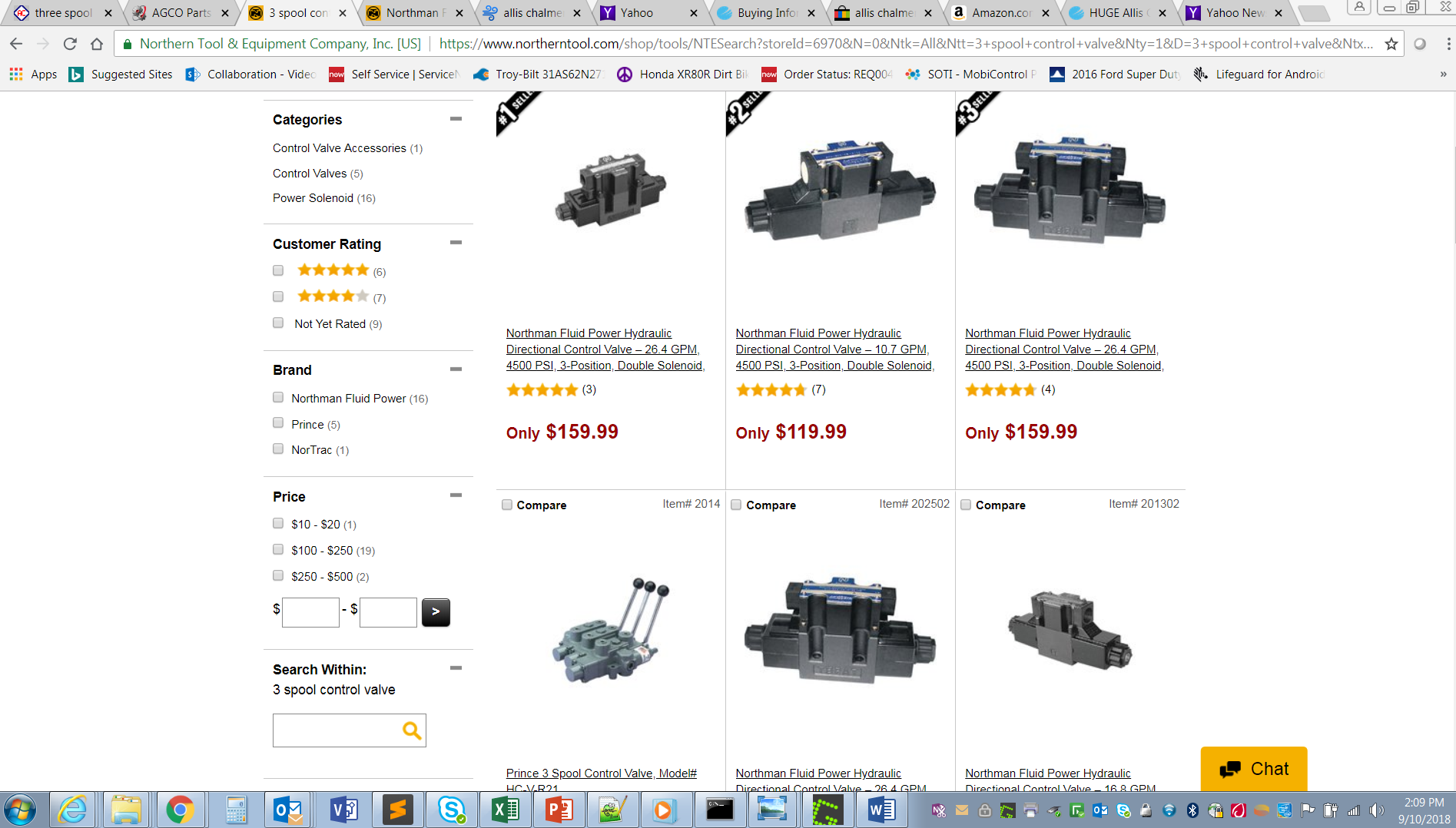

would one these suit for a replacement ?
from northen tool

Those valves would take a lot of plumbing to make work.

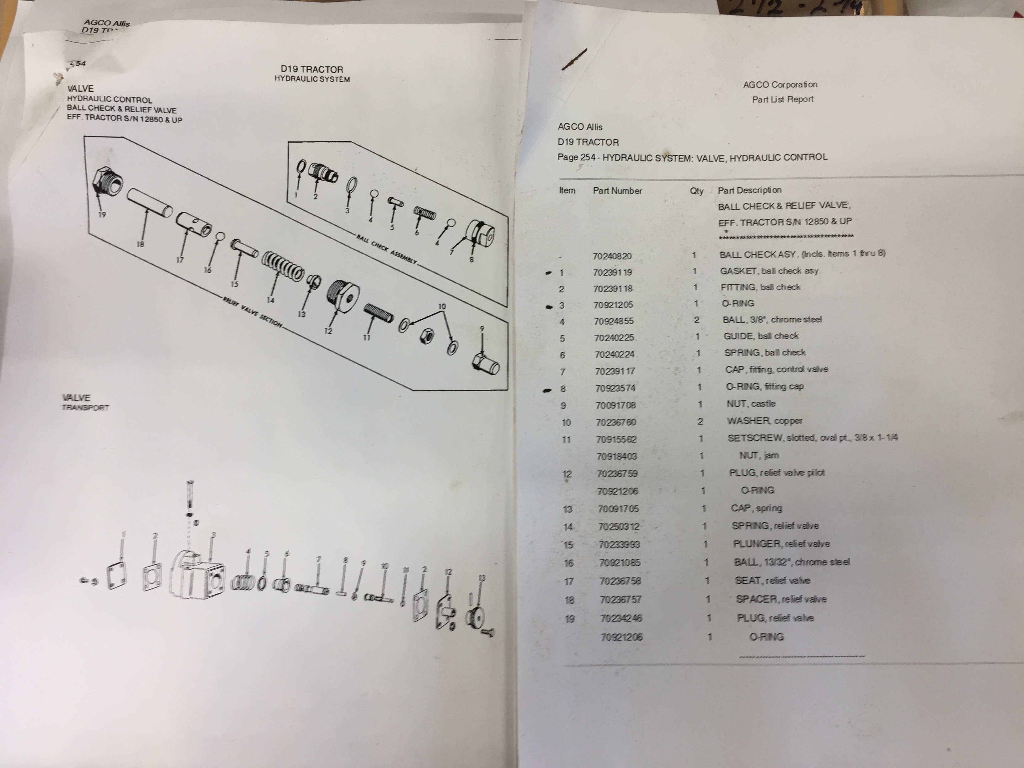

It is the two way check valve. Remove top section from bottom section. There will be a valve stuck out of bottom of top section. Unscrew valve, a second part may stay in, unscrew it. Replace copper ring. Tighten valve with big screw driver, drop ball back in. With a soft punch and hammer, pound on ball then retighten several times until it s tight. Replace all orings and reassembly.     MACK

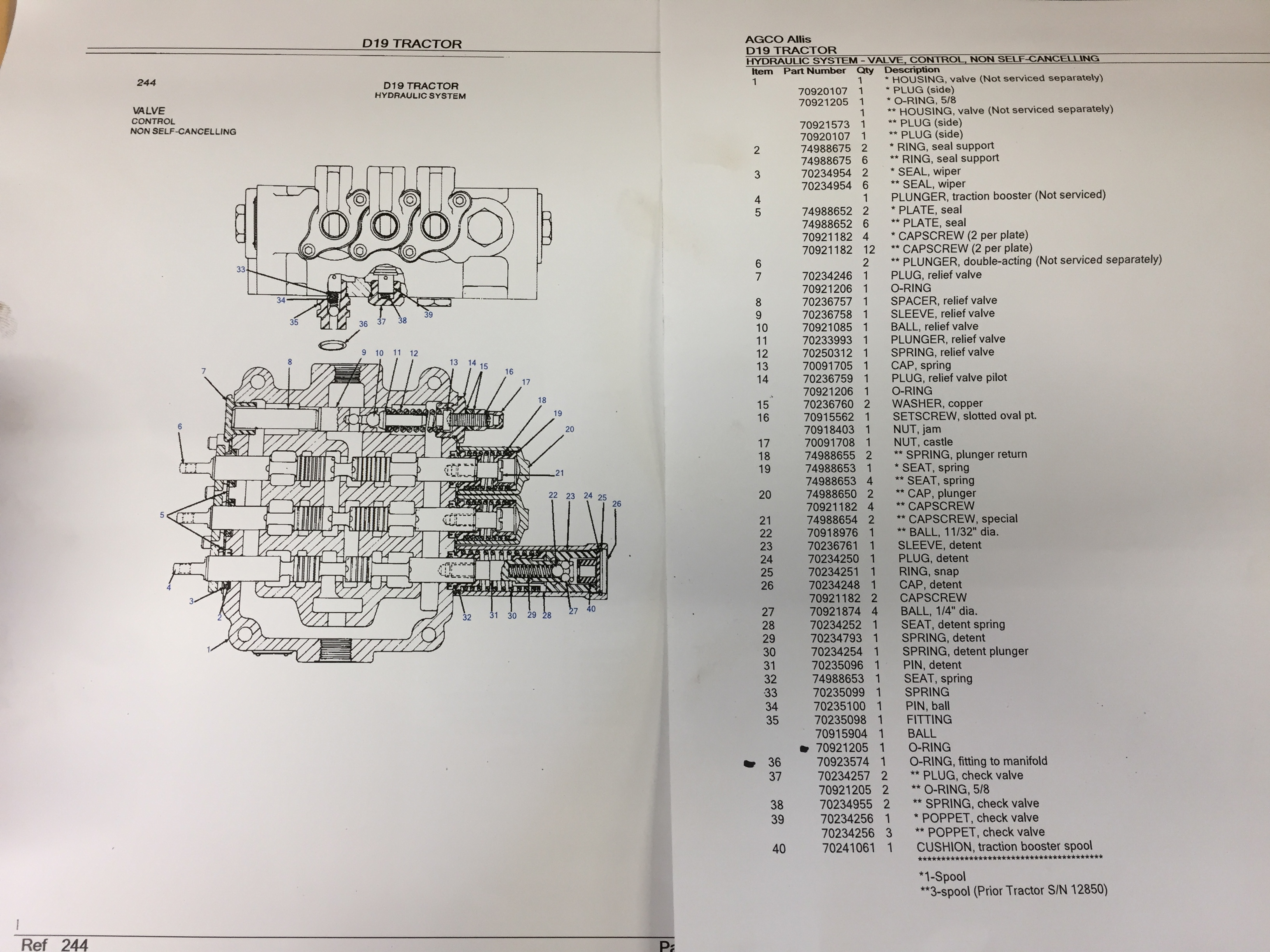

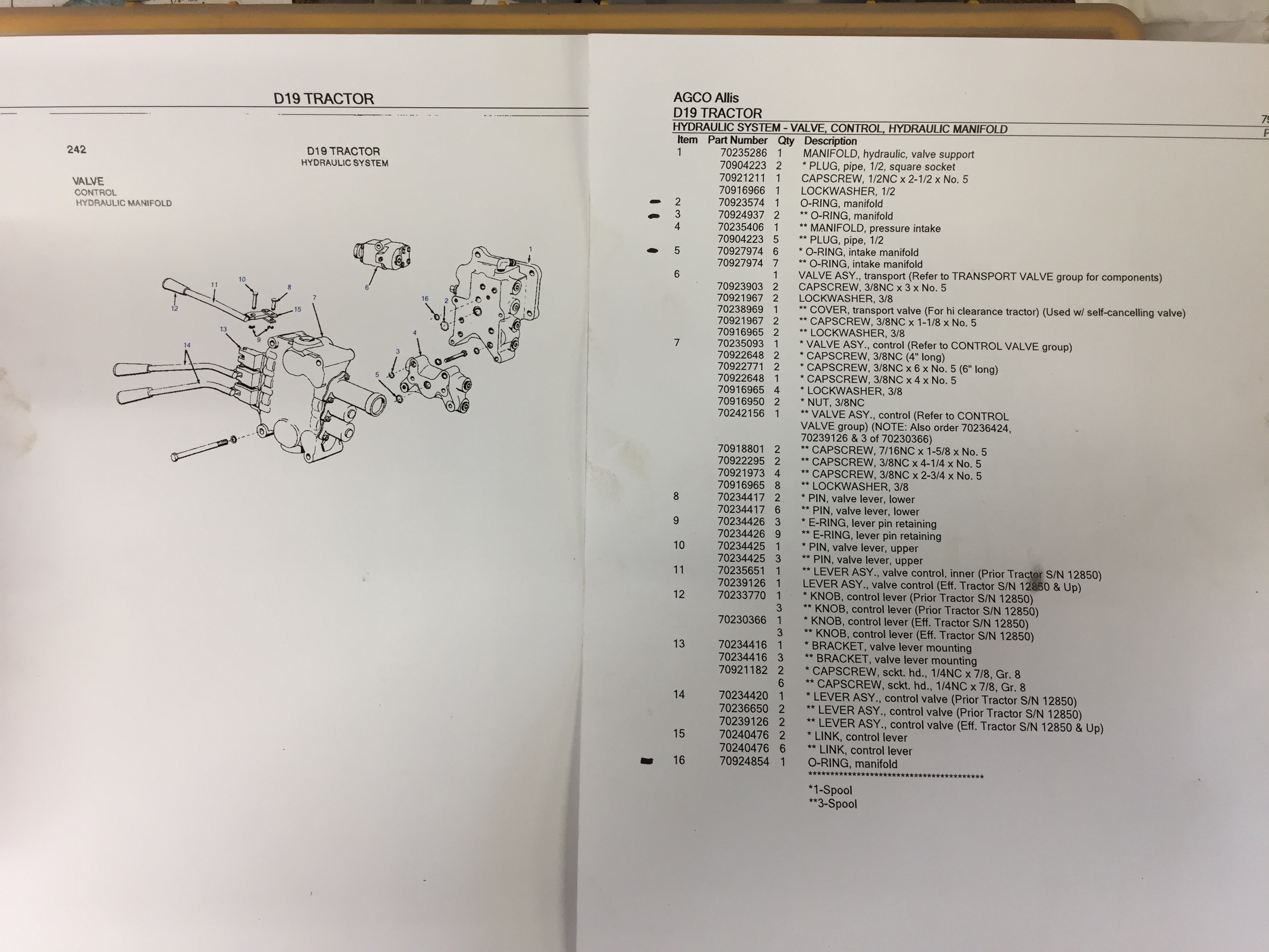

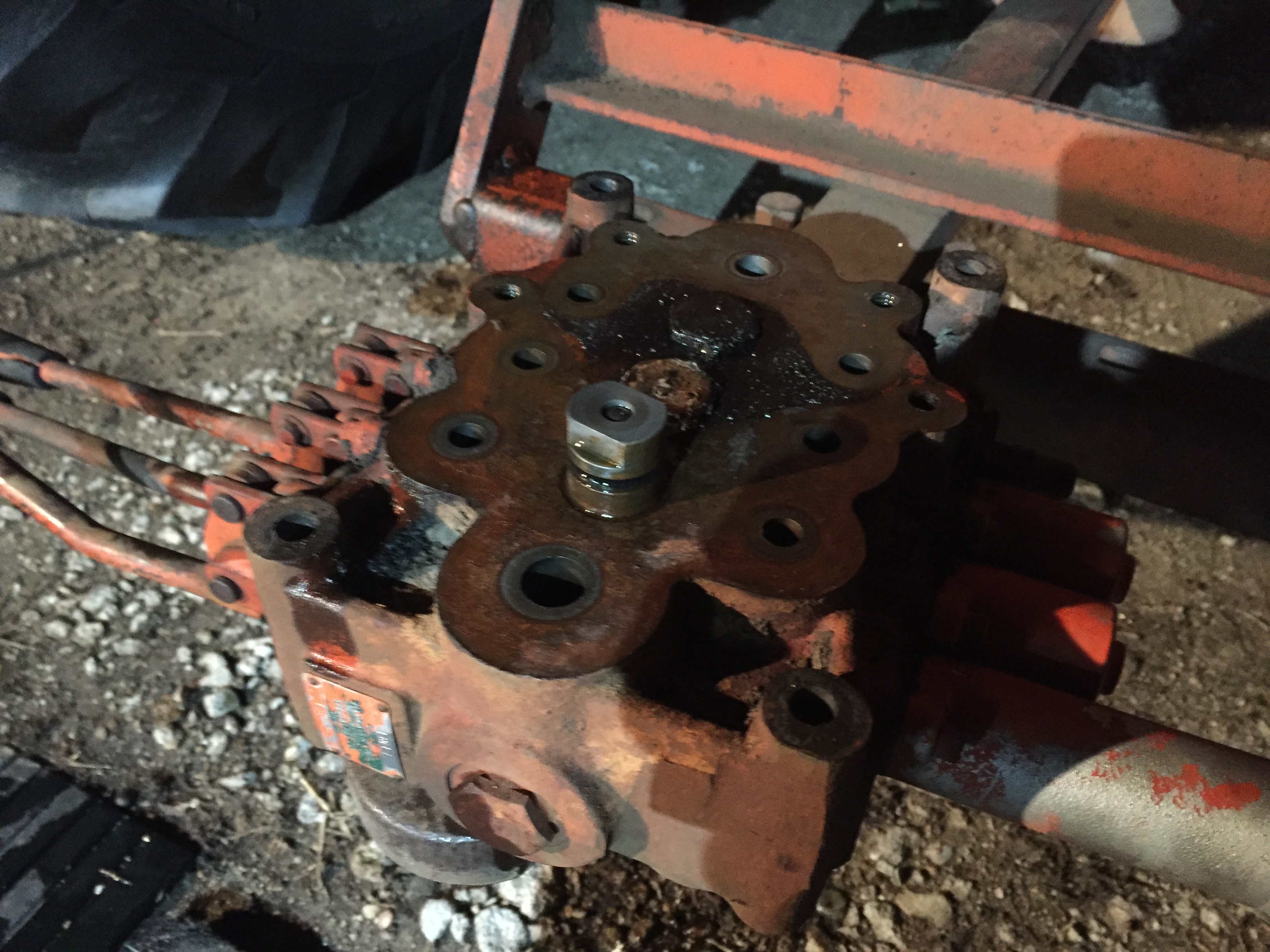

I order the parts from my local AGCO dealer, but I’m sure anyone with an O-ring assortment could match them. I had one apart last night and found the previous person in there cracked the check valve housing. Luckily I have a parts tractor and was able to change it out and now it will actually hold the lift arms with blade up. I’ll attempt to post some pictures. The parts with a dash next to them are what you will need.

Post Options Post Options   Thanks (0) Thanks(0)   Quote Travis(NE) Quote  Post ReplyReply Direct Link To This Post Posted: 11 Sep 2018 at 11:44pm
Haven’t figured out how to resize pictures yet... If I have time I will attempt to fix another one of mine that settles tomorrow and can take more pictures if you like...
