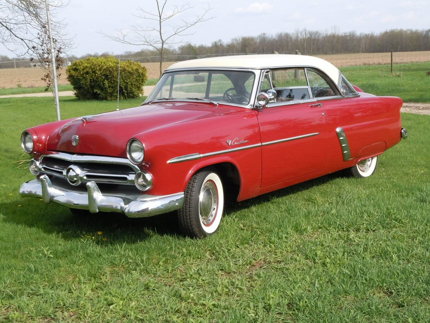

Post Options Post Options   Thanks (0) Thanks(0)   Quote Gordy Quote  Post ReplyReply Direct Link To This Post Posted: 08 Sep 2018 at 5:03pm
My 52 was looking kind of dull and that stuff brought it back nice.

Thanks guys! I may give Meguiar's a shot! That's a good looking Ford you got there, Gordy!
