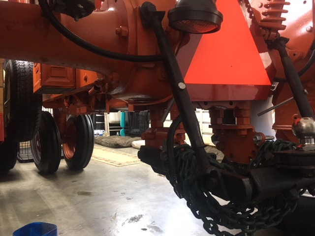

The factory cover was cut in a curve similar to the one in the pictures.  I agree though, it doesn't look quite right.  Cover was part number 70222529.

The cover for pump don't look like a factory cover would. Looks home made.      MACK

Hand clutch is not there, I'd bet money it's a solid coupling under the cover...
When I first read the opening post, puller was the first thought that came to my mind...now that I've seen pictures, pretty darn sure puller...

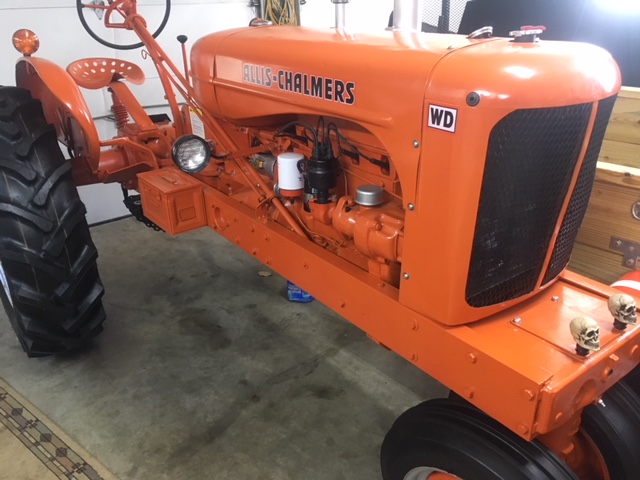

Yea looks like something I would do! Except for the skulls, Not into that!
Screams puller to me!

Im on the tractor puller band wagon as well.  Ive it were a standard tractor it would still have a regular drawbar.  I also noticed the shutters are also gone.

After further research by examining Pop's Price Book (1960) tractors could have been shipped from the factory as BASE TRACTORS.  That means that the basic tractor less the PTO, Hydraulics, Hand Clutch, and the spin out wheels could have been purchased.
Looking at the pictures this is one of those BASE tractors.  Why someone would want one is beyond me.

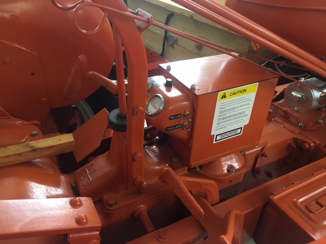

Without a doubt the drawbar is not original. He rewired the electrical harness to add a fuse (seen on top of the box) and add lights for the wagon he pulled neighborhood kids in at Holloween. The current owner did those switches on the side of the box unrelated to tractor pulling.
All that being said, it does all seem to point to a past puller that someone retired to suburban duty.

Couple other things that stick out is the location of the light switches. Also notice the spacers on the hitch. Stack of washers and oversize nuts. If that was factory, those would either be solid plates, or the brackets would have been made longer so no spacers would have been needed.

I agree about it being a puller. Using 3 pt top links for adjusting height of hitch, is a dead give away.

 Gary ,after looking at it a few more times ,I would say that it is nothing less then a puller . LOL
nonetheless ,still dead.

Just pure speculation but after comparing photos I could believe the wheels and rims are straight off the WC.

What I would find to be the real head scratcher is the steering column throttle bracket. Be it a purpose build industrial model or a standard farm tractor w/dealer deletes, why go to the bother of creating a separate part for either reason.
