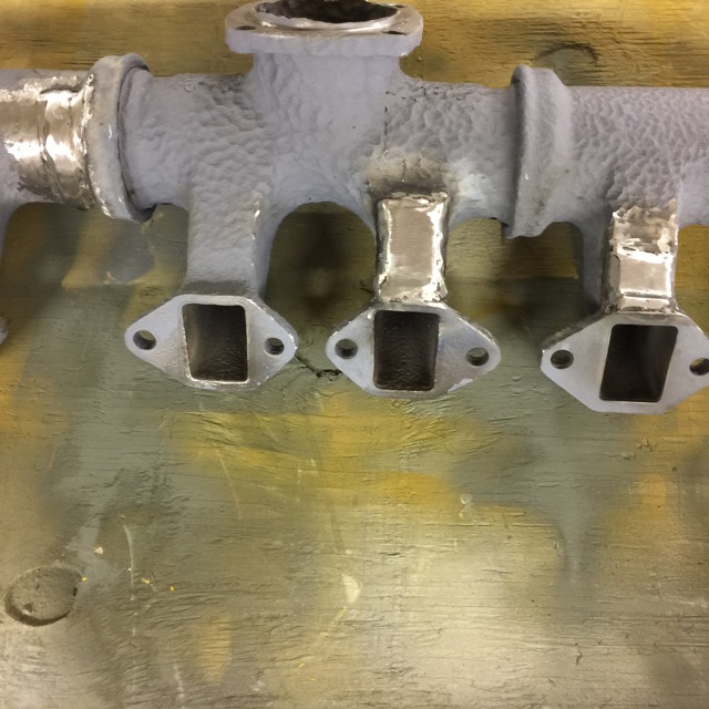

Hi guys, as exhaust manifolds age and are subjected to extreme heating cycles such as a gas engine produces, the cast iron does seem to erode into what I call ash metal,which can be tough to deal with, you can make brass look good and you can make nickle look good but as cast can turn a dull cherry red under load, that means it is reaching the melting point of both brass and nickle and eventually they will lift and separate from the base metal, the newer lean burn engines are the worst for this, in most cases brass and nickle won't stay for long. However, the older diesel engine manifolds seem to tolerate this better than most. One can not argue with someone who has had success doing things a certain way, everybody has their own way, I don't care to use an arc on manifolds, it is done with the square cast iron rods and put on with flame, that is what works for me, it gives a general heating and not a specific concentrated heat area. Sometimes when arc welding high carbon or cast the arc will make ferric carbide, that is an alloy that Rockwells about the equivalent to the hubs of Hades, now that is hard. In these pictures the base metal is actually melted, filler metal added to complete the repair and it can be done on ash metal as well.   Thanks Tad
Thank you Tad. Great pics and workmanship demonstrated. My HD16 exhaust manifold had 3 rust/age holes. 2 were the size of dimes and the 3rd was completely worn through and spanned the entire width of the one of the exhaust ports. I have a fabricating welding company that I have used and they were able to repair "PROVIDED THE CAST STILL HAD ENOUGH CARBON IN IT TO TAKE A WELD". I said HUH, and he explained that cast loses its carbon over years due to heating and cooling of the material. In my case, he was surprised how well it took a weld and was able to find good solid metal to weld on. Thanks for the great info.

Jerbob   I am not a big fan of arc welding on cast especially MIG, but what ever works is considered successful. Is it just me or the camera, does number 4 port look a bit not quite right? cast usually does not move much so I must assume that it is the picture. Have you put a straight edge across the ports or test fit it to the head? You will be making diesel smoke in no time. Tad

Thank you Tad..
Just the pic angle. Ports are square and flat. Cost me $100.00 but a replacement manifold was over 500.00 plus shipping and no guarantee of what your getting.
I should get a few more years out of it.
