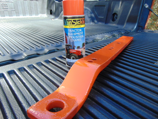

I know folks here are real passionate about their paint so please don't beat me up too bad.  Just thought I'd share a positive product review with you.
I ordered some paint for touch ups.  I ordered it through All States AG Parts.  Got the six cans for $29.90 + shipping.  I received my order, Van Sickle Super Premium Gloss AC Persian Orange #1  477 70.
Never used this product before and used it to touch up the drawbar on the WC.  Gave the bar a quick sanding, wiped it down, and applied the paint.  Went on good.  Easy to apply and covered well.  No runs or surprises.  Goes on a little dark but seems to lighten up a bit as it cured.  So I'm happy with it.  Big smile  If it looks like there is orange peal on the painted part, nope, that's just good old fashioned pitting.  Brad
