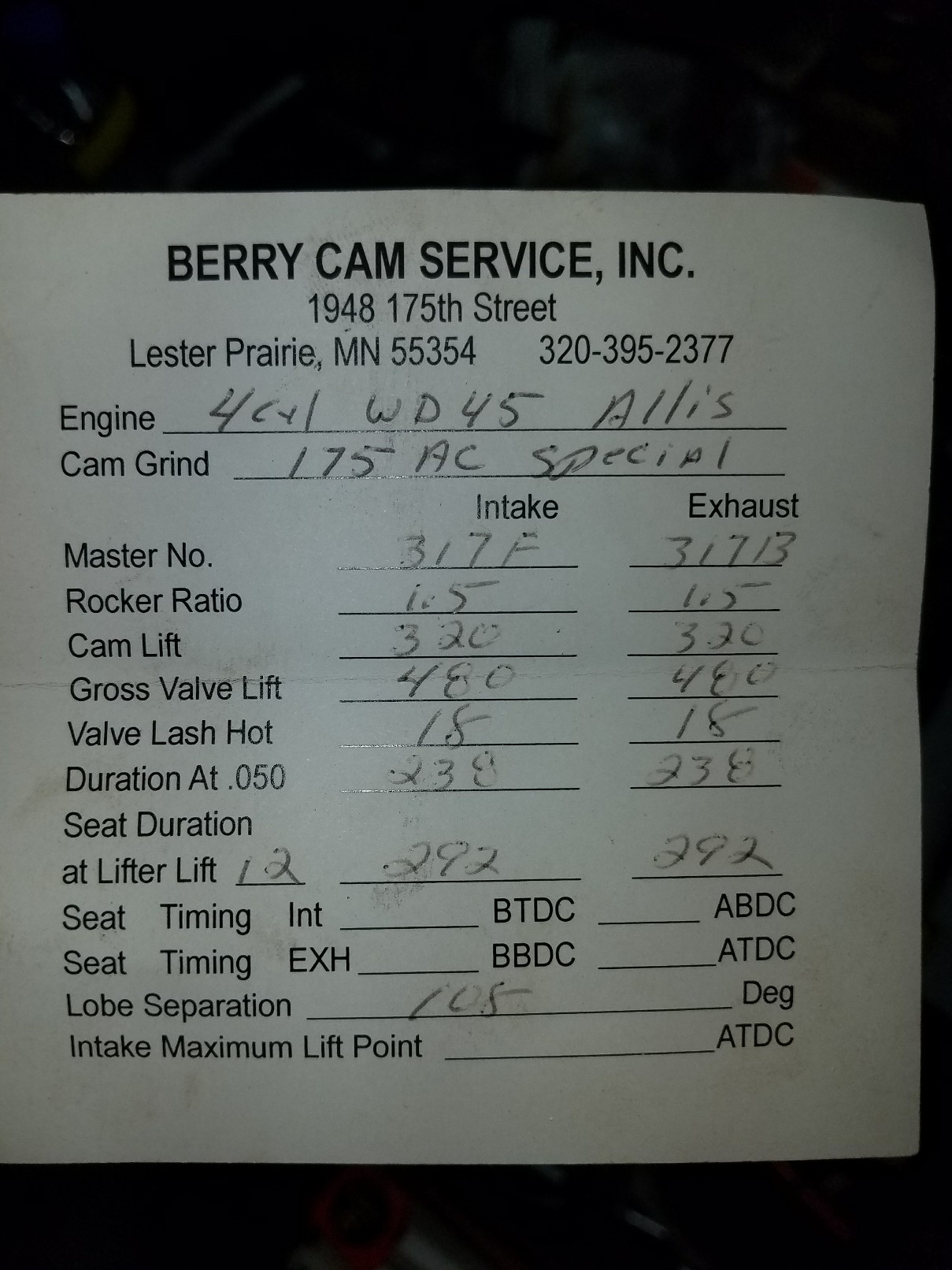

How do these specs look

How do these cam specs look, battling a lopey idle and wondering if its cam related

is it something you have been battling or recently installed cam and now have trouble.  could be a fuel ratio issue at idle with more lift?

Is the cam lift I320E370 ??

It's an A-C 175 gas grind. I sent Berry cam a new 175 camshaft some 25 plus years ago and they copied the cam lobe profile and have re-ground 100's of them to this spec.

A "175" cam grind will idle just as nice as a stock cam grind. No difference in idle quality unless you're 1 tooth off in gear mesh.

the cam card looks to me like an awfully long duration and high lift for being patterned after anything from the factory. 238* @ .050" is a lot of duration, and probably why it has no compression like Dr is trying to point out. Also, .480" valve lift? That is pretty huge llift numbers too. I'm betting this is the high rpm version they created from the 175 cam initially.

With 238* of duration @ .050 lift on a siamesed port 4 cylinder you have 3 valves open for a long time connecting 2 cylinders.  The engine will run like a sick air compressor.....In simple terms, it's not going to work.
FOr any of these siamesed port 4 cyl engines in a low speed application, meaning 2500 RPM and less with a typical torque band of say 1800 down to 1200 RPM you can use the following examples.  A typical camshaft duration for an engine like this at .050" is going to be 176* for most of the stock camshafts.  A pulling camshaft for a smaller displacement engine is going to be in the 195* area, a mid sized engine or a larger displacement engine running with a little speed would be in the 215* range.   A very large engine or one that is going to run very fast will be in the 224* area, any more than that and there's simply to much overlap.
People like to throw the term "175 grind" around because every beginning engine guru is a camshaft expert.  I've had people bring me camshafts to install because they had it ground to this magic spec and the card read like the one you posted a picture of.  It's scrap metal.  I know it's not what you want to hear, I'm sorry but stay away from Berry cam service.
"see what happens when you have no practical experience doing something...... you end up playing with calculators and looking stupid on the internet"

The only 175 gas camshaft specs in the A-C service manual are the following: Cam lift at cam lobe .312" to .318"........rocker arm ratio of 1.488 to 1........  Intake valve lift .461" @ .012" valve lash.......Exhaust valve lift .458" @ .012" valve lash.....intake is open 220 degrees of rotation (2 degrees BTDC to 48 degrees ABDC)....exhaust is open 230 degrees ( 37 degrees BBDC to 12 degrees ATDC)

By the service manual specs if the tractor model 175 intake duration is 220* at .012 lift that would equal about (not exactly) 185* at .050. The exhaust duration per the AC service manual is 230* at .012 lift which would equal about (not exactly) 195* at .050. The lobe separation angle would be another important number which could be calculated by the numbers given.
Your 240*  @ .050 lift cam sounds way big.
