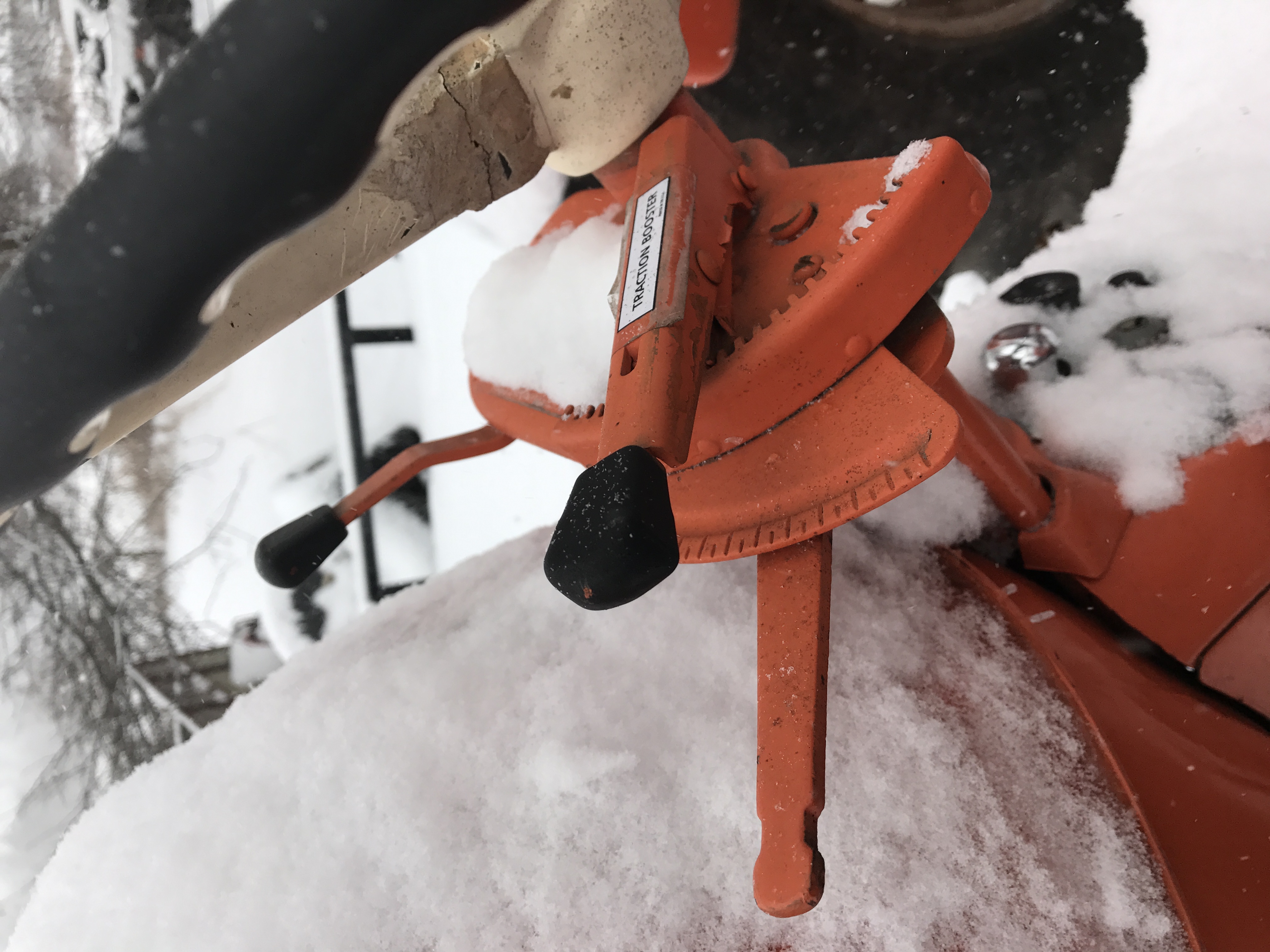

Is this the lever your talking about. The levers themselves are on the left side. The remotes are open. The only lever used is the far right lever.

Originally posted by orange-is-power orange-is-power wrote:
D19 lift levers are on the left fender. One closest to seat is the lift arms. Other two are remote levers. Yours may not have the position control lever on the dash. They were on the later D19s.
hmmmm, mine is a '61 I believe (maybe '62) and it has it. There is another anomaly, it has a number on the torque tube where a D17 would have a serial number. Every other D19 I've ever looked at has no number there. The serial number is actually on top of the rear end housing.

I ordered a manual for it. Should be here in a couple days.   But is that the control lever you all were talking about behind the traction boost. Would love to start using this thing to plow with, my quad did ok today but this thing would have cut my time down by over half. I know it's a little over kill for my acre lot, but when I build my new house on my 40 acres it would be nice to use this around there like my grandpa did when he was still here
Yes but my experience with my D19 is that it does better with a pull-type plow. But mine never worked right with the traction booster.
