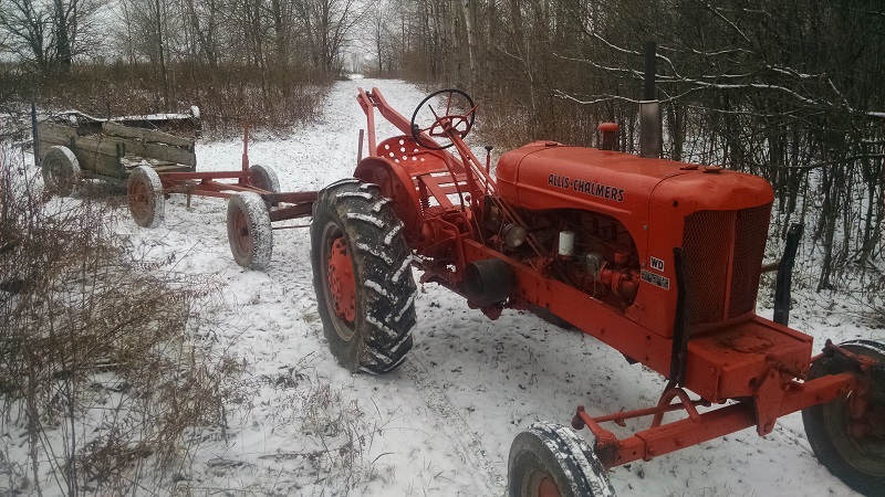

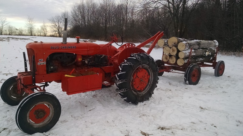

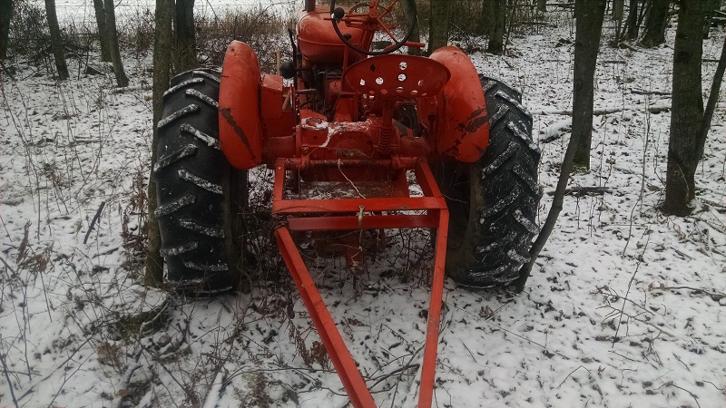

I built a farm crane for the WD a few years ago. One of the handiest attachments I have ever used. I looked it up in the WD attachment manual, the farm crane is rated to lift 1400 pounds. Surely it should handle any 8 foot popple log.

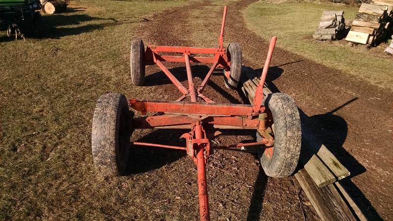

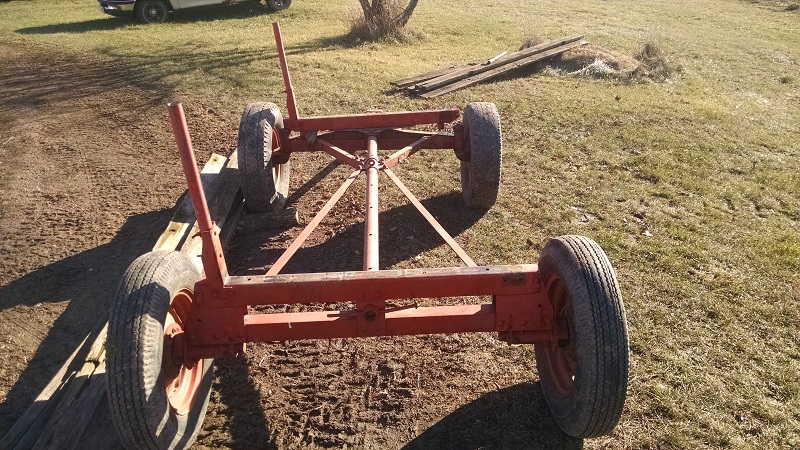

Got out the old firewood wagon. The floor and sides are made of 2X8's. As we filled it, three boards went up on each side. Made for a pretty good load. But, it will need some modifications for logging. Took all the boards off, and took the the pipes and brackets off one side.

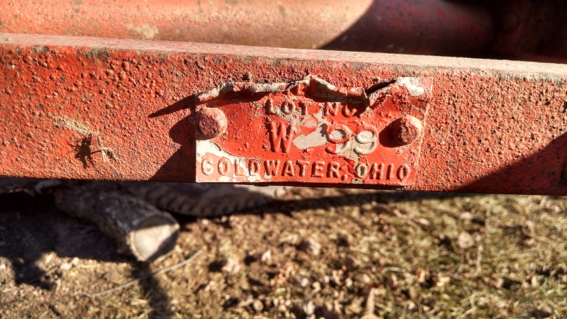

Still has the tag on it. I guess its called a "rocker wagon?" Because the front part actually pivots a small amount. Anyone have any ideas there?
The two cross beams are 7' apart. Perfect for hauling 8'6" logs.
We had two choices for making firewood. When we needed to get in a tight spot, we took the trailer. When we were in a more open area, we used the wagon, which hauls more. If I'm going to be driving up the road in the dead of winter out in the open, you can be darn sure I am going to get as much wood per load as possible, So, I fabricated a drawbar for the back of the wagon, so I can hitch the trailer on behind.

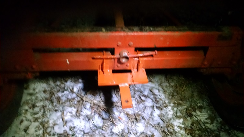

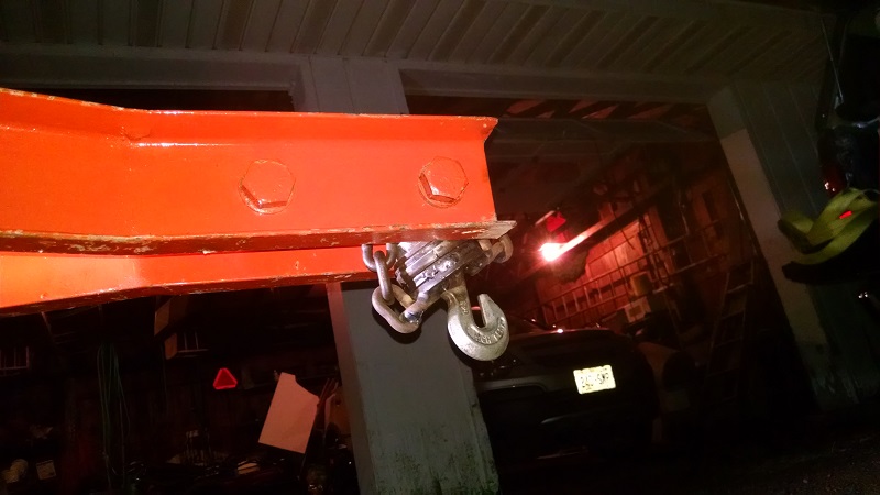

Built a swivel to put on the end of the crane. That way I can spin the logs to be in line with the tractor so we can get them out of the woods. Its made from a thrust bearing off a kingpin on a heavy truck steer axle.

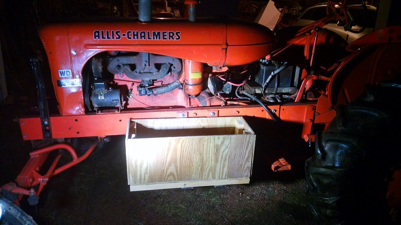

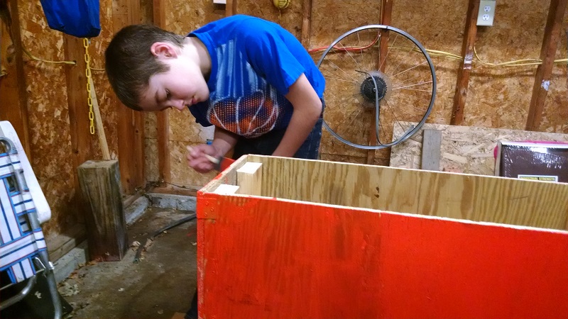

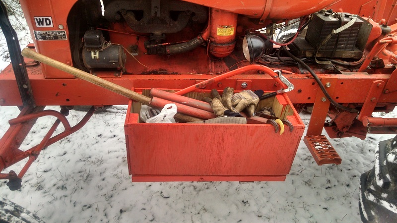

Made a toolbox for the side of the tractor. Lord knows you need accessories when you go out in the woods, so this will be a handy spot for the cant hook, straps, chains, etc.
You can see I also added some brackets for putting some weight up front, just in case.

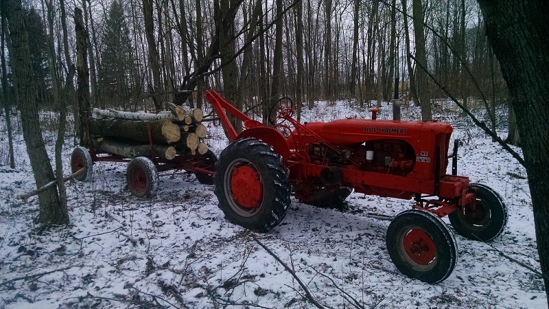

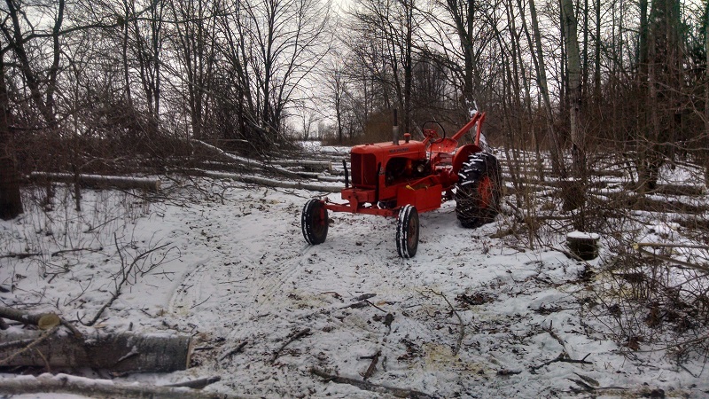

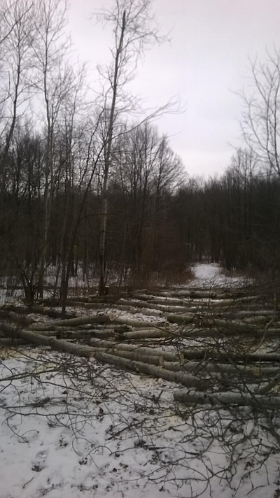

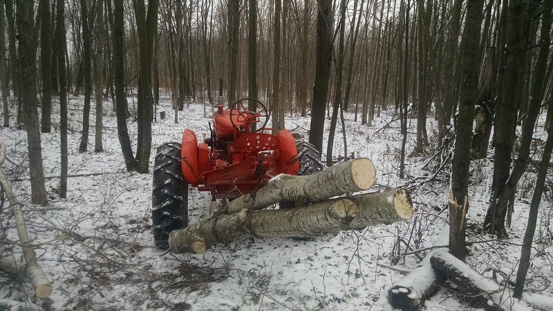

At any rate, big brother went up and dropped three trees, for kind of a trial run. Wound up with 21 sticks. So junior and I went up to check the situation over.
Also found a pretty sizeable rock. Guess we will be going around this one....
So here we are, outside,  on December 4th, at 9PM, in our t-shirts, painting. Sheesh.
And, in less than twelve hours, a 30 degree temp swing, and 30+ MPH winds. Plus a little snow.

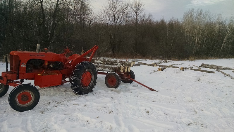

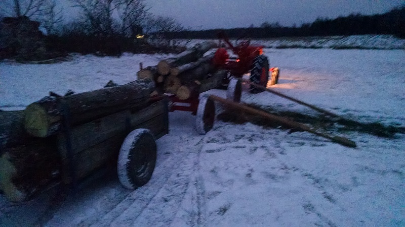

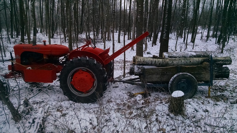

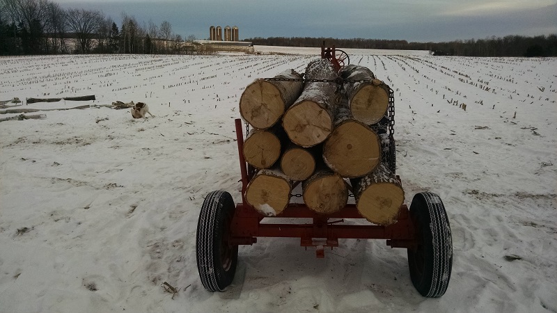

Hooked up my land train and headed out to the woods. Dropped the trailer at the clearing. I use a couple of jackstands to hold up the trailer to ease hooking it back up.
Toolbox? More like the "everything but the kitchen sink" box.

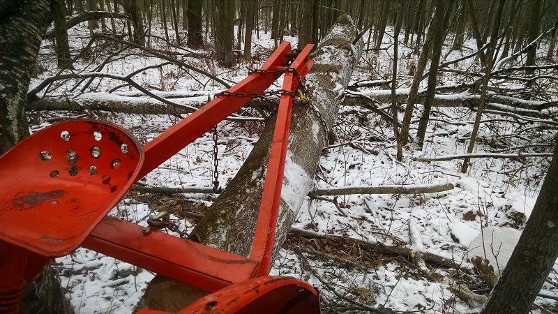

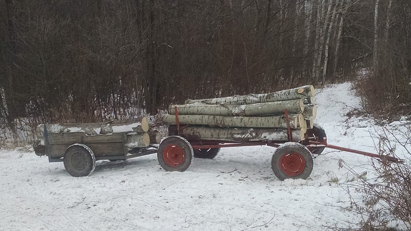

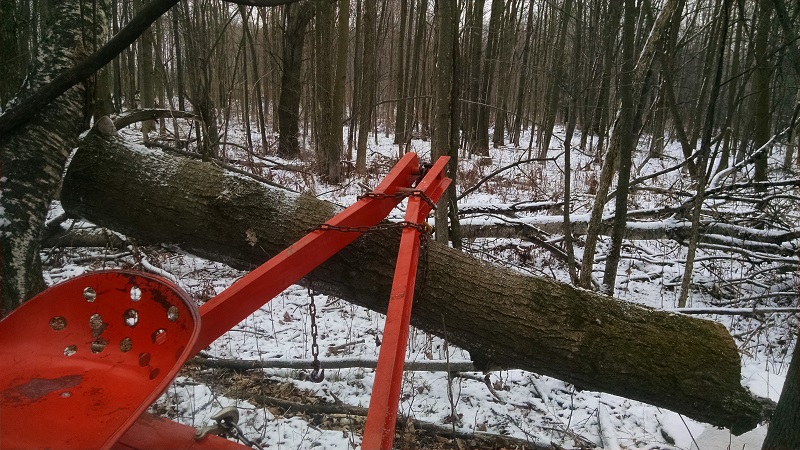

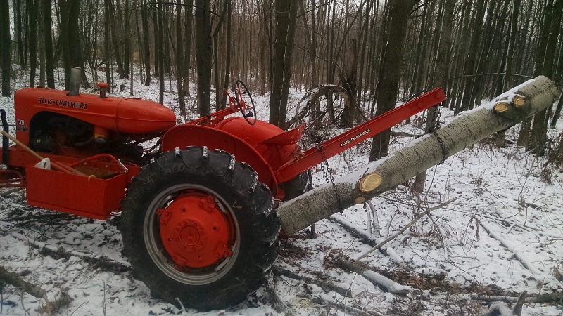

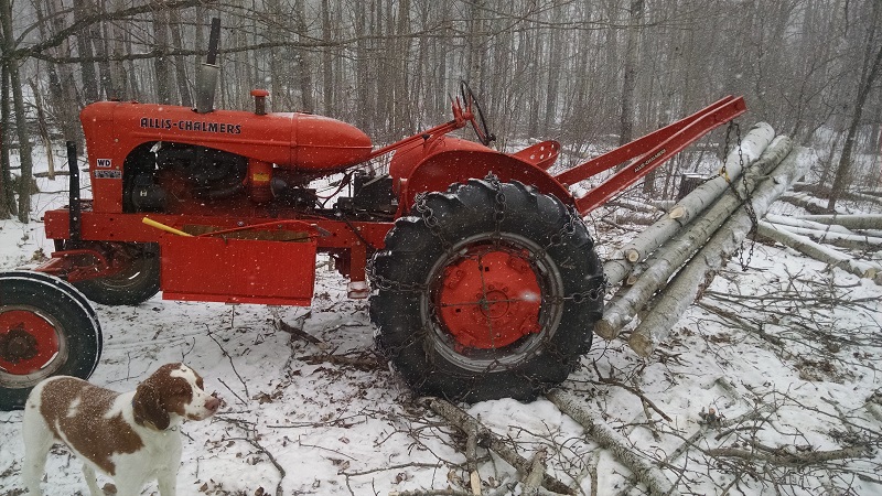

I cannot believe how well this works. Dropped the wagon in a spot where I can turn around and back up to it, and went to the first tree, probably 50 yards away.

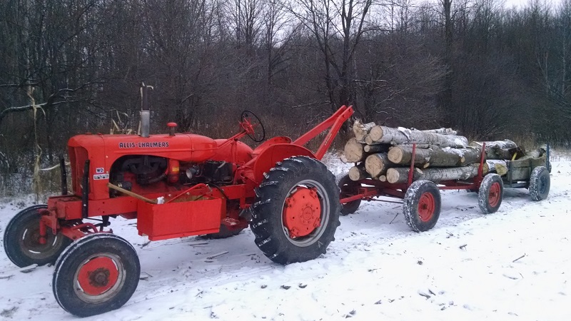

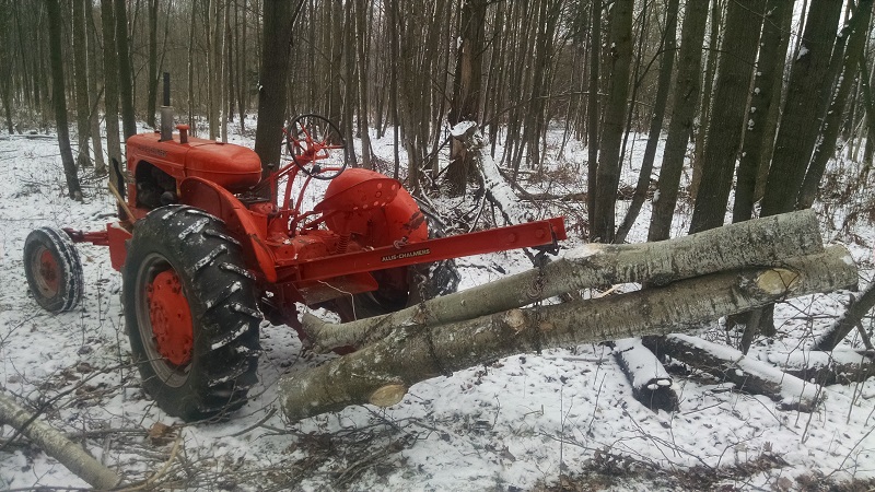

Backed up to two smaller logs, lift them up, then chain the front to hold them in place...
And deposit them neatly on the wagon.
Repeat. Sure works slick.
You can pick a log up from any angle,
And swing it right into position.

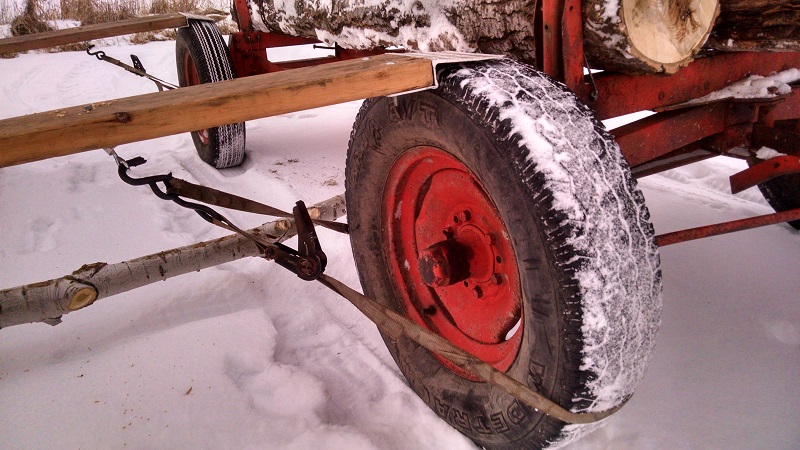

When you get to the wagon, spin it back and set it down.  Pin the pipes back on, and make a pretty nice load.

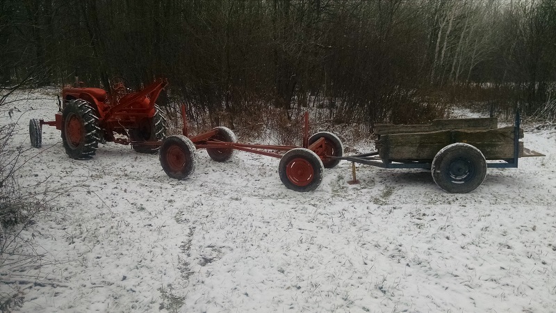

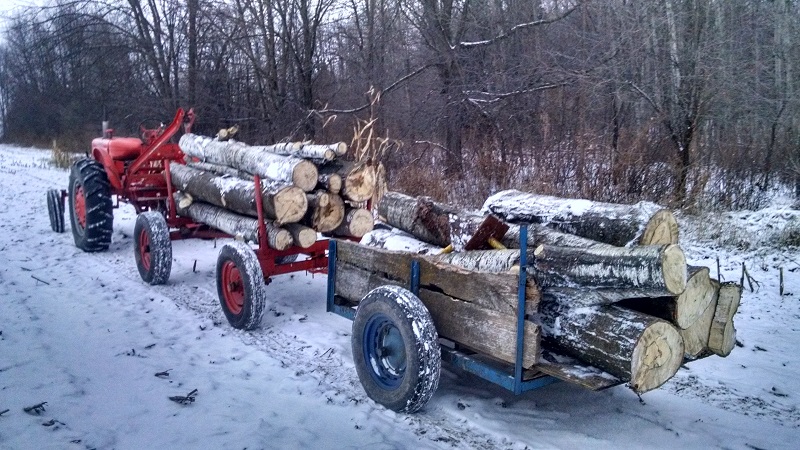

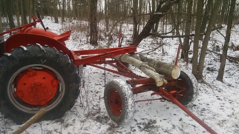

Next comes the trailer. Its a little handier, cause you can take it closer to the logs.

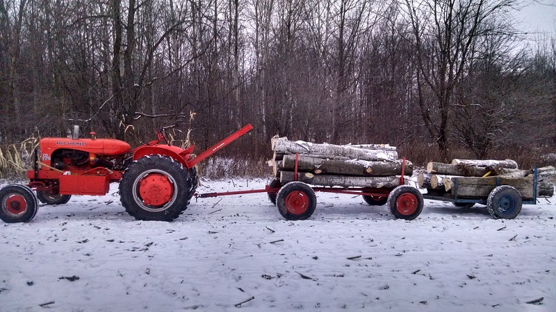

I often wondered why Pa always used the B and never got a bigger tractor. The B is 5' wide. The WD is 6'. Boy, what a difference one foot makes in the woods. Snuck her through some pretty tight spots, that for sure.
So, out to the clearing, to hook this wagon train back up.

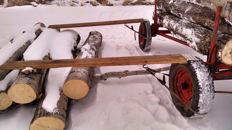

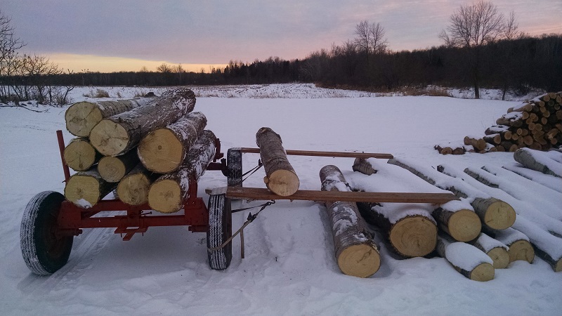

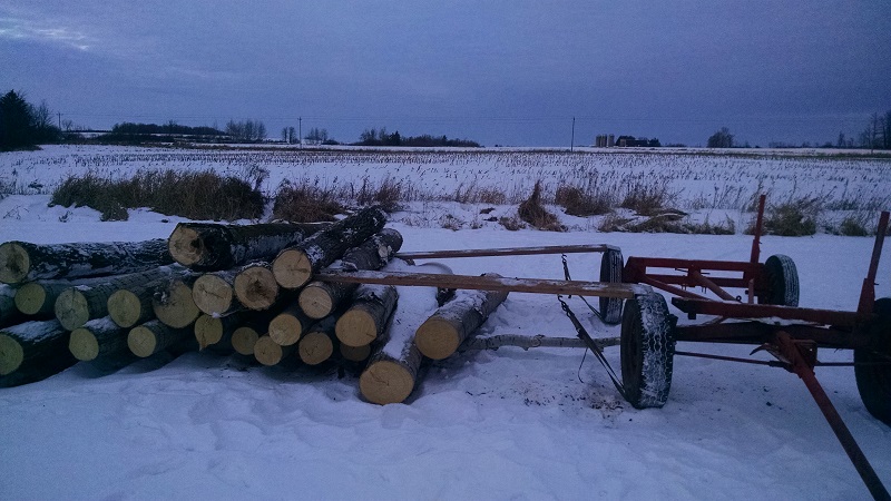

The unloading process needs a little refinement. I thought we could use some ramps to gently roll the logs onto the pile.
Yeah right. The ramps kept slipping out and the logs just fell on the ground. The end result is the same, I guess. To unload the trailer, I just backed it up to the pile and pulled them off by hand with a chain. Won't be doing that again, Pa has a swell Gator for just such an activity.
The most dangerous part? Climbing on and off that slippery tractor 97 times.
The hardest part? Backing the damn wagon up to the trailer to hook it back up.

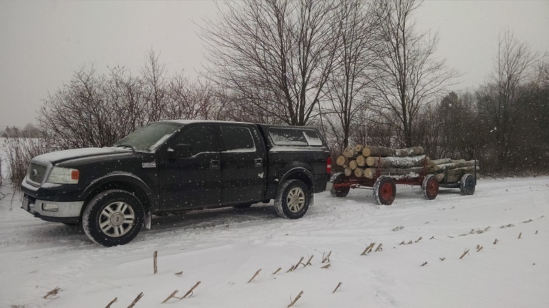

The coldest part? The 1/2 mile run up the road across the open. May think about using the truck to haul the loads home.
So, there you have it. I told the saw man to crack the throttle on the saw and start laying some trees down, we will give er hell until it gets too cold or the snow gets too deep, whichever comes first.  Going to wait to put the chains on until its absolutely necessary. We will be learning and improving our strategies as we go, but it sure looks doable. Big brother loves to work with the chainsaw, I love to work with the tractor, and Pa loves to stay in the house and watch football and cook us supper, so its a win all around!

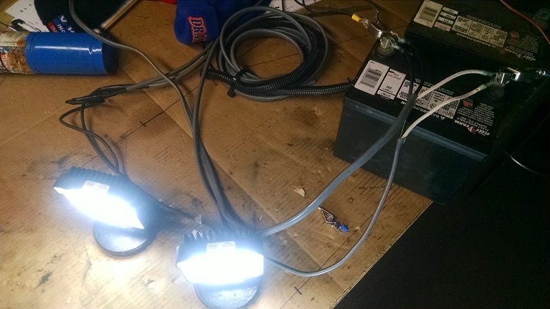

Due to the shortage of usable daylight, I broke down and bought a pair of 4" square LED lights. Hooked them up to a garden tractor battery and used them for a few hours the other night, should be good to go there.  The battery just happens to just fit in the toolbox. I don't have the time to convert the WD to 12 volt right now.

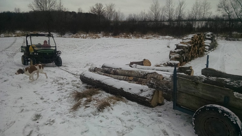

I went up to the end of the woods and fished out a trailer load of sticks. Uncle Eric showed up, and he and Carter got to work on laying down the next batch. With Carter running one end of the tape measure and clearing brush, they can really lay down the lumber!
Goes pretty fast when you are on the edge of the woods and drop them into the open. I have to give big brother credit, he is excellent with the saw. I will stick to tractoring.
Got the trailer load home. Carter jumped on the Gator, and we were unloaded in like 10 minutes.
They slide right off onto the pile pretty slick. We will have to improvise once the pile gets higher.

Have a little vacation to use up by the end of the year, so took today off. Got four loads.
Grandpa Marvin even got in on the action and helped me unload.

Well, the logging operation got suspended due to Christmas, New Years, and extreme cold.
Today I managed to get a couple hours to myself, and it warmed up to like 8 degrees! Time to get back to work. We had dropped a bunch and skidded them out to the field before Christmas break.  I threw the battery charger on the WD when I got up to dads, and took the Gator up to check them out. Swept all the snow off them, knocked them loose with a sledgehammer.
The WD fired right up in the cold, but snubbed off when I let the clutch out. Fired it back up, held the clutch down for a minute, and let the clutch out real slow, must have been the hydraulic pump that was dragging it down. Worked the lift arms a few cycles, everything works O.K. Wasn't sure if it would, its been below zero for the last two weeks.
Just took the wagon up today, it was late afternoon by the time I got up there.
Pretty easy to get a nice load when you are working with the big end of the tree!
I have been struggling with unloading the wagon and the trailer. When we originally started this project, we were going to make the pile in an open field near the road, where we would have plenty of room to turn around, and get at both sides of the pile. Then Pa piped up and said the pile had to go behind the old barn foundation, next to the trail, near his firewood pile.  I screeched a little bit, but, his land, his rules, I guess.
SO, I have been:
pulling the logs off by hand (back breaking, finger smashing, sweaty process)
using the gator to pull them off (only works on one end of the pile)
Using the gator and a snatch block and cable to pull the logs off using the WD as an anchor (time consuming pain in the ass that didn't work that well and conveniently didn't get pictures of)
The very first load, I used ramps, but they kept falling off. I have been thinking on this unloading process for awhile, and decided to get back to basics. Simpler is better, remember.
Put some eye bolts in my ramps, and ratchet strapped them tight to the wheels.
I think I may be on to something here. I unloaded the wagon by myself with no sweating or swearing! Now this is progress!
Once the pile gets higher, I may actually have to roll or push the logs up the ramps, but they aren't the worst to work with.
So, the pile of bolts is on the left, and the pulpwood goes on the right. We shall see how the piles progress.
Even got to take in a beautiful late afternoon sky on a cold day.
Pondered the wonders of nature a minute, then walked in the nice warm house, where Grandpa Marvin had pork chops, potatoes, and corn ready and waiting.
A good afternoon indeed.

loved it all... except "Once the pile gets higher, I may actually have to roll or push the logs up the ramps."
even without the cold and slippery that sounds dangerous.
I vote for limiting the height to level and letting the pile spread horizontally.
or starting a second pile.
or whatever else you come up with that keeps gravity as your friend not your enemy.
looking forward to the next episode.

I vote putting a loader on the tractor with forks! great pics and story, keep it coming!
