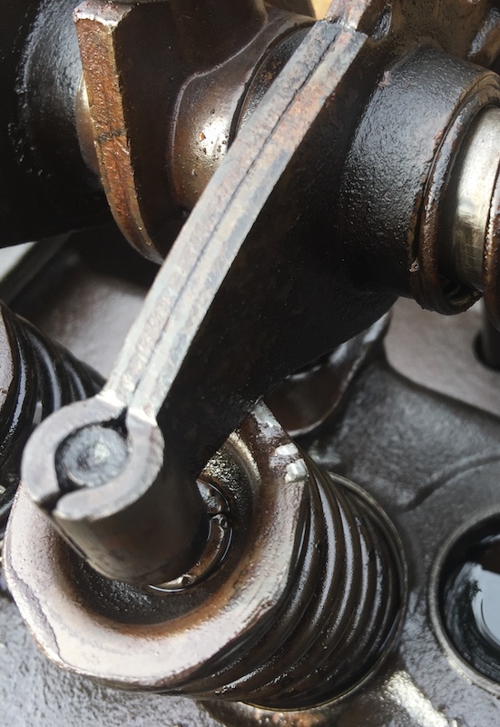

Pulled the valve cover on my B today and found this. I am not a mechanical genius but I know this is not good. At least 3 other tappets are impacting the valve spring top caps. My question is should I (can I) pull the rocker arm assembly and take my die grinder to the tappets without ruining them? It appears they need less than 1/16" to clear.

After talking to my father-in-law he mentioned getting the head rebuilt by a local auto shop. Apparently they recut the seats and ground the valves. This allowed the valve stems to ride higher than stock and now the spring caps and rockers touch. Luckily he only ran the tractor for about 100 hours before putting it in his barn and buying a tractor with a starter. Unless someone thinks it’s a bad idea my plan to grind away the rockers to regain clearance is on.

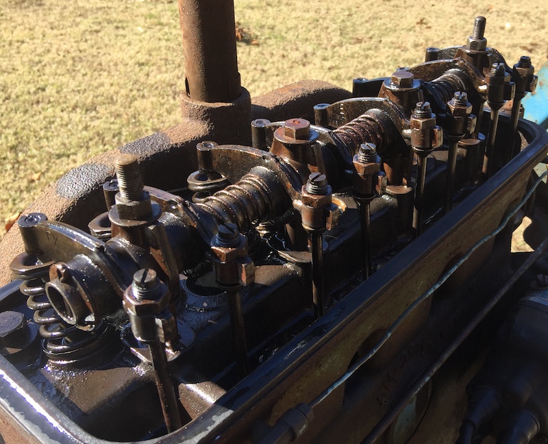

From your picture it looks like the valve adjusters are broken off. Can  you post a picture showing the full length of the valve train.
Below is a model B cylinder head.

I will get a picture of the adjusters tomorrow, but they are intact. Checked each one to make sure that wasn’t the issue. They seem to have the proper clearance too.
Picture would be good,
On some small engines valve adjustment is accomplished by removing material from the valve stem. But your B model cylinder head should have adjusters as shown in the picture I uploaded.

Maybe the valve stems wore in to the rocker arms so much they are starting to hit. The rocker arms are not centered over the valve stems for whatever reason. A picture would help here, I will look and see if I can find one.
I took a set of rocker arms in and had the radius's (radii?) reground, they come out as good as new.
If you take the rocker shaft off, loosen all four nuts evenly. The rocker shaft is hollow, and breaks easily, if it isn't broken already.

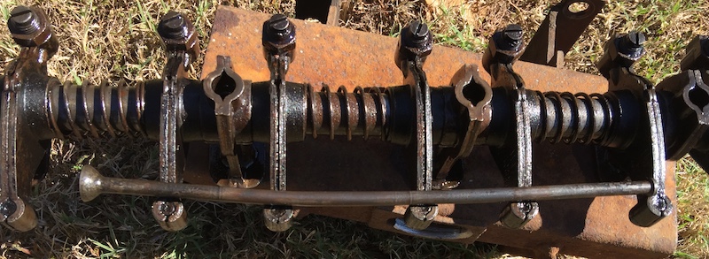

Here's what they look like after machining. I don't have a before picture, but you will see the wear if you take the rockers off.
Not sure if it pertains to what you are doing, but its food for thought.

Originally posted by rustydollar rustydollar wrote:
From your picture it looks like the valve adjusters are broken off. Can  you post a picture showing the full length of the valve train...
His pic is of the valve end, not the adjuster end...so no adjusters.
That explanation about the valves seat re-cutting makes sense. If the rockers and shaft are in good condition, I don't see why a little grinding wouldn't solve this. Also, the rockers on my B aren't perfectly centered over the valve stems and it runs fine.

They are all offset. I only mentioned it because if they had full rocker to stem contact, it would wear better.

Thanks for clearing that up, i don't think the shop should have removed material form the button which almost looks like it could be replaceable. Find an old Chevy stove bolt engine to rob the buttons from the rockers.
I've ground a few valve seats and resurfaced valves, if the valve head after grinding sunk into the head that deep the shop should have replaced the valves.
Next time that head goes to the shop for a regrind have them install stellite seats along with new valves and guides.
I've used the thin wall bronze guides, the kit comes with a drill reamer combo, a driver to install the guide and a knurling tool to seat the guide and a cut off tool to trim the top of the guide off. The optional kit had a cutter to size the outside diameter of the guide to accept teflon seals.
The thin wall bronze guides are easy to install, the kits is manufacture by K-Line. The kit would be a good club purchase.

My fix to this would be to shim under the four stands. When I mill .150 off a head I add that amount under the stands. The head in this picture does not have the shims. I could not find a close up picture of a shimmed stand. Checking the amount of adjustment you have will tell you if you can shim under the stands. Your picture is not an angle to see for sure but it does look like the valve stem above the keepers are short. Without knowing what was all done to the head it would really need measured to be sure.
You pads look good.

From what I can see the valve stem and rocker contact points are as they are supposed to be. The engine hasn’t run much since it had a complete rebuild. The plan is to get out this morning and get pictures of the entire rocker assembly from a couple angles, pull the thing and do some careful grinding with my Dremel. I am also going to drain the 30+ year old oil out. I had hoped to get the block warmed up, but a couple days dripping should get that tar-like goop out just as well. I have zero confidence that there is any lubrication left in that junk. I may refill the crankcase with diesel and spin the devil out of it and drain that too.
You pads look good.
Images removed
That is one sharp looking rocker assembly! Wow!!

I have a tool shop so made the shims out of flat stock and ground on the surface grinder. I am sure you can find flat washers the same thickness that could be slipped under the stands with out removing the total assembly. The shims would be faster and easier than grinding. Grinding would do it.
A lot of the stands I have removed were broken. Stands for the B thru CA are all the same height. I have stands from other make engines that look almost the same with the same shaft that are taller and shorter. That is another possible cause if there was a broken stand and all were replaced with slightly shorter ones. Sinking the valves that deep is hard for me seeing being done. Stranger things have been done though.

The washers or shims like Dick L said would be best route to go-with the arm hitting like that you can cause a keeper to come out , then the valve will be on top of piston. Not good. Leon

Not the space. I adjusted every complete head and rocker arm assembly by clamping the rocker in a vice and bending it to make full contact on the valve stem. It takes a little time to assemble and disassemble until you get them all centered over the valve stem. I never took a rocker assembly off that all the rocker arms was centered on the stems. It must not have been a concern when built new.

Sigh,
Well laddies and germs I dug into things, and what I found was not good. Aside from the issues with the rockers impacting the valve spring caps I found a bent push rod. The intake on number three has a distinct bend, and that alerts me to a stuck, or sticking, valve. I don't think my father-in-law would have put it back together like this. I am amazed it ran at all. Maybe I can straighten it out with gentle vice clamping. I wish it hadn't ever started! Read on.
On top of the bent push rod bad news I drained the old oil and was shocked to find that clear water ran out for 5 or 6 seconds before the tar-like glop that passed for oil came out. There was well over a quart of water in the crankcase. There hasn't been any coolant fluid of any kind in it for many many years as a bad water pump prohibited that. I think this was years and years of condensation adding up. I feel like such an idiot for even attempting to make it run with that in the crankcase. I should have drained the old oil and WATER before even attempting to get it to start and run. I hope I have not scored the lower end, but knowing my luck I have.
I may be looking at a fresh rebuild now. I am amazed that the engine hasn't seized with that water in there. I have poured 1.5 gallons of diesel in it and cranked it over under I am wore out. I will let that sit in there for a couple days and drain it out and see what it looks like. I may put my small Weber Kettle BBQ under the oil pan and get the block nice and hot and give it another cranking session before draining the diesel. I am so disgusted with myself right now.
Below is a wide angle shot of the entire rocker assembly. A little crud but no obvious issues aside from the rockers banging into the valve spring caps and the bent push rod. I am not going to set in grinding on those rockers, and will look into shims to raise the rocker assembly. I may pull the oil pan and take a look at the lower end before going much further with anything. I know that is a serious chore, but I am determined to make this old B right again. I just hadn't planned on these sorts of issues, as I was under the impression that the engine was tight.

Looking at your adjustors I am sure you need to shim the stands. The adjusters are all the way up. When everything is in spec they should be about half way on the threads. A compression check will tell you if you have a valve sticking open and with the assembly off you can push down on each valve to see if they are sticking closed. Did you by any chance check the gap between the rocker arm pad and the valve stem? You can straighten push rods. Roll it on a flat board and tap the high side until you do not have a gap in the center when rolling it.
Dick L View Drop Down
Location: Edon Ohio
Points: 5093
Post Options Post Options   Thanks (1) Thanks(1)   Quote Dick L Quote  Post ReplyReply Direct Link To This Post Posted: 22 Nov 2017 at 1:55pm
If you look at a rocker arm you will notice that the pad is farther from the center of the shaft that from the adjuster to the center of the shaft. When the adjusters are that far up and the valve not being pushed open the distance the valve can be pushed down is less as the cam lobe comes up. This can effect the high rpm under load. Not sure it makes a difference in your case if your not going for a hot rod.

theropod----- your on the right track. Several problems you have found, but nothing to be overly concerned with. LIke many here, I have  had motors that looked 10 x worse and brought them back to life. If it cranks over nice, and has good compression....... I would fill the water side and see if you have any leaks around the liners... and look at the freeze plugs in the head , under that rocker arm.   Fix the top end, flush good, and maybe you wont need much else.. If it holds water, and gets new oil, and has compression, you may be back in business !!
forgot about your stuck valve... put penetrant on the stem and tap on the top with a small hammer. It should BOUNCE up and down, not stick....... maybe it has been that way for years, maybe it got small corrosion on it and bent the pushrod when you first cranked it ?  I have seen stems loosen up by tapping and spraying penetrant on them.
